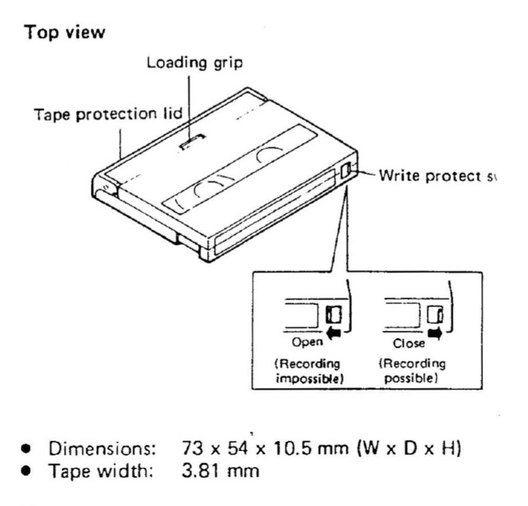

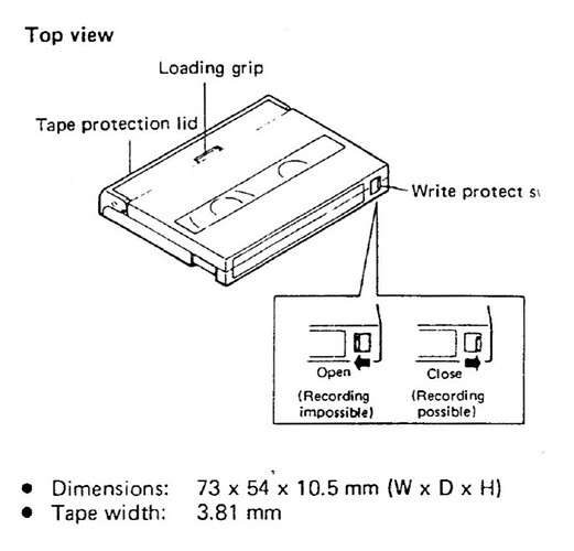

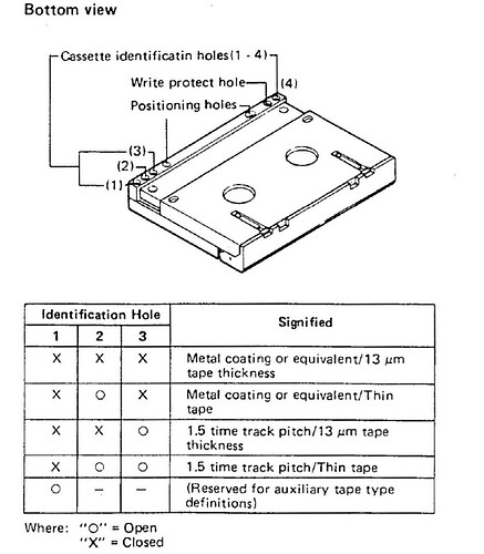

I read all discussion… I think that it is not possible to use a DAT tape in a DCC cassette because the tape type in DAT is Metal instead of Chrome. I don’t think that the physical width of the tape is different; I have some DAT recorders and in all of their manuals the tape width is indicate as “3.81mm width”.
Welcome. That would totally explain why recording would not work in @Jorn experiment.
Thanks and welcome.
New insides helps. ![]()
I didn’t know that, and that would certainly explain it. I’m not a tape expert but I’m pretty sure Metal tape needs much more energy to magnetize it.
Yes, if you record op a analog tape, you need put the level and bias higher with a metal tape.
Yes, it is so. The Metal tape is almost twice “more strong” than Chrome Tape (the coercivity is almost 3800 Oe than the 1600-1800 Oe of the best Chrome tape), and in the analog world it requires a bias current much stronger than other tapes. In the digital world, Metal tape insures faster transfer speeds. That is the reason because it is used on DAT cassettes in which the relative transfer rates are of a few megabits/sec.
