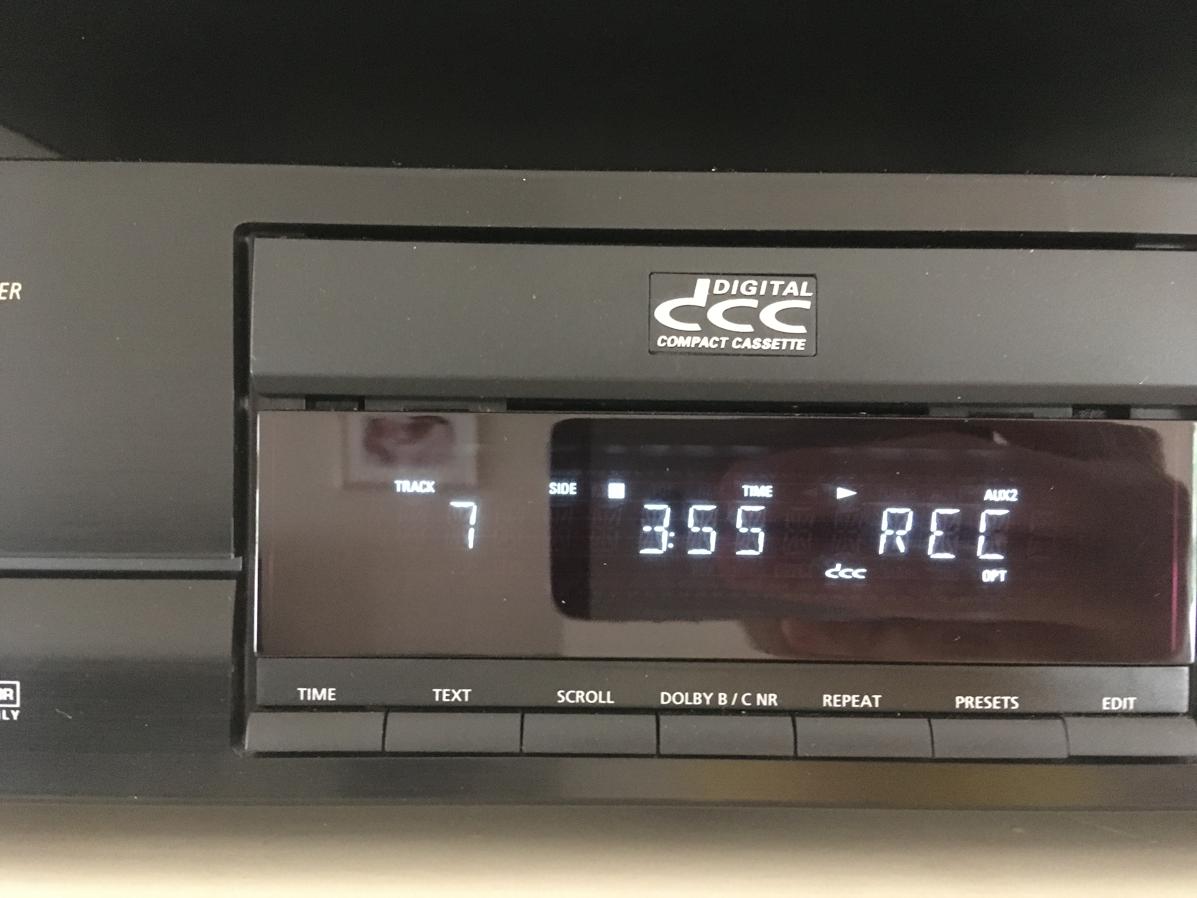

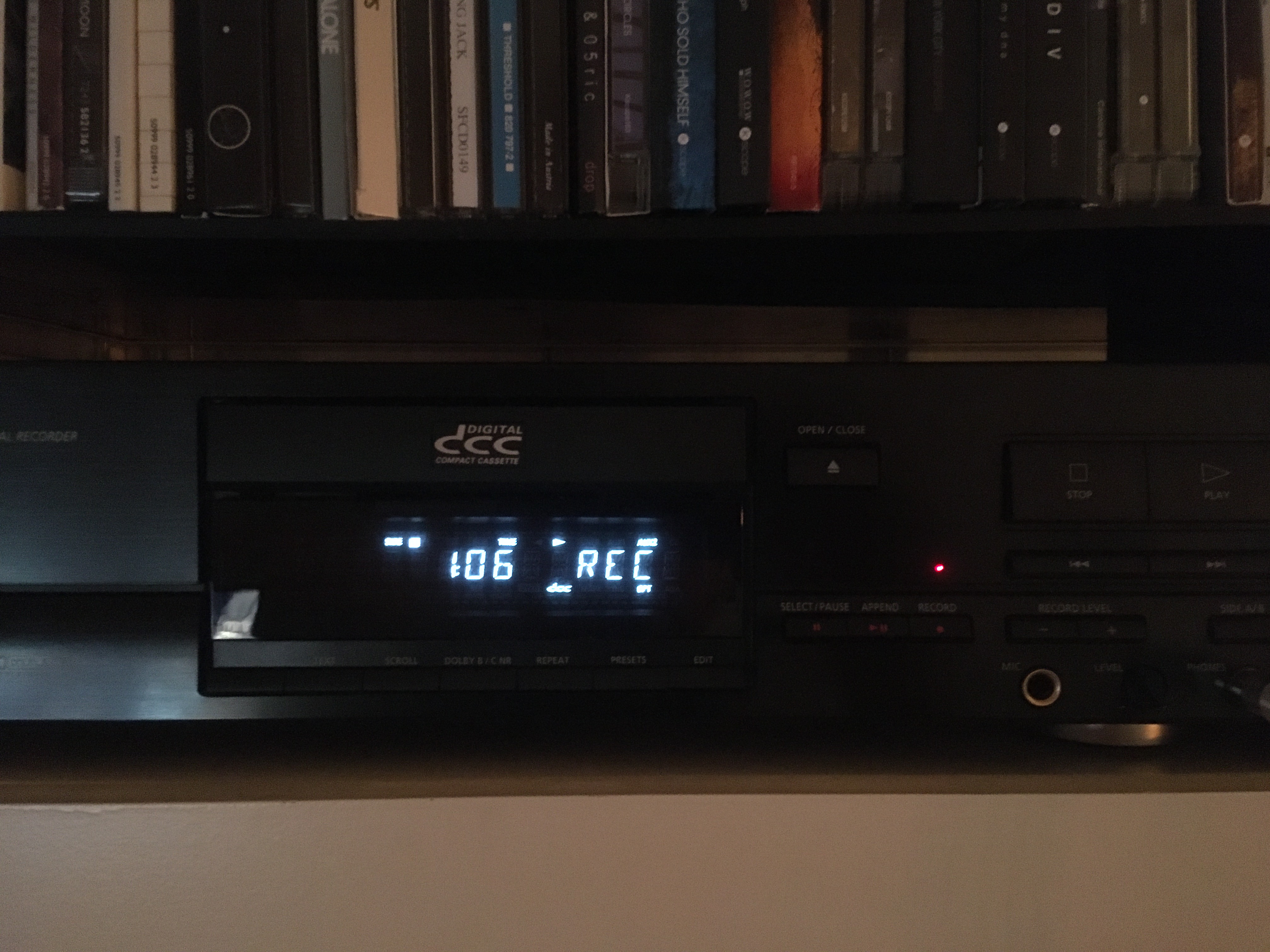

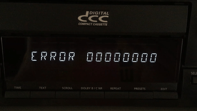

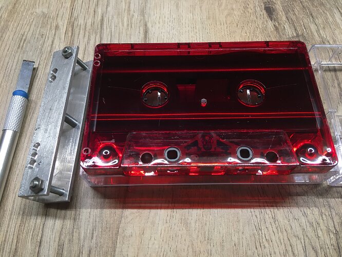

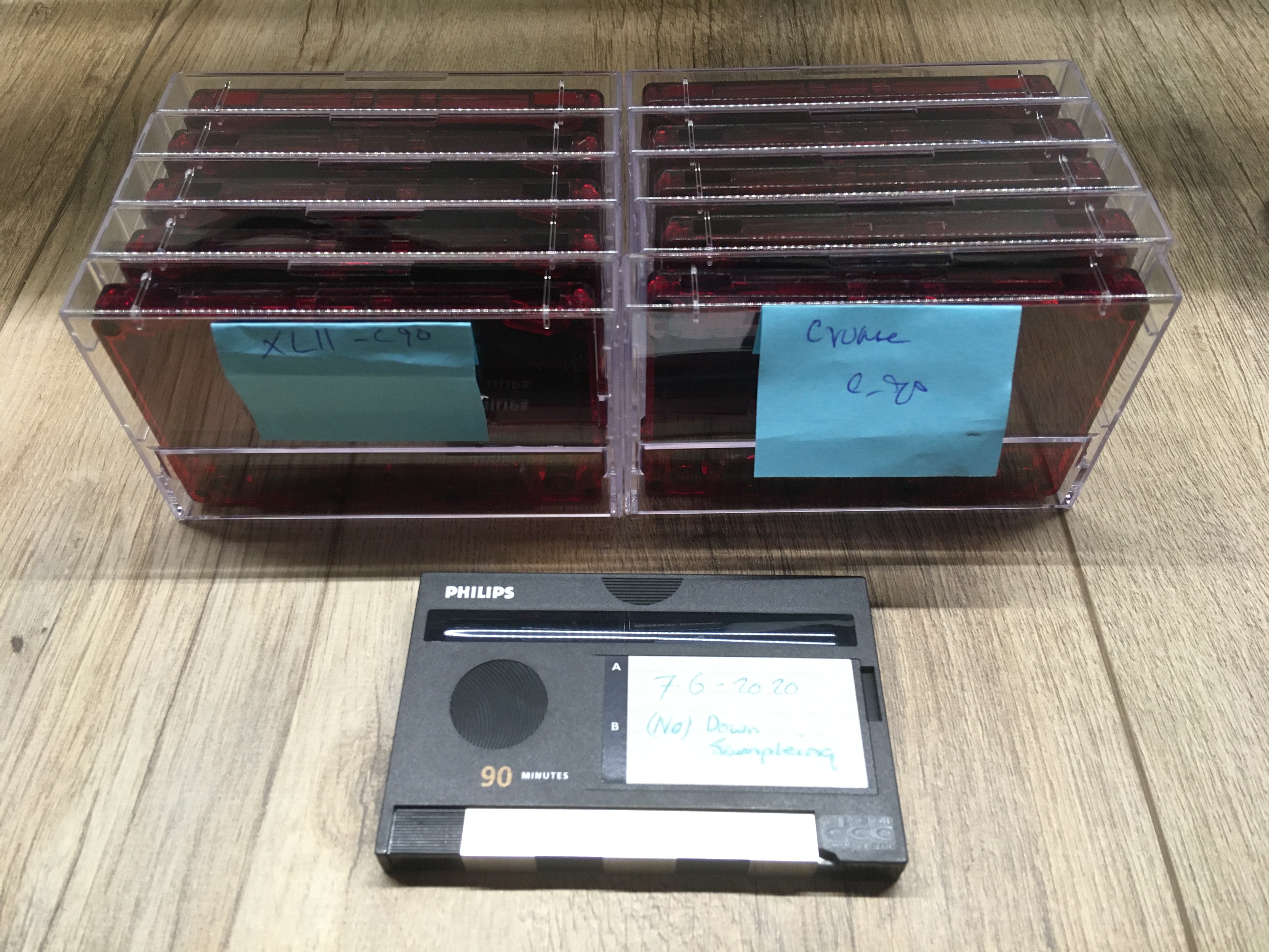

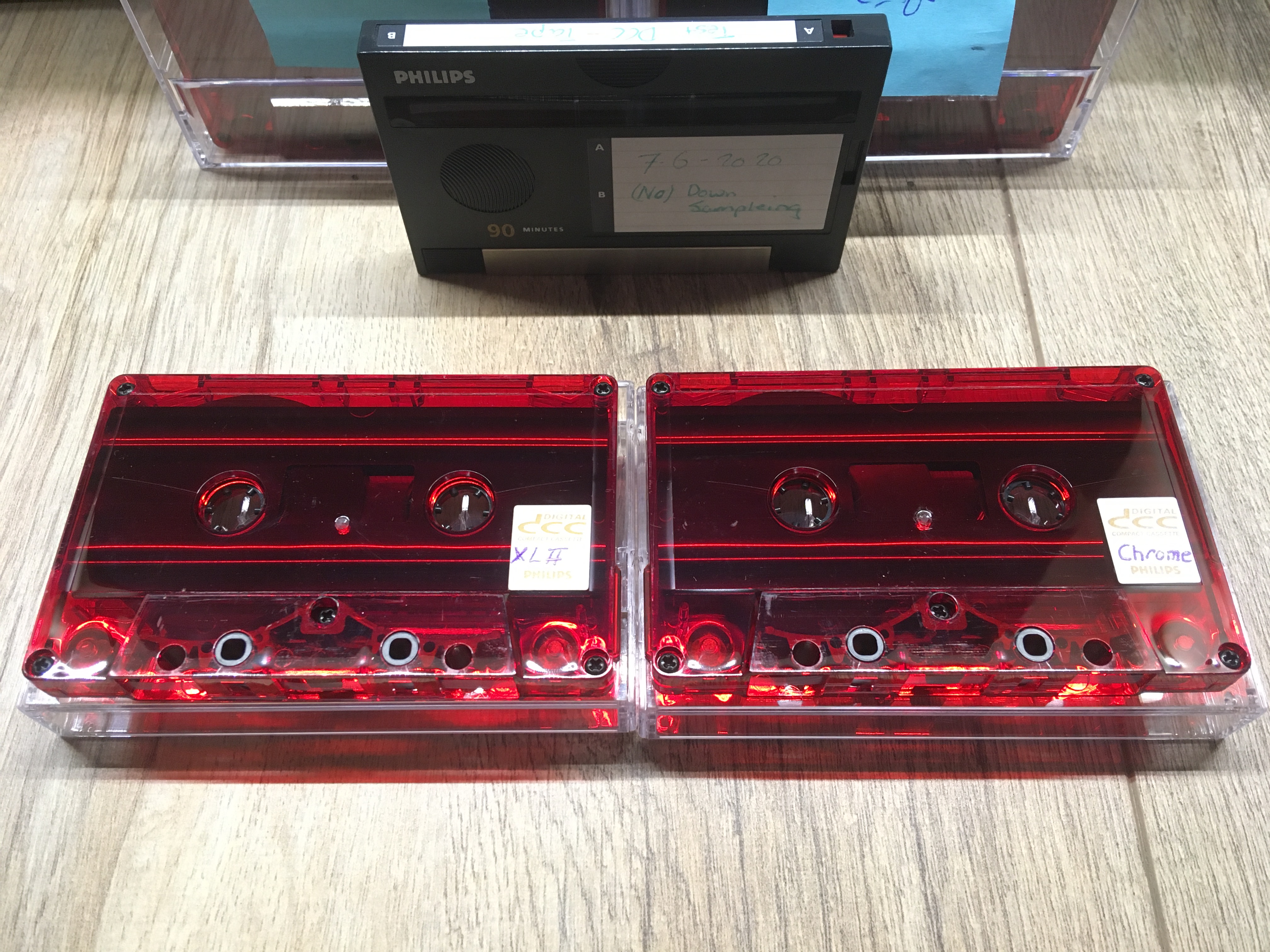

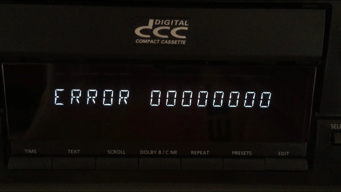

Today was the day that two types came in for testing,
based on the experience that we had a really small chance tot succes.
Here the results, NO good RECORDING POSSIBLE !!!
Note: sound of video is not comming from the recording.

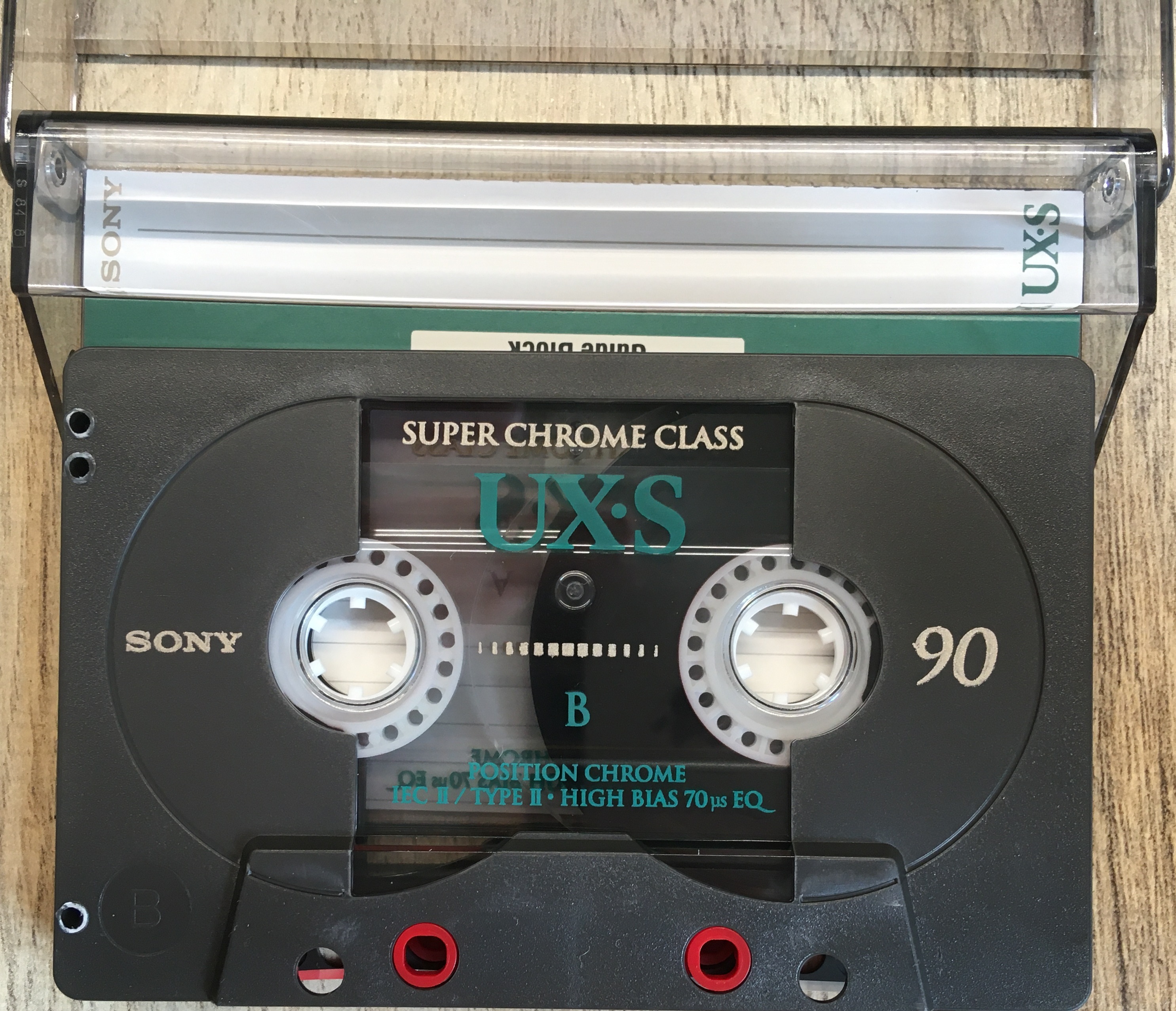

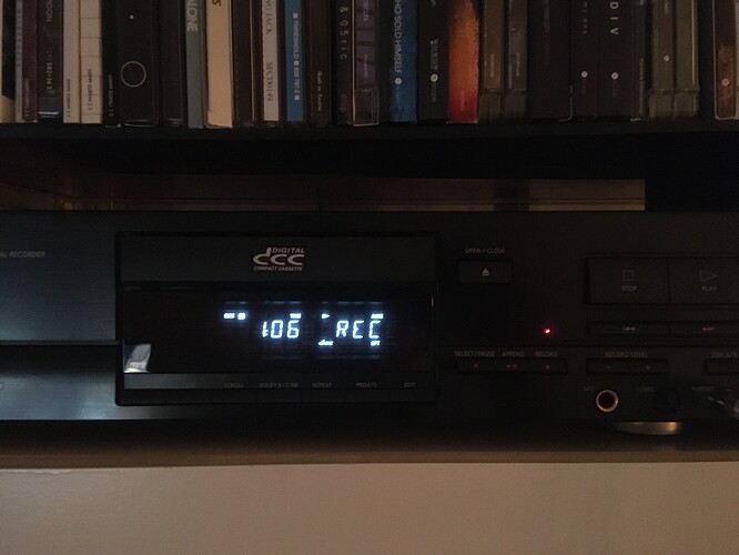

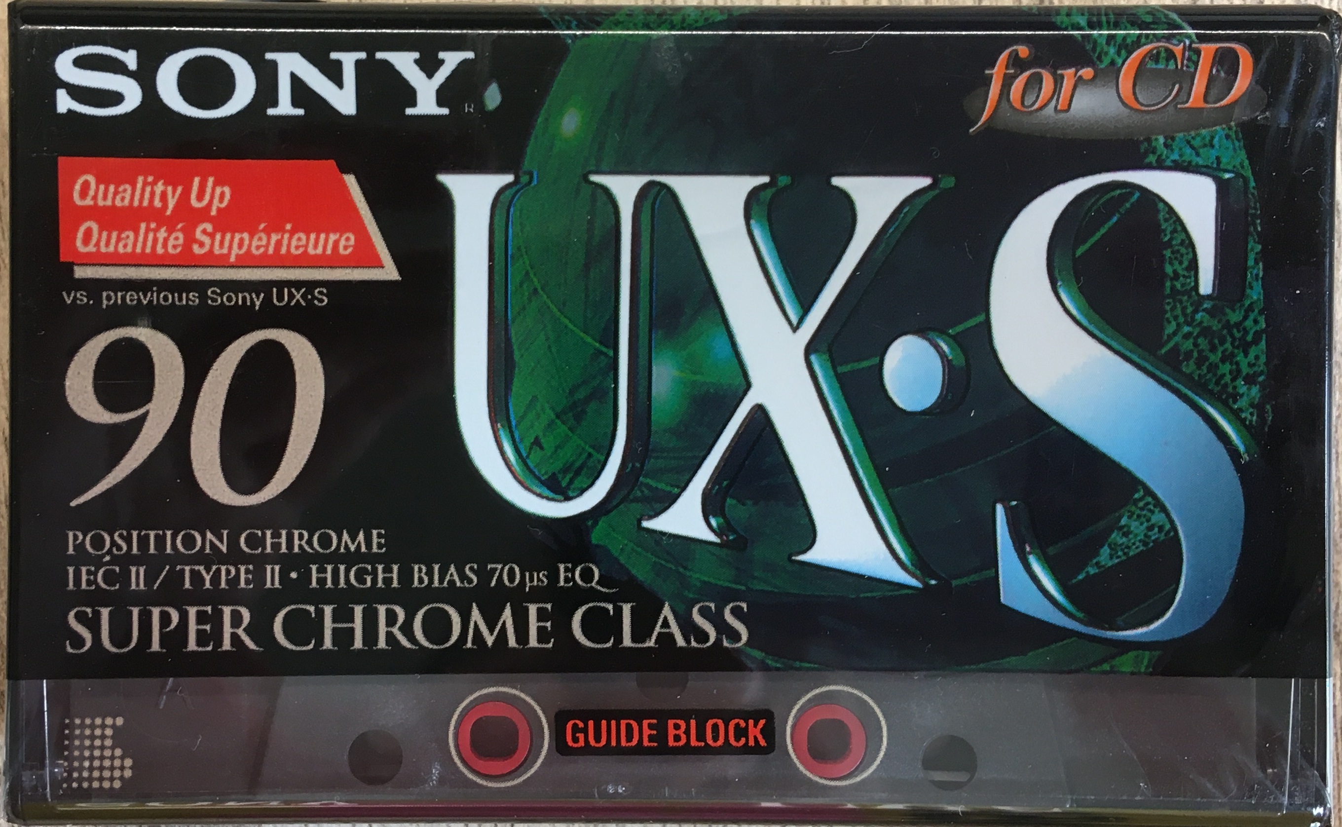

Before we ordered the red shell tapes.
We did a really positive recording with a NOS Sony UX-S tapes.
(note: we recorded a hole ablum and played in multiple players, merely is the tape not as shock proof as a normal DCC)
Till to day this is the only way to go …
… if someone has additional in signed let us know.

The only other thing that could be worth testing, if the tape of both would work in a original dcc shell?

The chrome tape is NOS but more of it is available then DCC tapes, it is younger and properly stored.

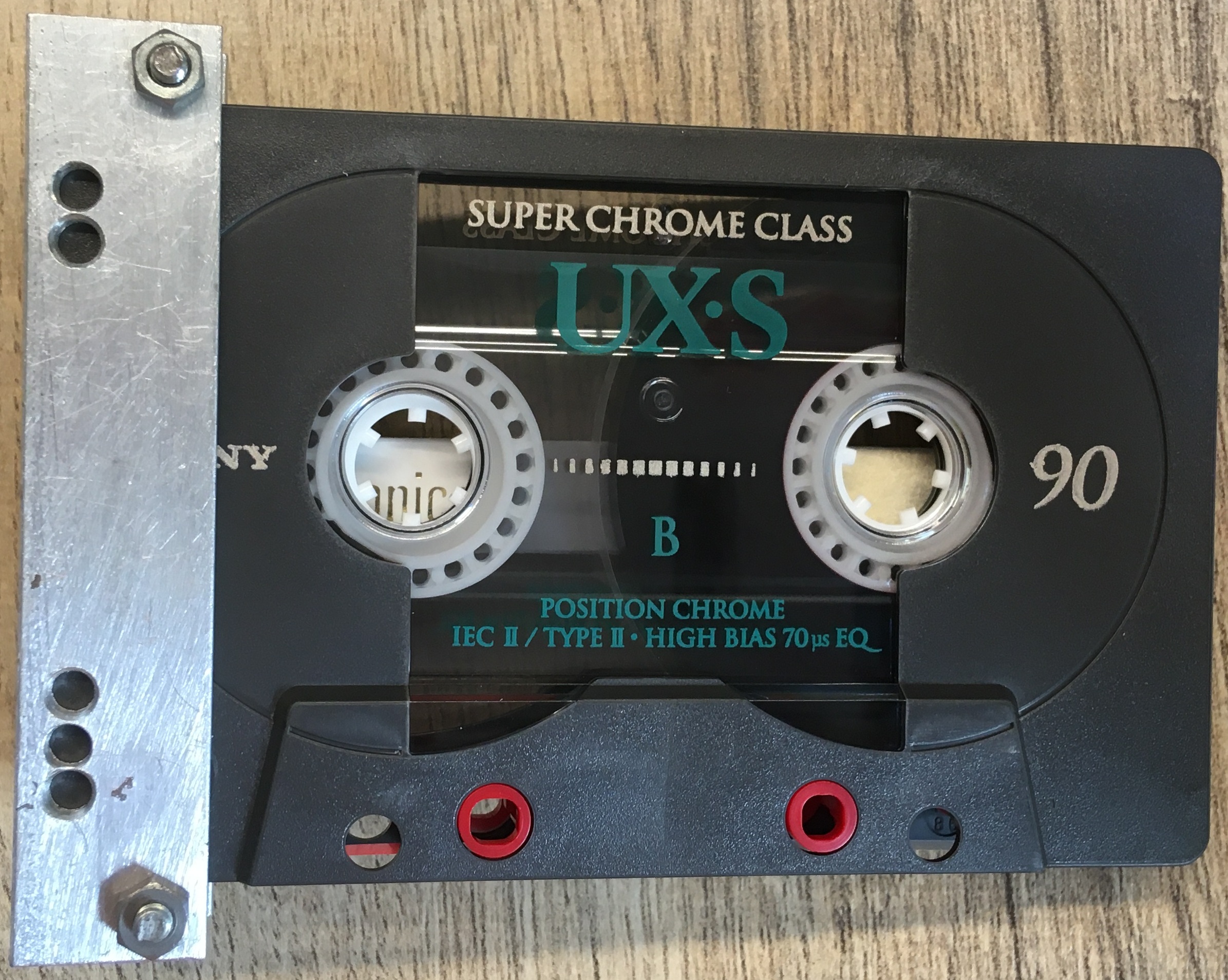

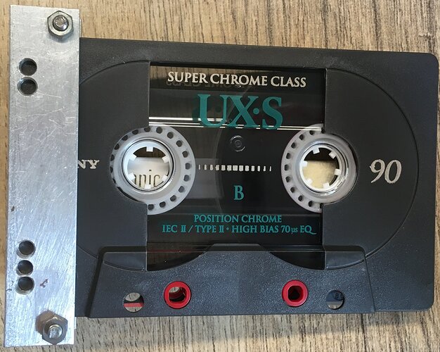

I know it’s an old thread, bit I did manage recording on a chrome tape. It was a sony and it said CD-IT on the package… drilled holes in it and it worked, even with the standard felt pad…
How about dropouts?
Well… if I recall it was doable… 3 dropouts per album. So for a standard cassette not bad. I guess this tape in a DCC shell would play even better!
Precisely. I am sure the overall construction of the shell contributes a lot to the stability. I am thinking of the tape guides inside, the foil, and of course the felt pad construction with the 2 metal ridges for optimum tape guiding and transport.
