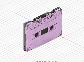

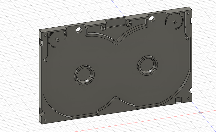

New DCC's Shells 3D & Tape type tests
Tim Drogt has made the STL files. Harrie Sonderen did the first tests.
It could be used for creating custom art work or even (if we find the BASF Chrome Tape) new tapes.

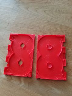

Wow! Its really cool to see my model in real life :heart_eyes:
Looks like Harrie did quite a good job with his printer. Cant wait till someone tries it with tape.
Of course il be able to edit the model if required

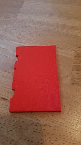

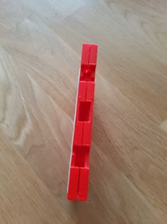

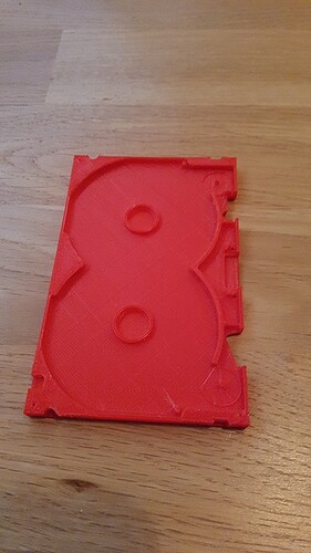

Hi Tim, thanks for the STL files, very nice.
i took parts from an old compact cassette to complete it.
The bladespring with pad won’t fit…
Now it is a gimmick dcc cassette.
Also it is not suitable for a cassetteloader like the KING from Thomas ( De Bandjesfabriek, NL ),
because the loops are closed, the long finger that glue’s the tape on the winderwheel, can’t get into this cassette.
Also it needs to be altered so you can use screws to hold both together, like a cc.
greetz, Harrie
I have thought about screws to hold both halfs thogheter.
Also i have the idea of using more of a CC design to get rid of the metal protective slider to reduce the parts (springs and such) needed.

The alloy slider is very difficult and expansive to reproduce.
This 3D printed cassette is not suitable for such a slider.
when calculating the costs of 3D printing, adding wheels, rollers, felt-pad and tape, i expect it will be extremaly expansive.

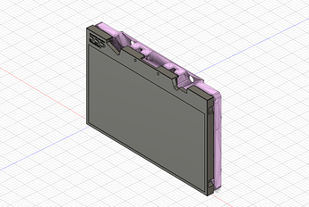

Ive reworked my original design into a bit of a cleaner cassette, taking hints from the original CC, ive ditched the aluminium slider and patched op the holes in the top of the shell. Ive also made sure that these shells could, in the future, be loaded on a cassette loader like Thomas at De Bandjesfabriek has.
https://drive.google.com/drive/folders/1hpW7EBhAv3r1lplu6FFqmZB6ESeS8UDy?usp=sharing
The metal slider was not needed for operational use. Just to protect the tape.

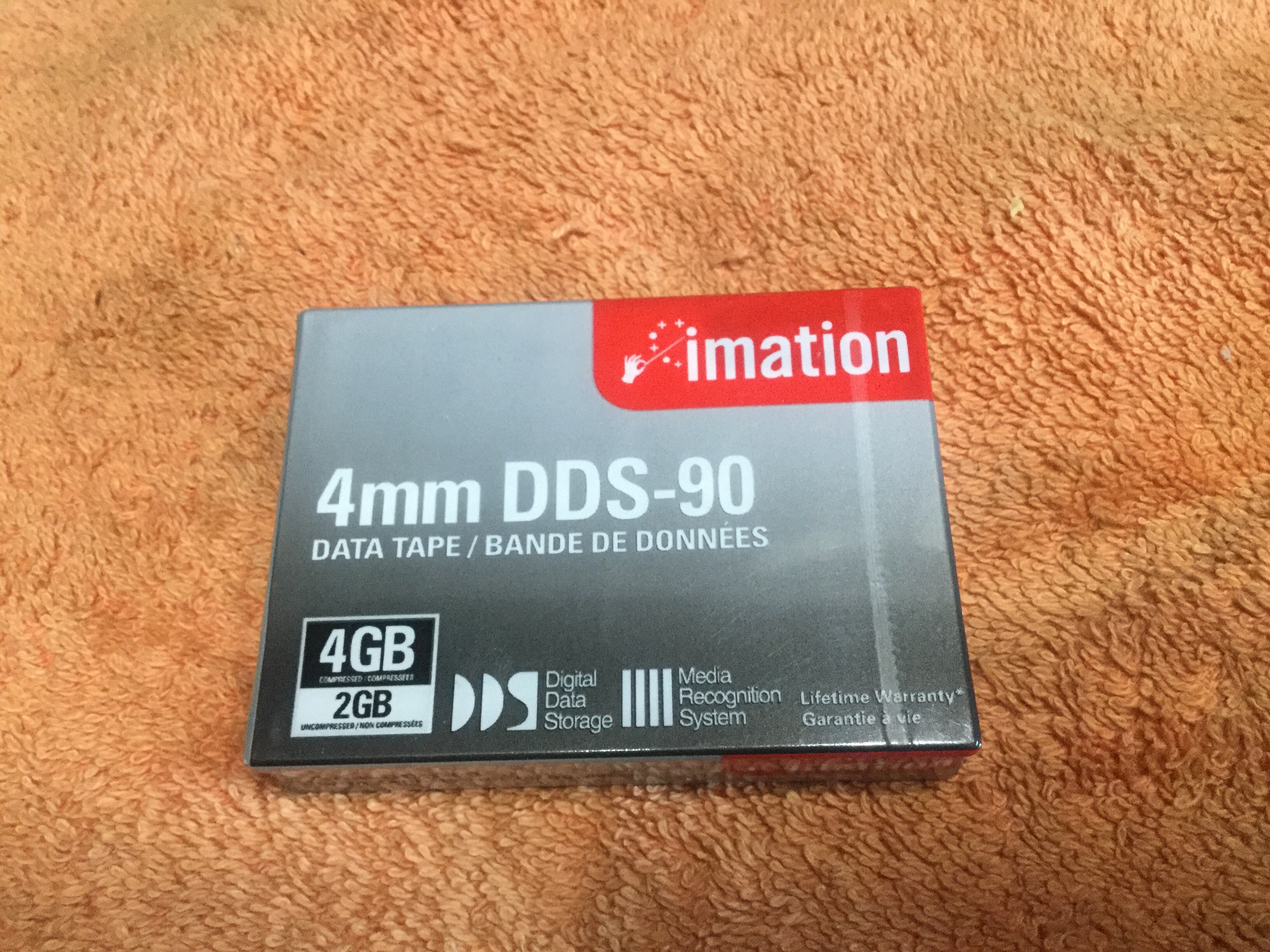

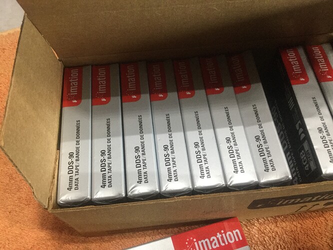

Hi everyone today I purchase box of dat tapes it says data tapes I wonder if someone change shell and use dat tapes for DCC
I do not know of anyone attempting this. With 4mm it might be a tad wide.
How wide is dcc tape in mm
DCC tape is the same 0.15 inches (3.8 mm) width as in analog compact cassettes
Thank you another words dat tape is 2mm wider
Dr DCC I watch your video Converting a analog audio cassette to DCC do you think that we can make DCC tape with anti vibration mechanisms?
Any chance to make adapter that can change regular tape to DCC?
It is 0,2 mm wider.
If we would have enough users and funds the hardware side of the tapes would be possible to reproduce.
