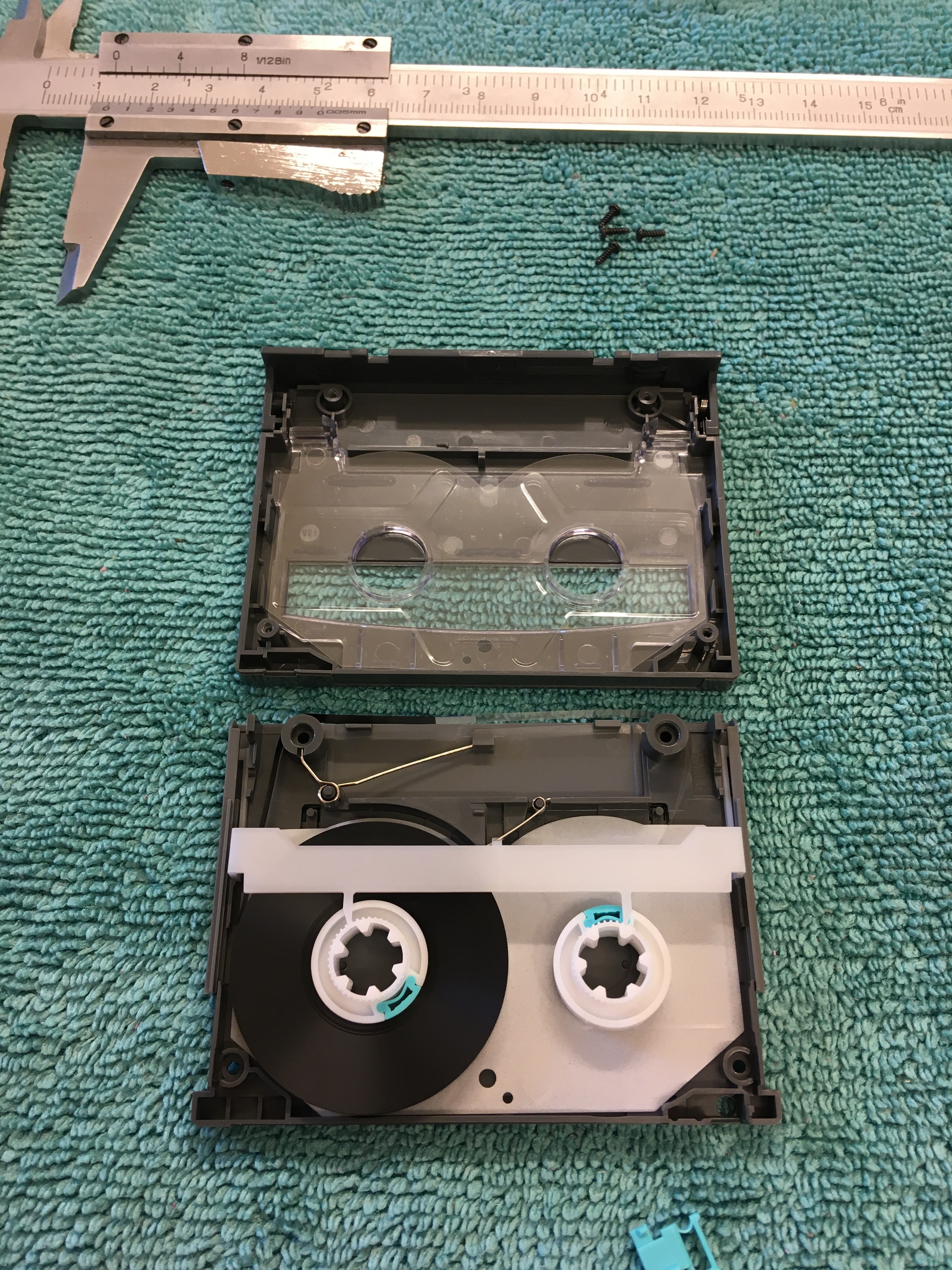

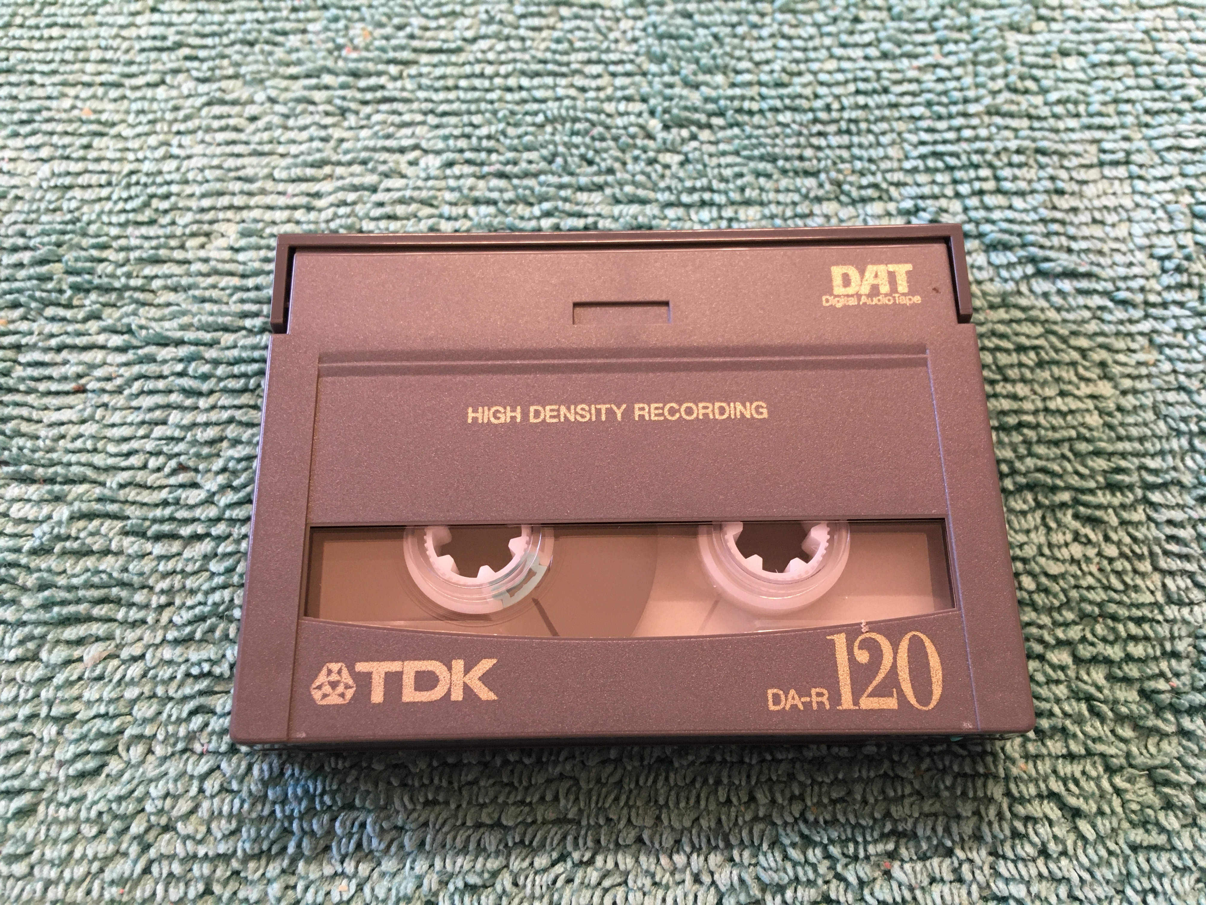

Today I have measured the width of both tapes with a capliplar.
On mine it’s 4.0mm on both tapes.
So I order a 120min DAT tape, so I can put it in a Shell for some testing.
Note: length will be approx 41 min.
Keep you posted.

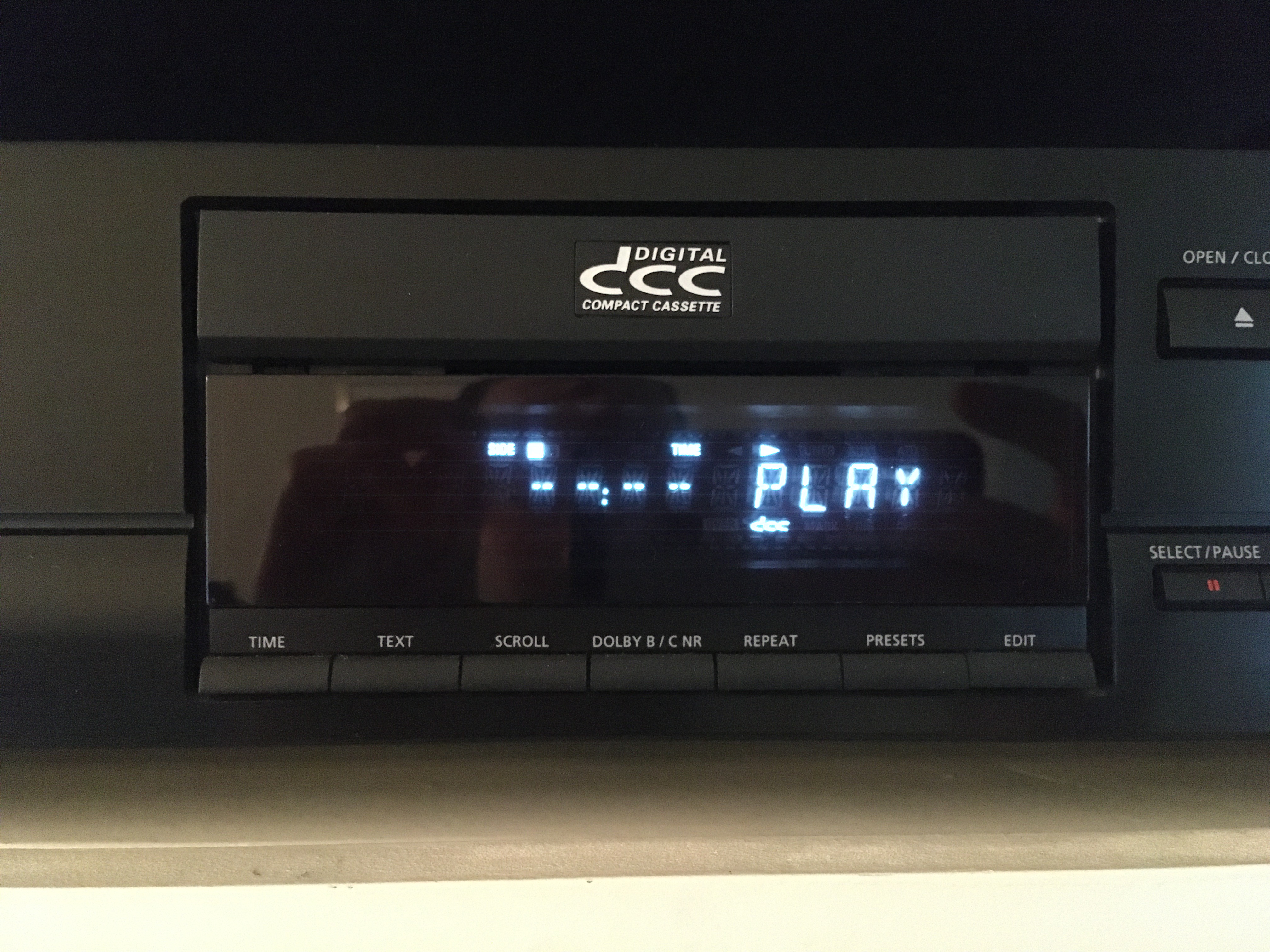

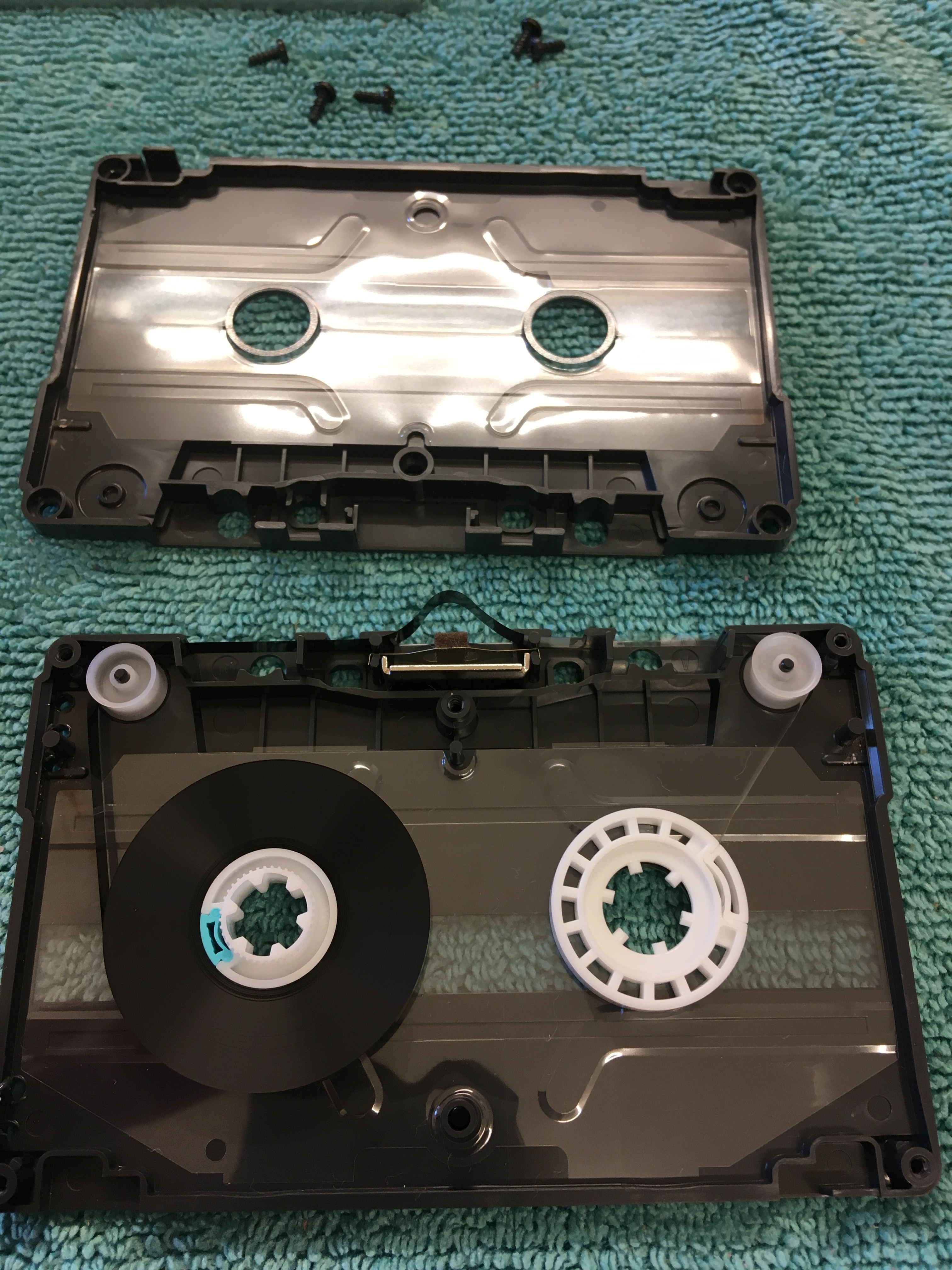

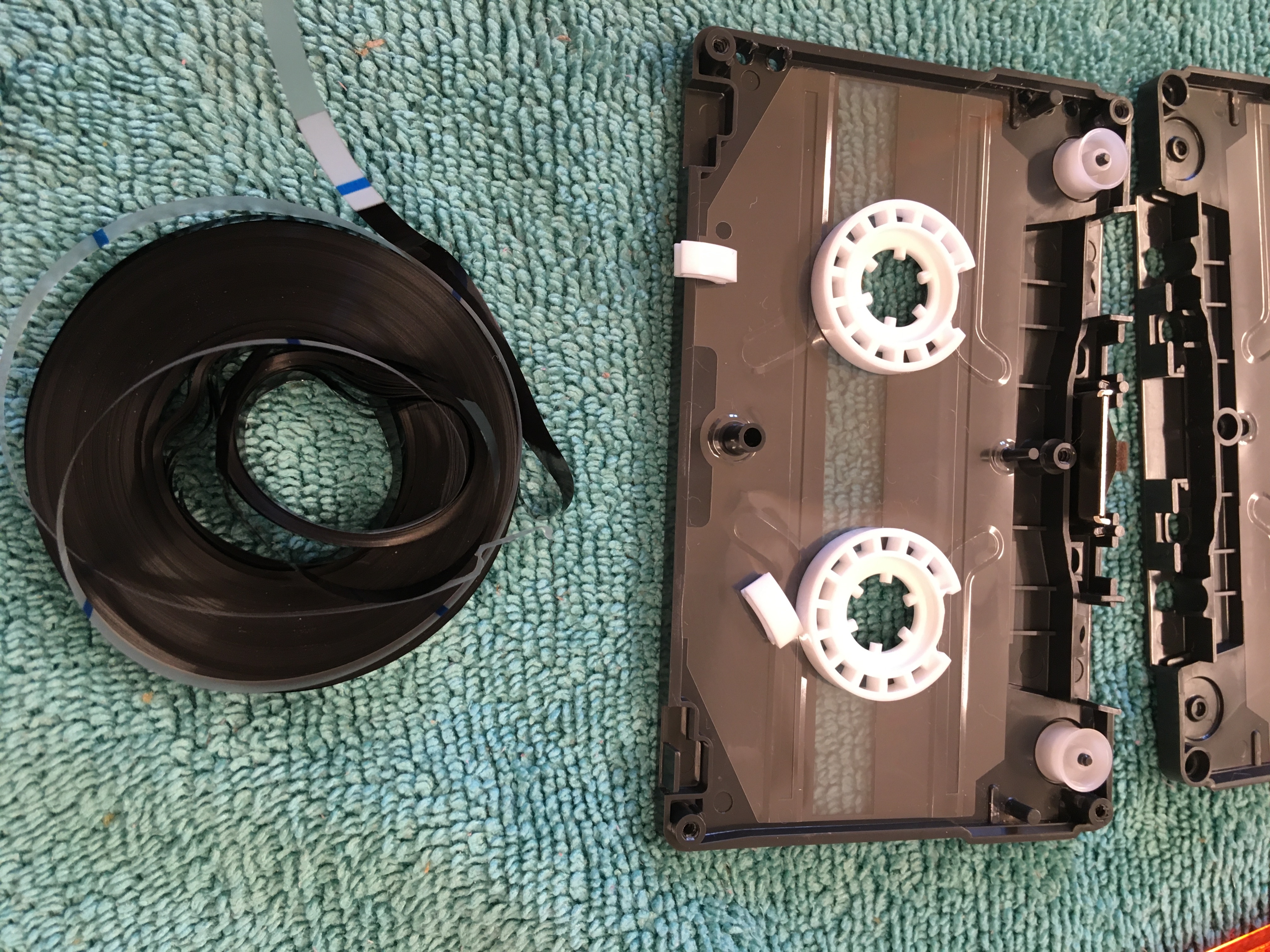

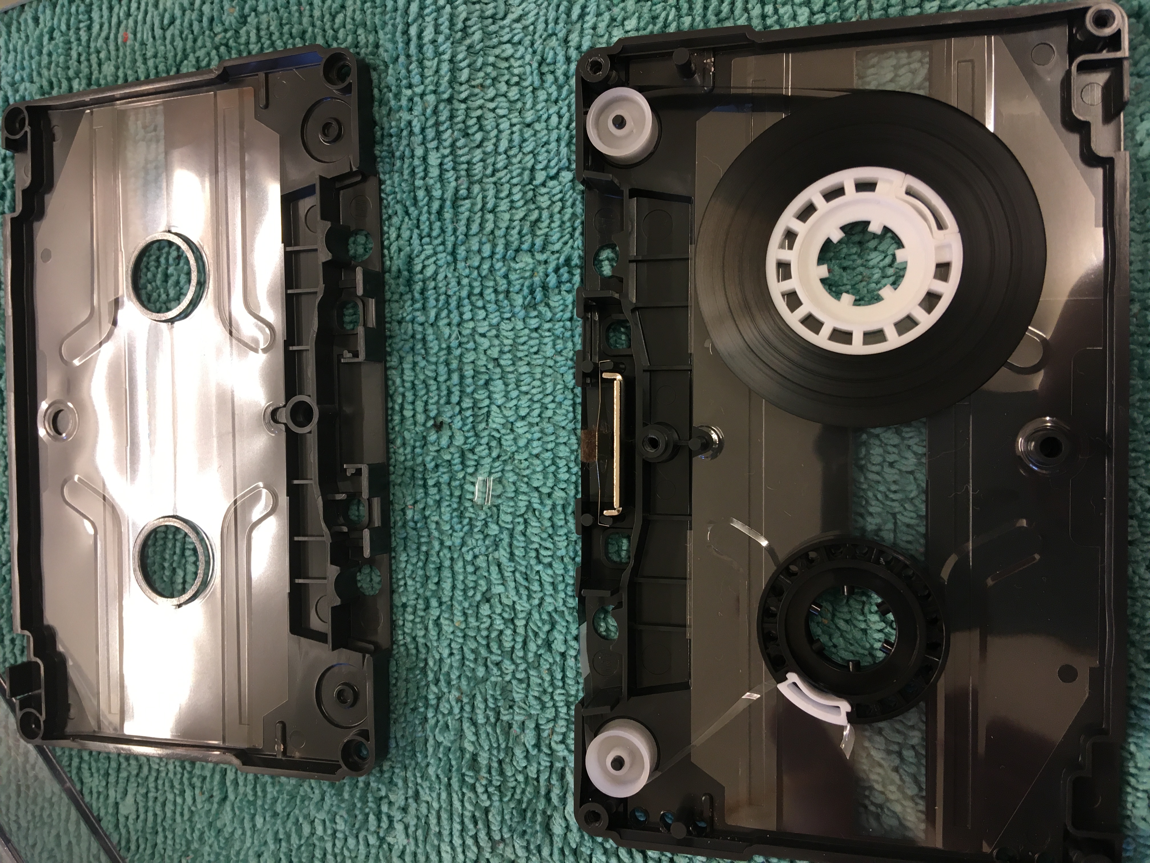

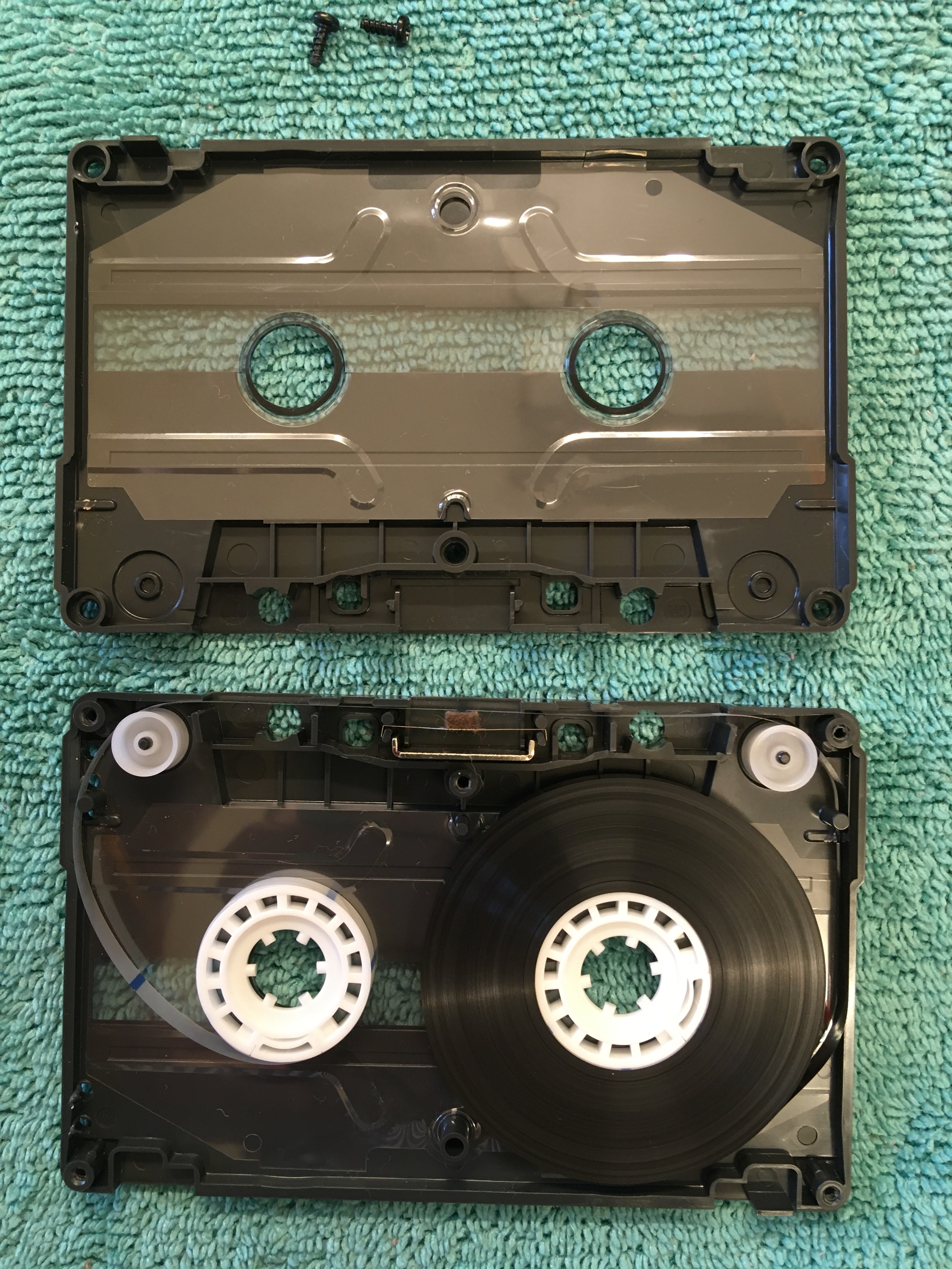

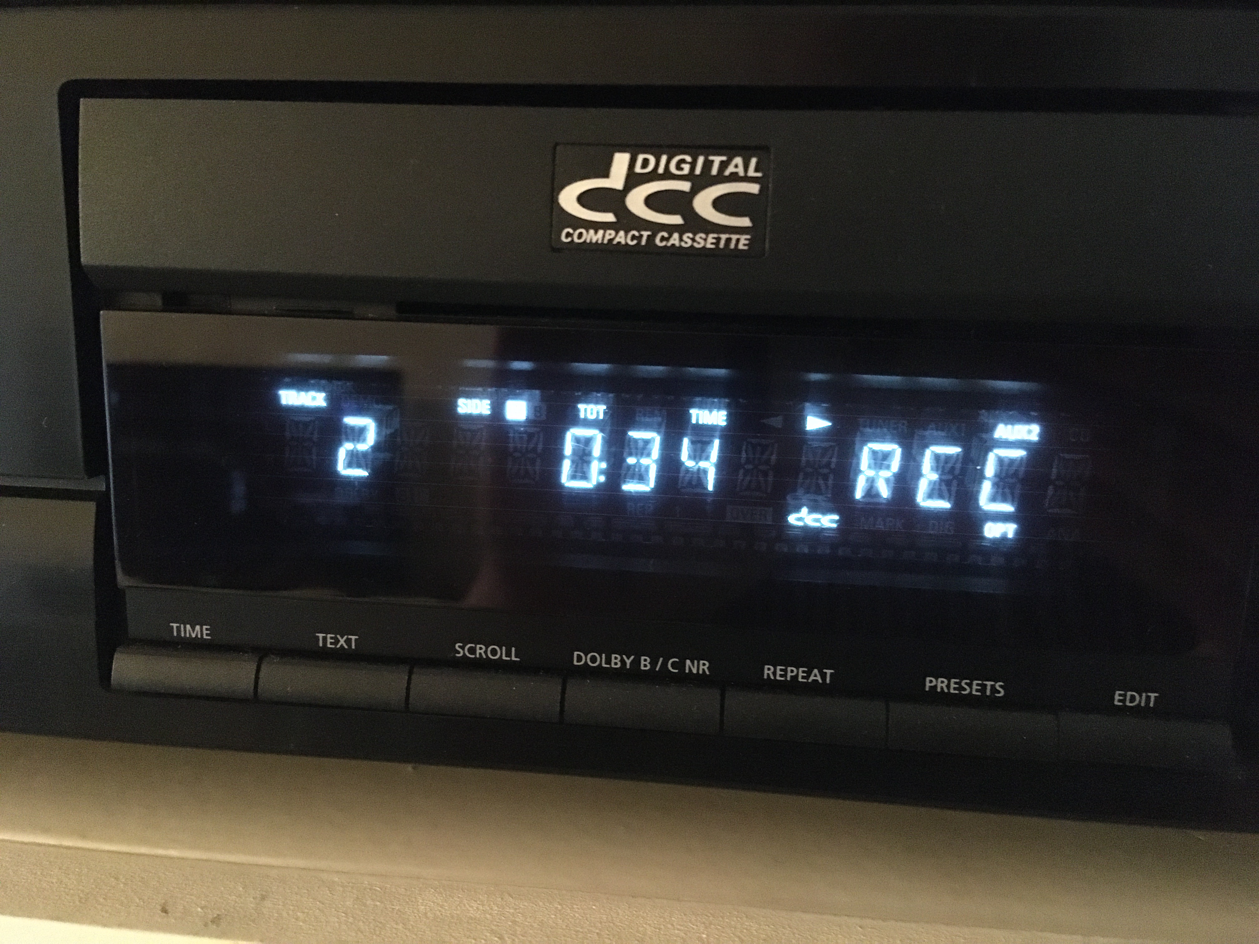

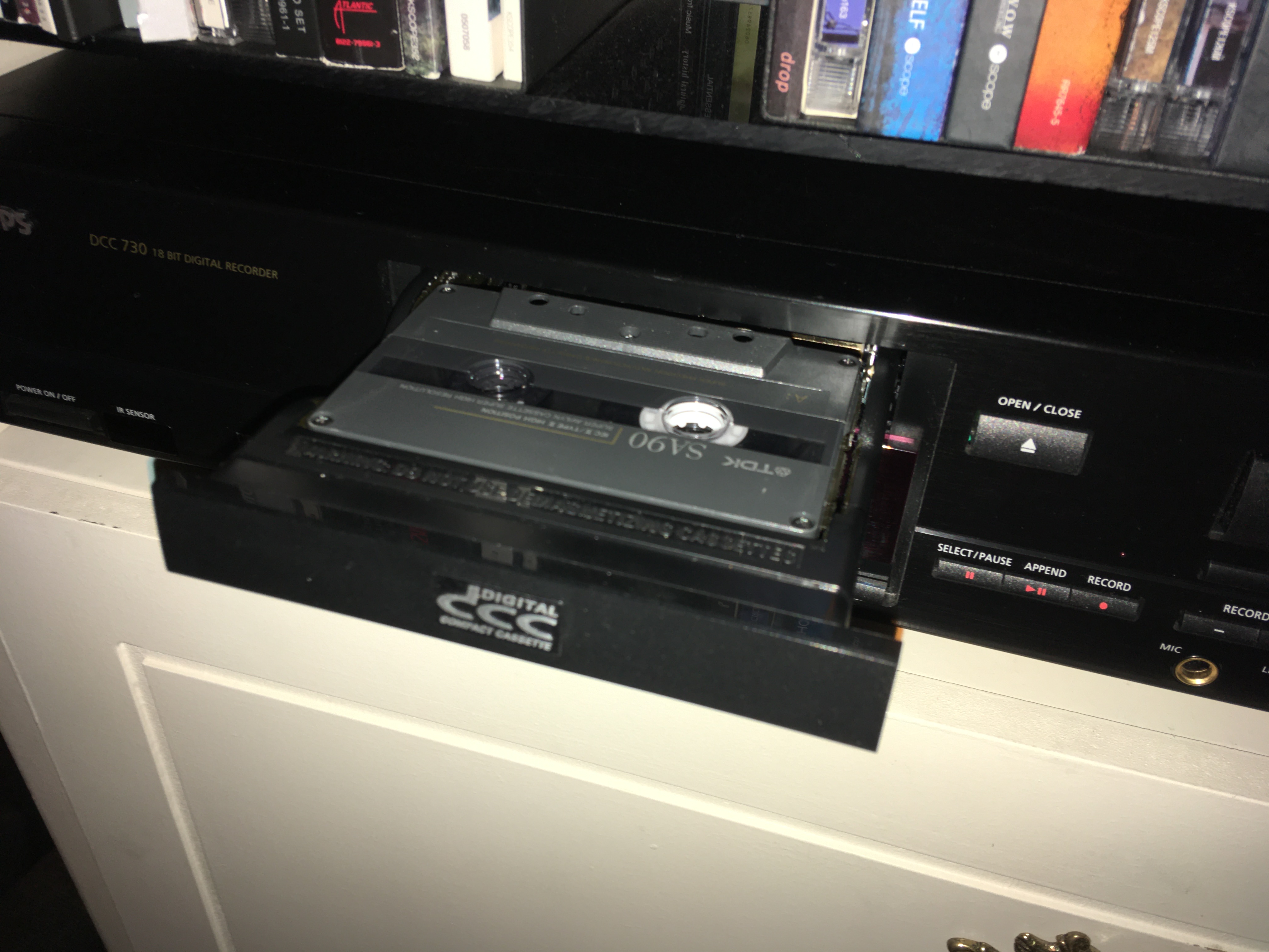

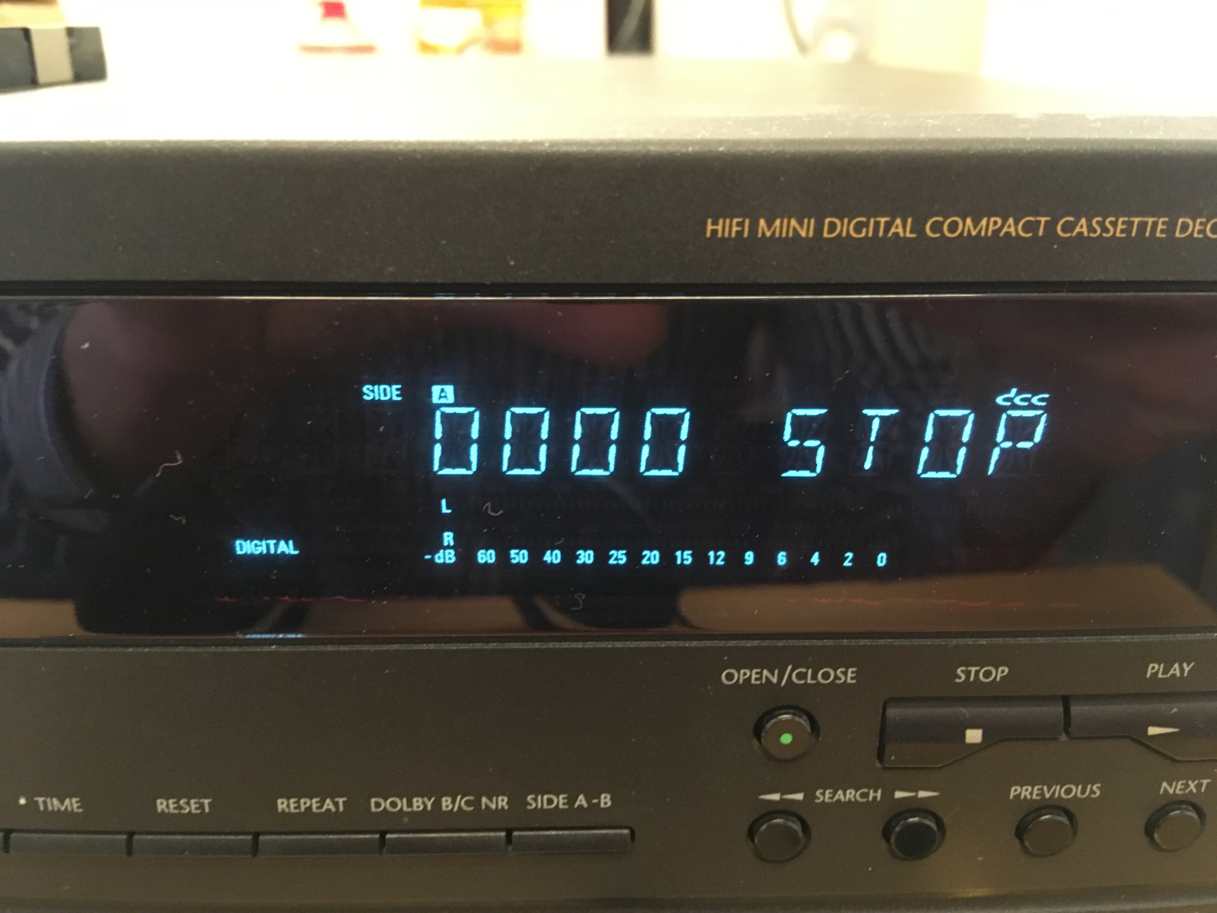

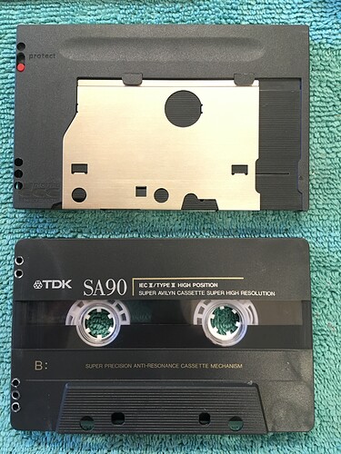

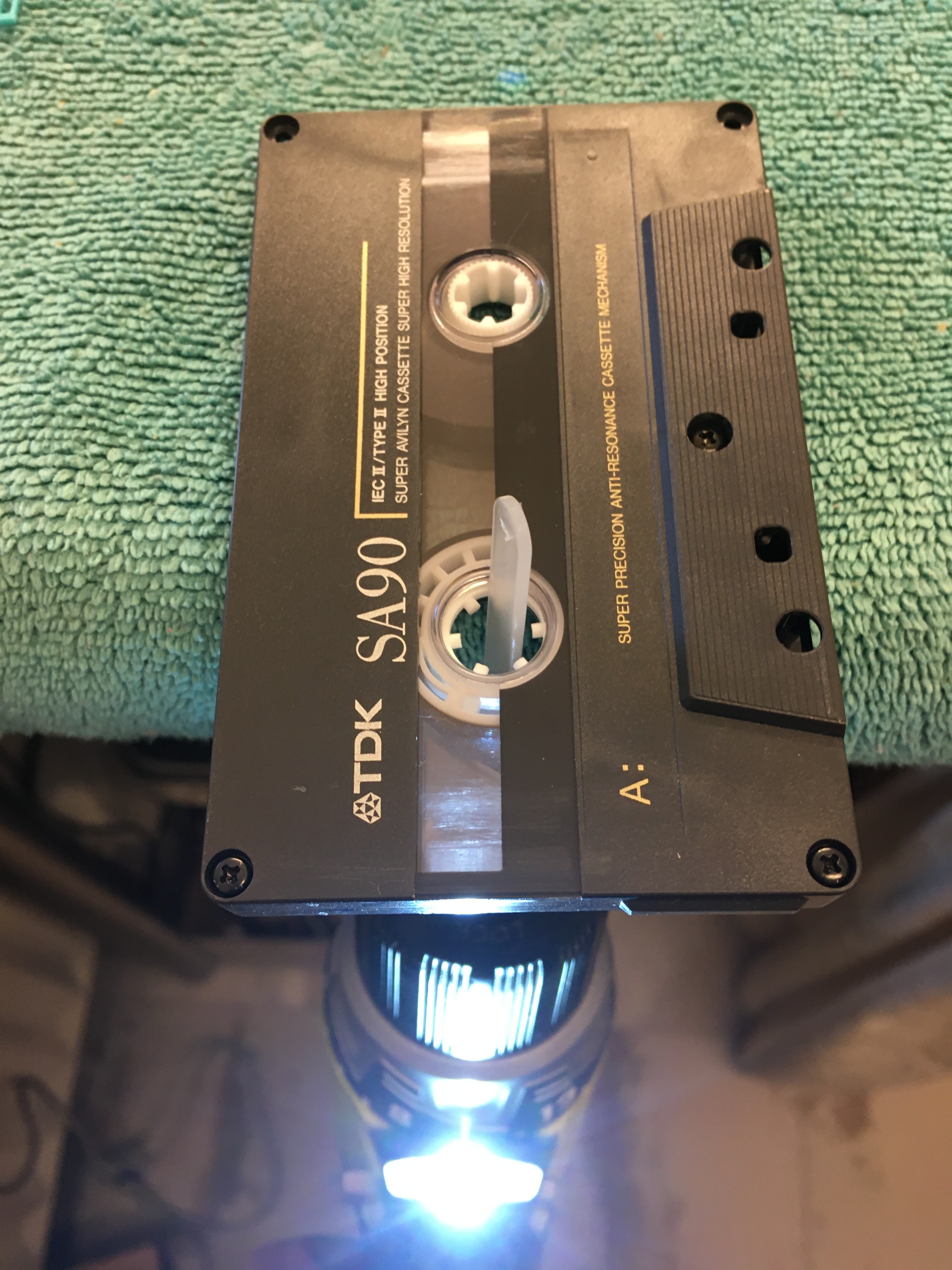

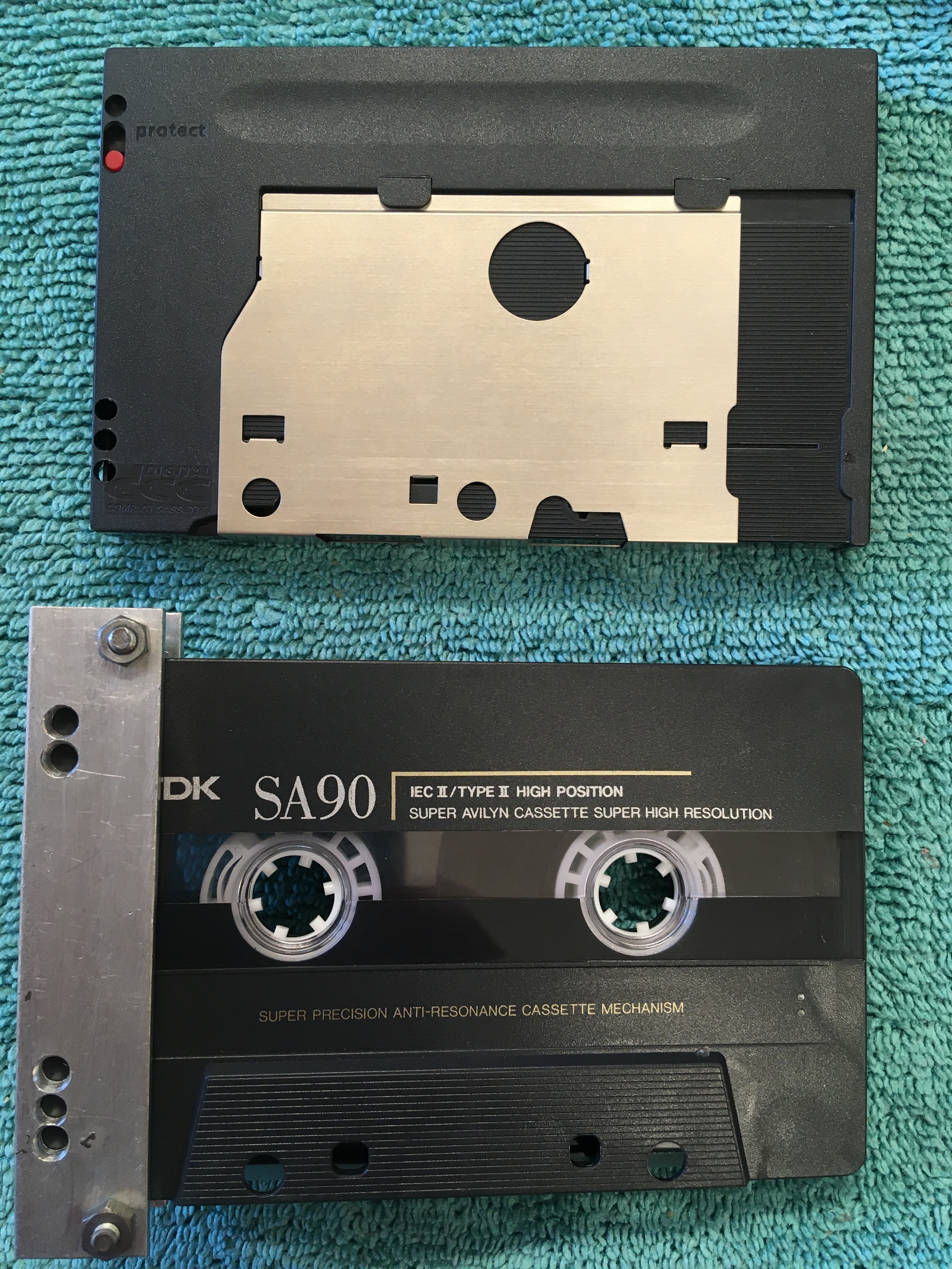

Dear All,
Pictures above, they are telling the story!
After putting the DAT tape in the ACC with the DCC holes.
I can say the after multible test, I had ZERO result.
Even with the original filt pad, with no beeping sound.
So for now, TDK DAT doen’t work with DCC ![]()
Greeting Jorn.
To the next test.
It was worth a try.
We will find the right tape!
