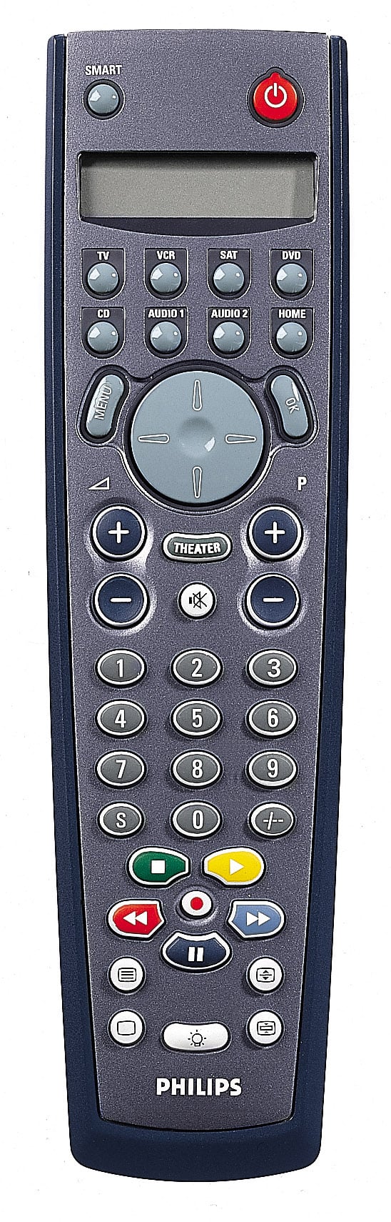

I like to looks of this one! What’s so good about it? Is it also programmable with everything imaginable?
@rolf
It’s a super simple remote from the operator perspective. Which made it the prime choice for my
tech illiterate mother and my husband. They have no clue how it works, but when it says ‘theatre’
it does what they want.
And you can teach it anything IR based.
It knows a lot of IR stuff by itself but the rest can be taught or copied around.
Theatre mode combines several devices to one control surface.
Pity Philips stopped their home automation stuff (simple “klik aan klik uit” like domotica).
That could be done with this one too…
I had one of those Philips remote controls before I emigrated. It worked okay and was much more comfortable than the stupid pillbox remote controls that I got with my Marantz Slimline system. But it’s not even close to a Harmony.
A Harmony can be programmed to control devices for which you don’t even have the remote control, so no need to have the original and no need to do a bunch of time-consuming learning. And the Harmony database also includes codes that are usually not found on the original remote controls, such as “power on” separate from “power off”; usually remote controls only have “power toggle”.
And in the Harmony you can program a couple of “Activities” (e.g. watch TV, listen to a tape etc.) where you just tell the remote control which devices need to be on, and which inputs of the receiver and TV etc. need to be selected. You just push the “watch TV” button and it knows which codes to send. And if the remote control is “out of sync” with the TV or receiver or whatever, you just push the “Help” button. “Help” first sends the codes to change the inputs on all devices, then it asks if that fixed the problem. If you answer “No”, it asks if each involved device is powered on, and turns it on if you say it’s off. Then it asks for each device if the input selection is correct. Brilliant stuff, and since I’ve owned one, my wife has never needed to ask me to “fix” the stereo.
I like how the top buttons resemble the Philips logo!

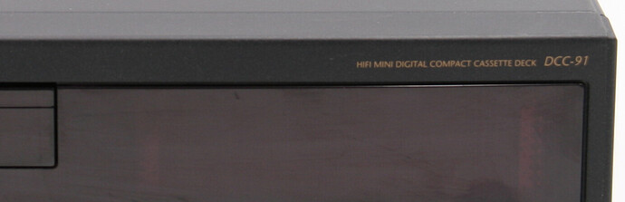

Does the DCC-91 actually have an infrared receiver? I think you may have to connect it to the remote control bus of a system that receives the remote control codes and puts the codes on the bus.

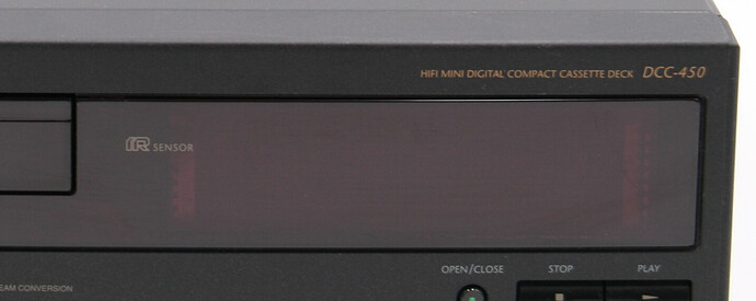

My DCC450 happily receives command from its own remote, so I’m pretty sure the DCC91 will do exactly the same.
@Jac @PaloAltoMark Actually.. de DCC450 features an IR-sensor logo, where the DCC91 doesn’t.
I guess Jac is right!
