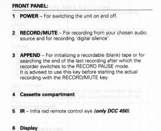

Interesting. I used a flashlight to illuminate the red plastic front panel so I could see inside the unit without actually opening the chassis. On my DCC-91, there is a circular area in the plastic under which one would expect to find an IR sensor. If my unit was a DCC-450, that circular area would be located beneath the IR Logo. However, I don’t see an actual IR sensor located in the circular area on my DC-91 (Just a place in the plastic where one would expect to find an IR sensor). Since the DC-91 and DC-450 are so similar, it’s possible that the same red plastic panel was used for both units, even though the DCC-450 has a sensor and the DC-91 does not.

The combined DCC91/DCC450 service manual (including schematics which go beyond my current knowledge) is available on the website: Philips DCC91 « DCC Museum
Most definitely the reason why there’s no sensor in the DCC91 is that it’s intended to be used with the FW91 system. The DCC91 was a separate purchase from the system so you could add it later (I have the manual for the system and it doesn’t give information about the DCC recorder; it just refers to the DCC recorder manual).

You can download the service manual for the DCC-91 / DCC-450 from my website.
Hi Rolf
Thanks. That solved the issue in 2 seconds. The service manual indicates that the IR sensor is in model 450 only, not 91. (See below from service manual)
It appears the remote for the whole system of components is in the amplifier which I don’t own, so I think I’m out of luck.
