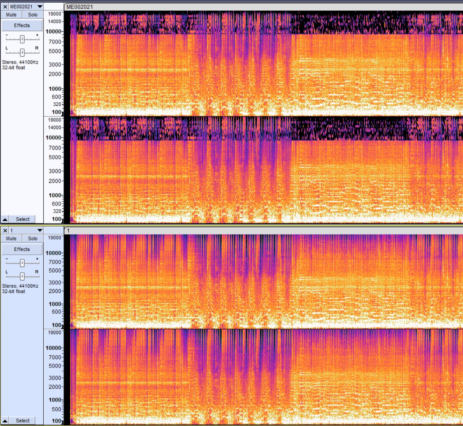

I think I found an issue in the mp2enc (latest version). I stumbled upon a piece of music that is encoded with major artifacts in high frequencies, similar to very low bitrate mp3 (think lower than 96kbps).
The findings are the following:
  1. After a conversion using mp2enc and recording via DCC175 major ‘low bitrate’ artifacts are introduced.
  2. The artifacts are not present when using a standard Philips DCC2WAV utility.
  3. The artifacts are also absent when recording directly to DCC951 via coax input.
This makes mp2enc the major suspect, but I’m not sure how to troubleshoot this. Definitely it breaks the most convenient way to prepare recordings for DCC175. The recording is highly compressed, ‘loud’ with wide frequency range, so it could be difficult for an encoder. But the hardware encoder in DCC951 is apparently not impacted.
I would really appreciate if you could find time to look into this issue. I shared the source track to reproduce here.

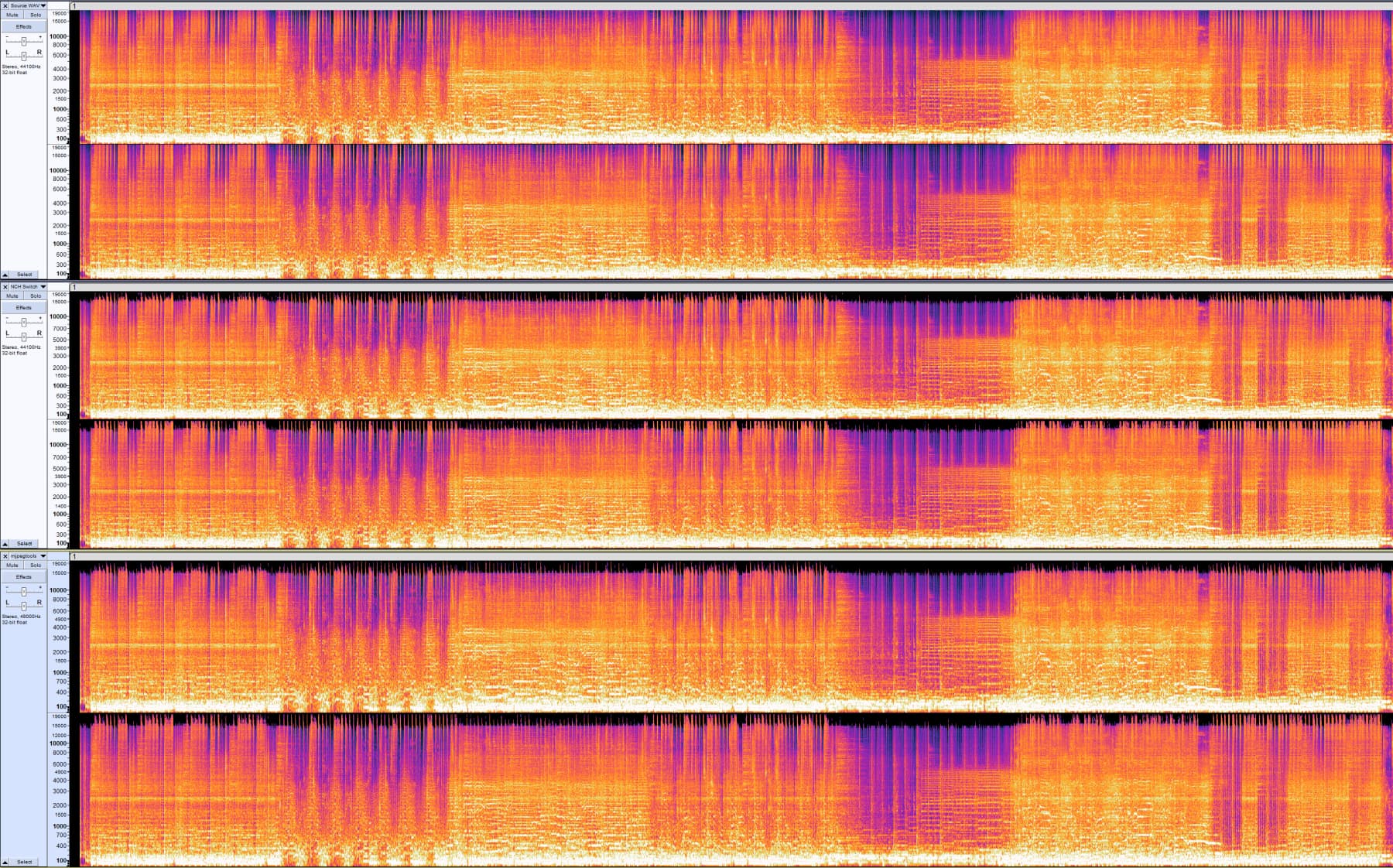

A quick follow up with additonal findings:
  1. I converted the output of mp2enc to a standard MP1 file using the DCCU utility. The spectral analysis shows that all frequencies above 9khz are severely distorted.

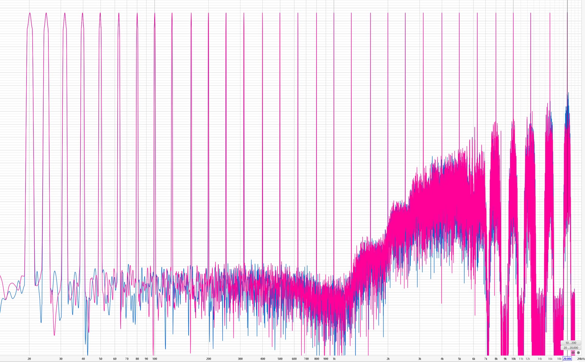

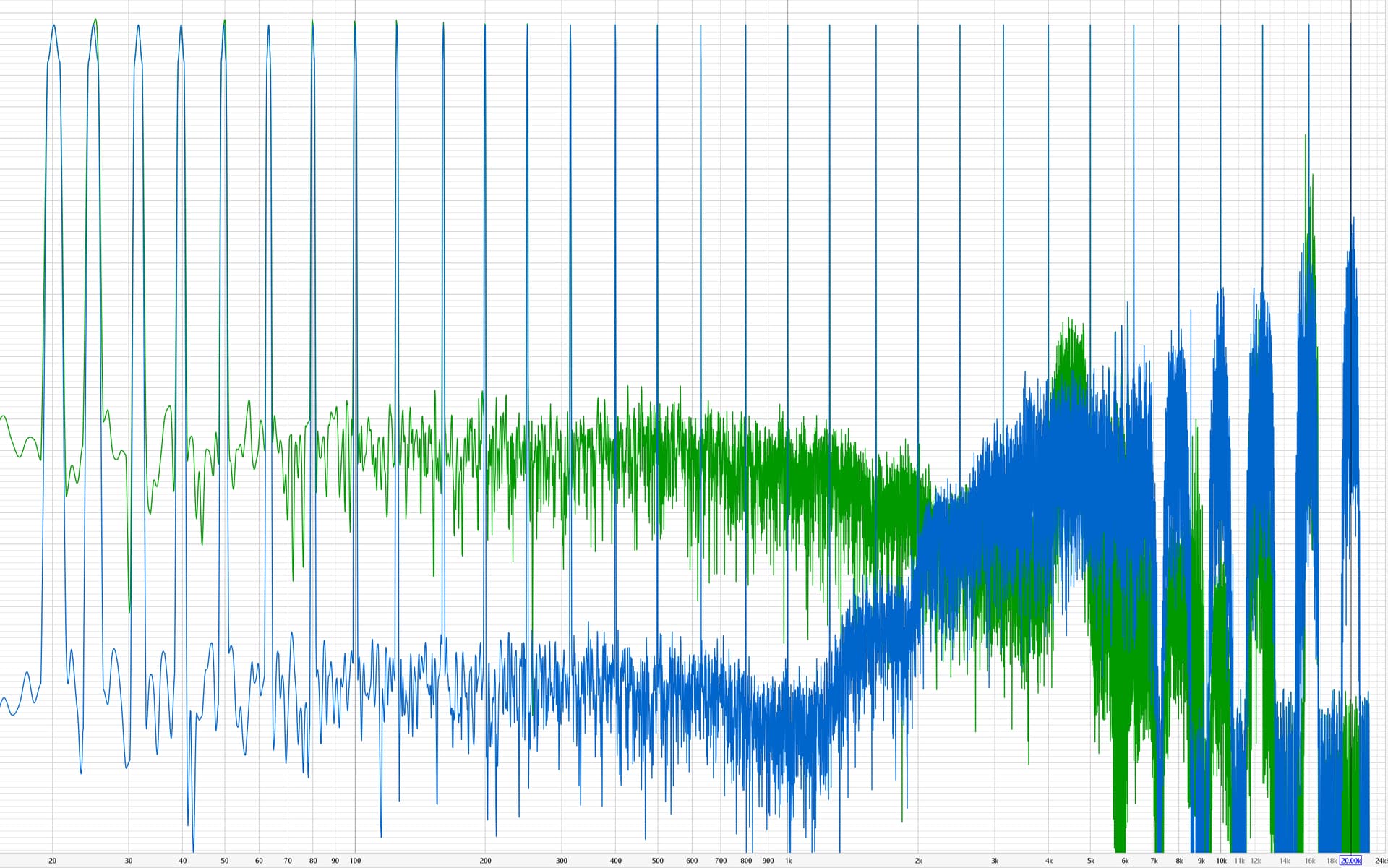

  1. I tried to compare these encoders in a different way. In Room EQ Wizard I generated a multi-tone signal that spans the entire audible range, from 20hz to 20khz. For lossy compression algorithms this is the worst-case scenario: lots of audible data across the entire frequency range. Analyzing the artifacts introduced by compression does not offer judgement of the actual sound, but allows to compare the ‘raw’ performance of different codecs. To start with, here’s the source file:
31 tones from 20 to 20000 Hz. Then I encoded this test signal using the NCH tool, and also recorded the same signal to DCC951 and extracted the file via DCC170. Therefore, we are operating in the digital domain only, and compare only the performance of lossy compression. Here’s the result:
Green is NCH, blue is DCC951 hardware encoder. Although in reality these differences may be inaudible, I suggest that (a) NCH encoder is noticeably different from the one provided by the DCC951 and (b) DCC951 hardware encoder offers higher fidelity. Not only the noise floor is lower, DCC951 also preserved the highest 20000Hz tone, while the NCH encoder removed it.

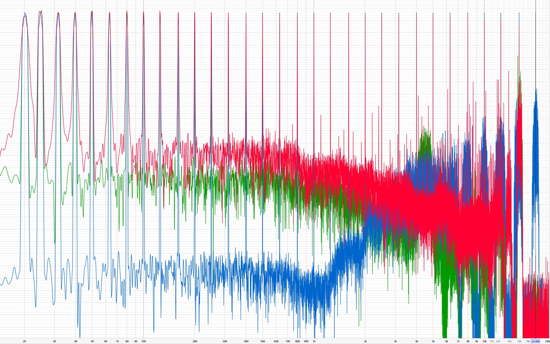

Finally, I added the mp2enc from mjpegtools, in red:
The downside of this encoder is that it does not work with 24bit audio files, only 16 bit. It is also noisier, distorts lower frequencies a bit and there is a certain rollof in the higher frequencies (starting from 5khz), that does not exist in other two tests.

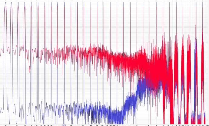

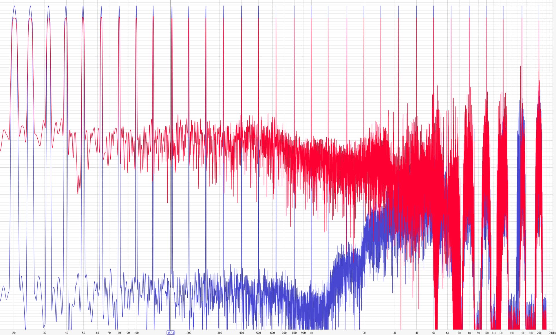

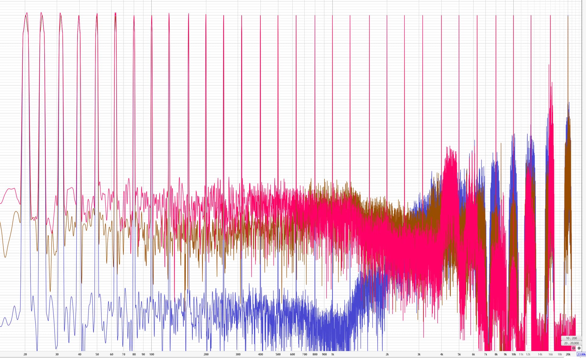

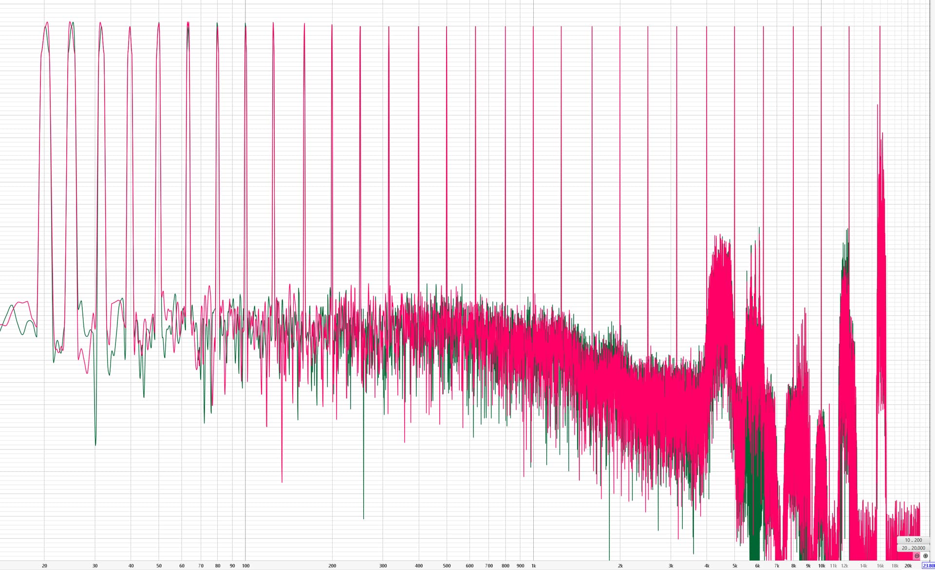

I sourced an old encoder that appears to be based on dist10 (from here). It allows to select one of two psychoacoustic models. Model 2 in multitone test is virtually identical to NCH:
NCH - green, SoloH-dist10-Model2 - pink
Model 1 acts differently, with less noise in the lower frequency range, and it also retains the 20khz tone. But they are both different from the DCC951 (or DCC2WAV) output:
dist10-Model2 - pink, dist10-Model1 - brown, DCC951 - blue.

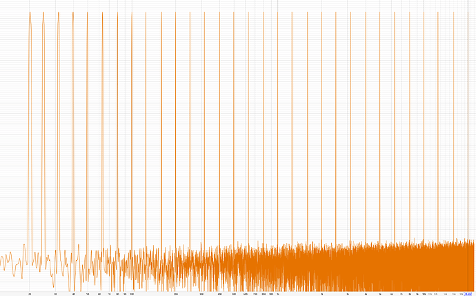

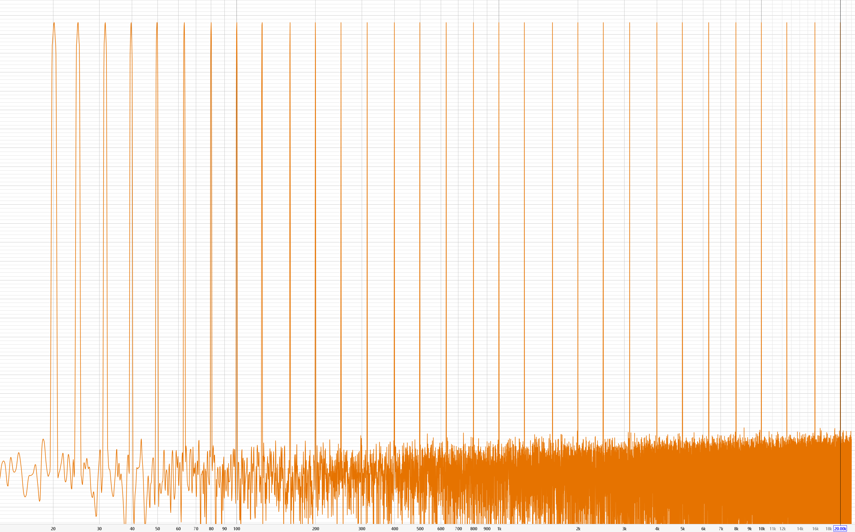

Finally, I checked twolame. Yes, it is MP2, but you mentioned that it could become a source of the new DCC encoder. My tests show that something strange is going on with this encoder:
Red - twolame, Blue - DCC951
Not only it exhibits the most noise, but it also for some reason reduces the output by 5dB, which is not great.
