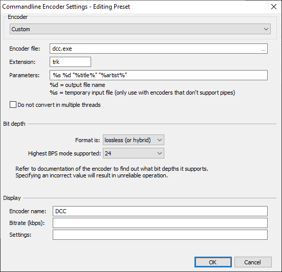

Unfortunately, Foobar cannot run .bat files directly, so I had to create an exe file using a standard bat to exe converter. Now what’s left is to add a new custom converter in Foobar2000. Click to see a screenshot.
The encoder file name should point to the exe file generated from a .bat. The extension is trk, and the parameters passed on to an encoder are the following:
%s %d “%title%” “%artist%”
The rest of the settings are up to you, I decided to give the resulting trk files short names (track numbers). I just tested the output with DCC Studio and it is fully working, with artist and track titles displayed properly. With this tweak I can generate DCC files from any music I have, regardless of the format, in one click.

Thanks for the welcome, and here is a screenshot with Foobar settings.

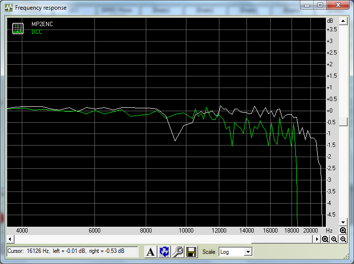

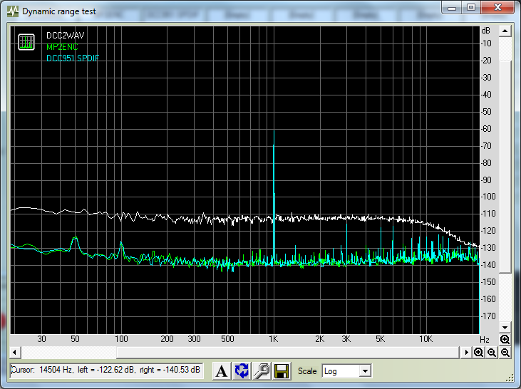

One additional observation. MP2ENC properly processes 24bit WAV files and preserves this extra data while encoding audio on DCC. I tested both DCC2WAV and MP2ENC, and also recorded RMAA test signal on a DCC951 deck via SPDIF. The graphs from RMAA below represent the output captured via the analog out of a DCC951 (unfortunately I cannot capture the output digitally)
DCC2WAV processes only 16 bit WAV files, and this is clearly seen when measuring dynamic range - the noise level is higher. MP2ENC and DCC951’s own recording indicate 18bit processing. But there is more. When testing the frequency range using a multitone signal (the hardest case for any lossy compression) I see that MP2ENC produces a different result, compared to DCC951’s own recording.
While DCC951 itself cuts off the high frequencies at 18.5Khz, the frequency response of MP2ENC extends beyond 21Khz. Same result (21Khz cutoff) is shown when using DCC2WAV. Apparently, using computer encoding offers somewhat (most likely not audible) better quality, or at least a more recent compression algorithm, compared to recording on a DCC951.
Thanks for those graphs. Interesting!
mp2enc uses 32 bit floating point internally so your observations are correct: It handles 24 bit sample files correctly and (probably because it uses a more modern acoustic model) generates less noise and better sound.
