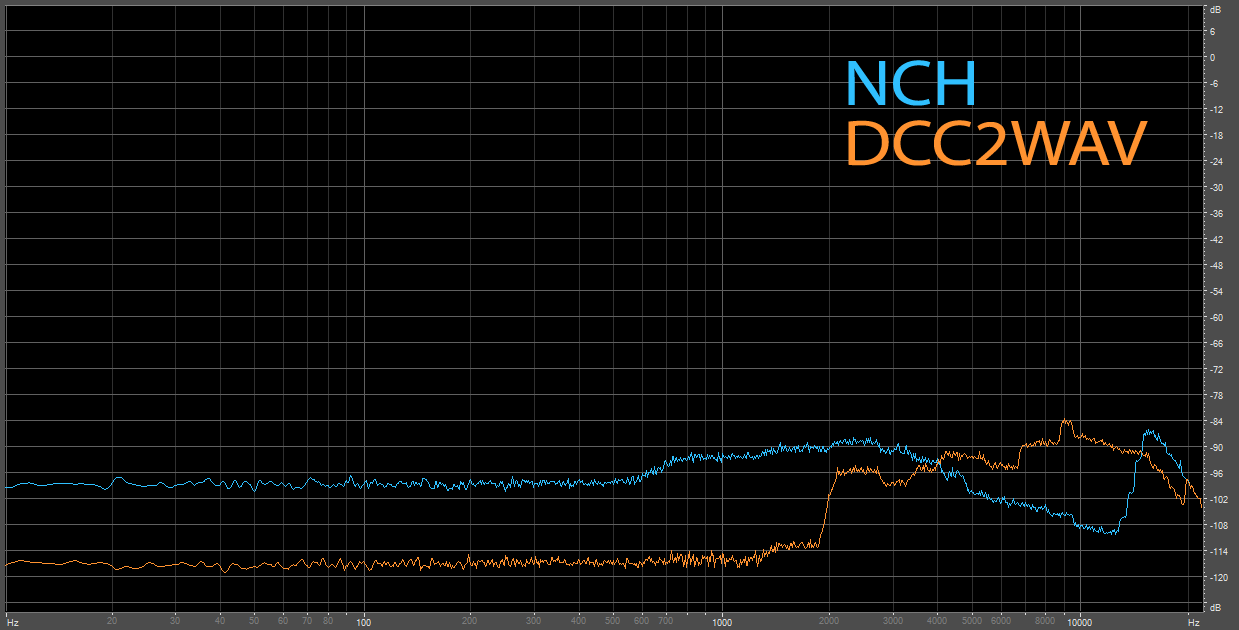

Hey, yeah, I did little research on NCH already. It clearly have better quality on trebles than DCC2WAV, but it’s overall bandwidth is hard limited to 14 kHz. DCC2WAV sacrifices treble quality to some “okay” point in order to achieve full bandwidth 20+ kHz encoding, still remaining bass/mid range quality superior to others. The listening: a fellow audiophile loved it, and I trust him; my hearing is not as good.
Masking (minus over the source signal), lower is better:
Interesting! NCH must be using a more modern psycho-acoustic algorithm. I’m guessing DCC2WAV uses the algorithm described in the DCC standard of course.
We can have that verified for sure.
