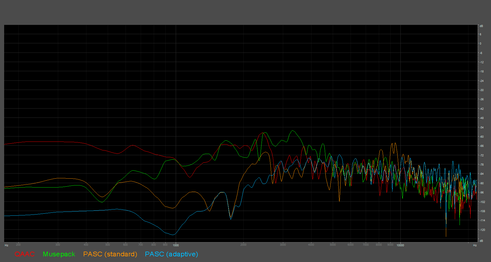

Distortion comparison between PASC, QAAC and Musepack:

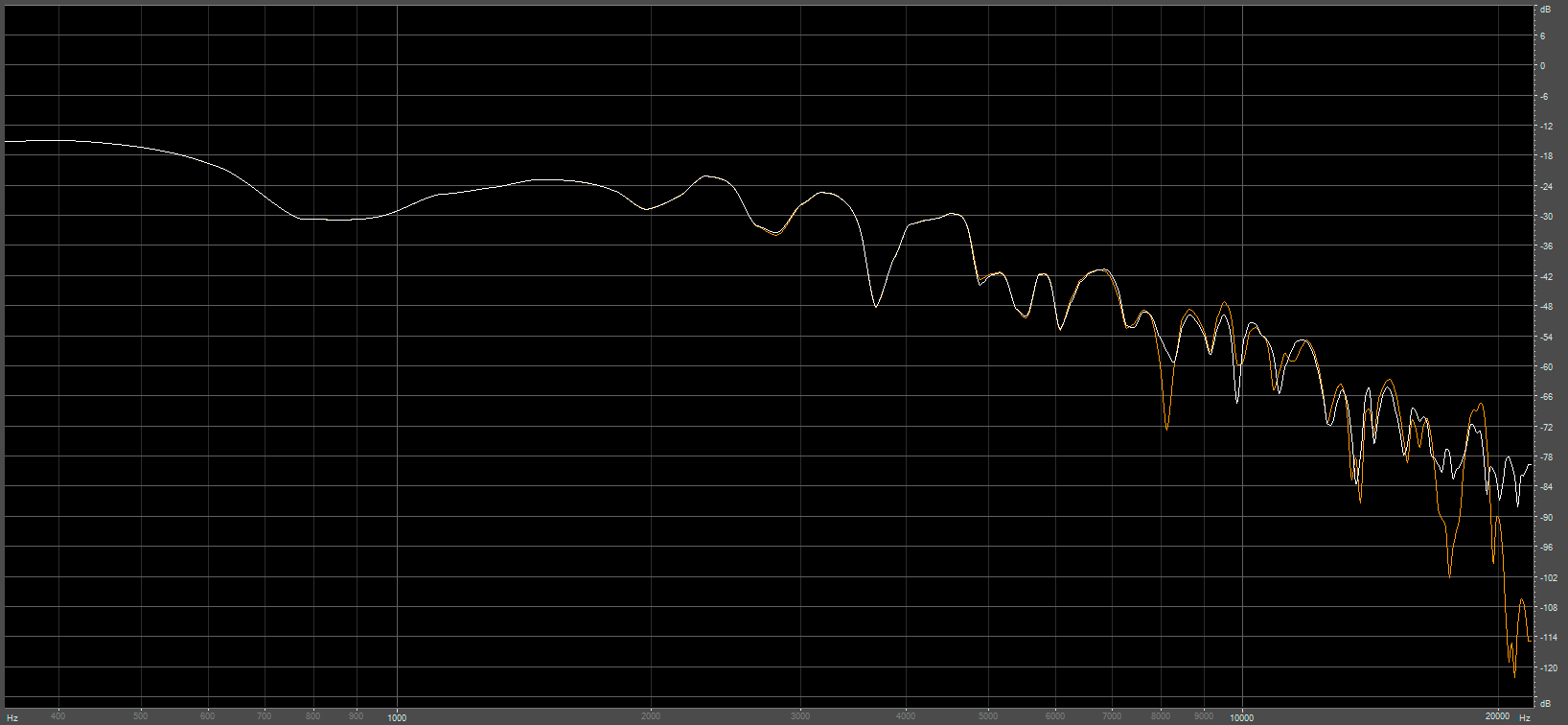

Frequency response comparison between PASC (std mode) and the source wave:

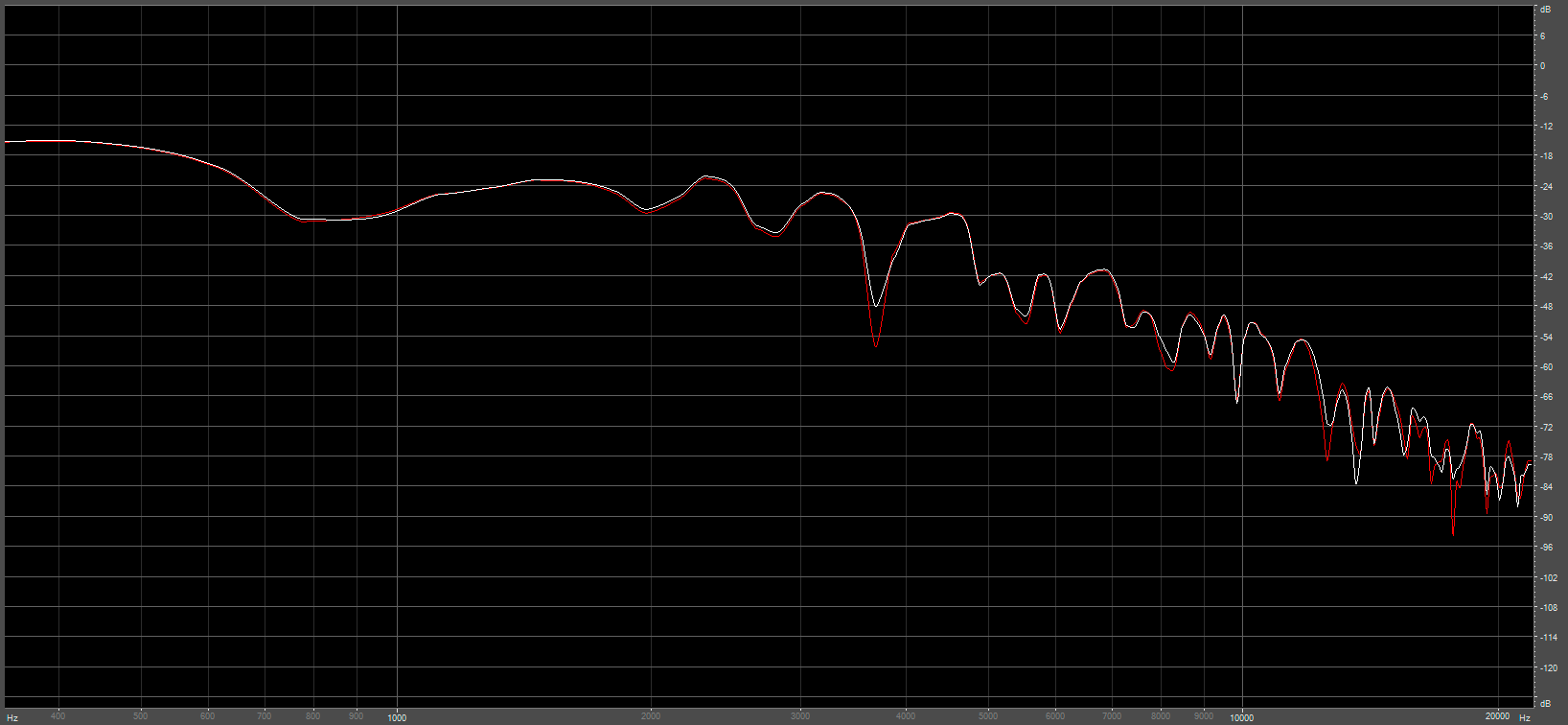

Frequency response comparison - PASC (adaptive mode):

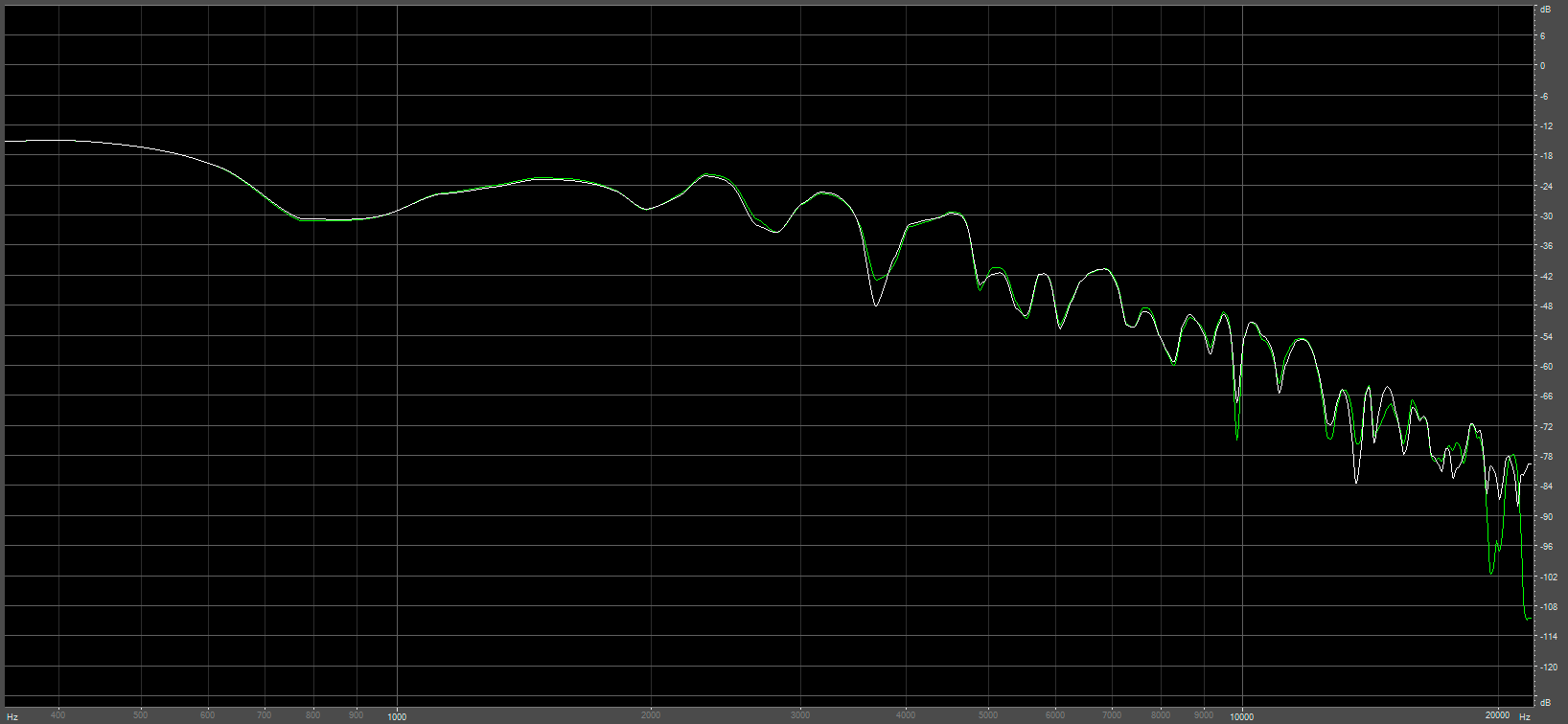

Frequency response comparison - Musepack Q10:

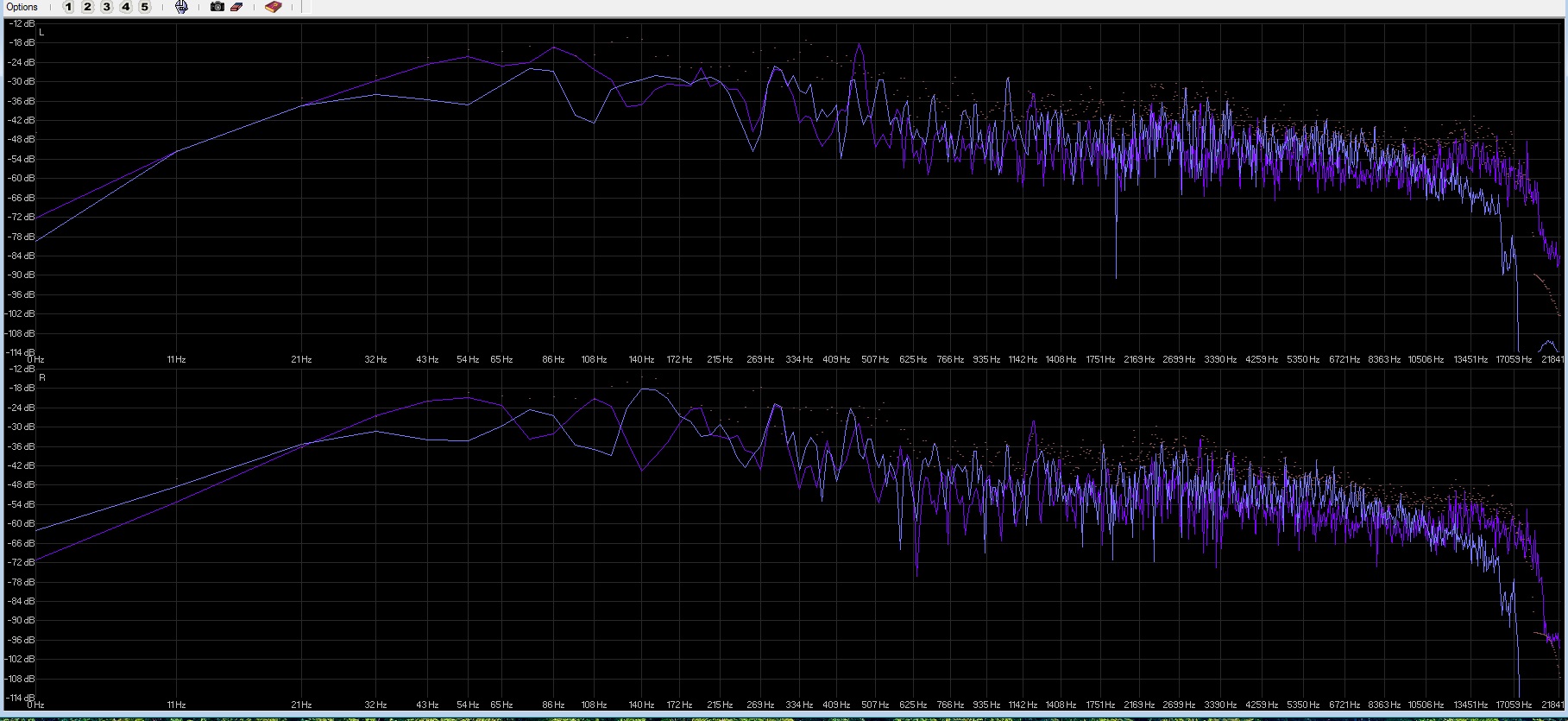

    i observe the same frequency spectrum “shape” (with FFT of course), with a cut of at 14500Hz in quiet level, and 17500hz at higher level, with sometimes jump to 20 000hz, its really strange in fact if i had to compare to MP3 320kbps frequency spectrum.
  2. For me , the difference between wav and PASC (or MP 2) is clearly audible in high frequencies, that was not the case with MP3 320kbps (maybe lower bitrates but i didnt check).
here are two screenshot of WAV versus PASC:
on the last screenshot we can see the jump in high frequencies !!
The MP2 encoder works exactly the same way !!
