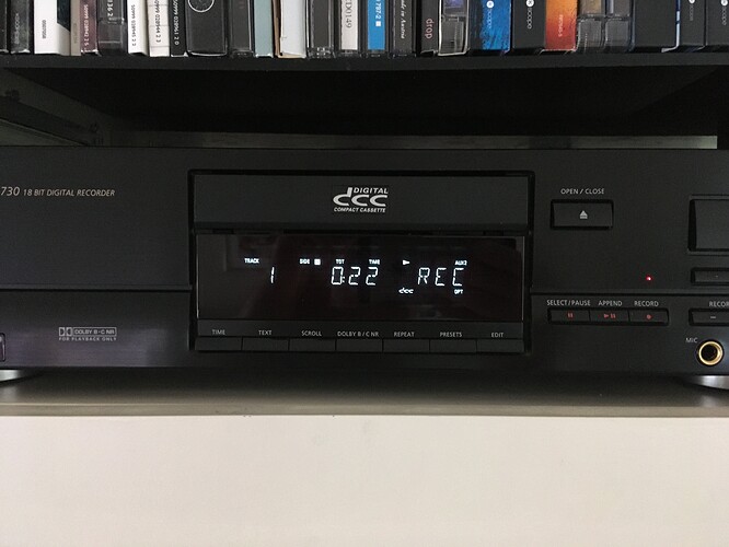

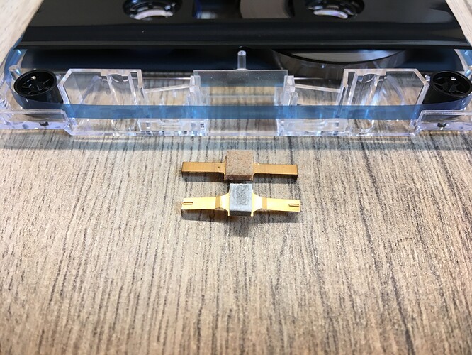

As is known, first generation tapes can make beeping noises, this is a felt pad isseu.
If you want tot record, is’t impossible.

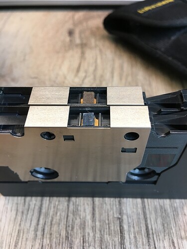

So I tested today t swop the felt pad from a 2nd gen. in a 1st Gen DCC.
and with succes ![]()

So basically you cut it loose, and then installed another felt pad?
What we need is a fresh supply of new working felt pads.
Yes that what I did.
And new felt pad would be welkom.
In this case I wanted to safe the 45min 1st gen, by using a old one from a broken tape.

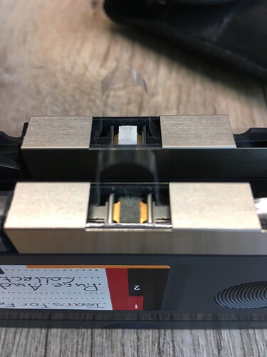

here some dcc exaples:
Are these all examples from DCC? Not ACC?
I see that there is a lot of difference in the thickness of the felt. So that has to be addressed.
I think that the width and height can be standardised.
-The height of the felt pad should cover the tape from top to bottom, or from one end to the other so to say. Regardless of the metal piece used. The tape is 1/8 inch, that is 3,18mm. So that would be around 5-6mm.
-The width should be wide enough to cover the curve of the head a little. So around 4 mm should do it.
But, the thickness is indeed an issue.
Today testing with replacing the felt pad. The results were, as to say, disappointing.
This is indeed a very delicate business with tiny margins. Besides the dimension, even the stiffness and the smoothness and the slipperyness of the felt seem to matter.
Obviously the orginal design was well thought out. But we knew that already ![]()

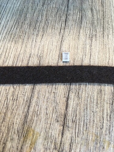

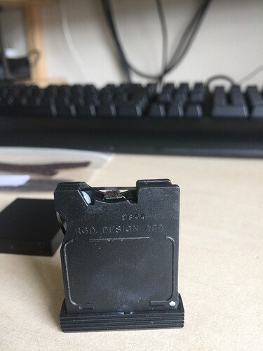

I have been replacing felt pad on Sinclair Microdrive cartridges with success. I have be cutting the small pads from strips of felt designed for 8 track cartridges. These come with an adhesive strip on the back, so makes installation easier. Not sure what thickness the felt is but I will check.
@bagpuss22 do you have some picture to share, thanks
@bagpuss22 Thanks!
Do believe that this can be de way forward, https://www.8trackavenue.com/
Let me see how to get some samples in The Netherlands
@Jorn If you have any issues getting samples let me know and I can send some, of the strip I use, from the UK.

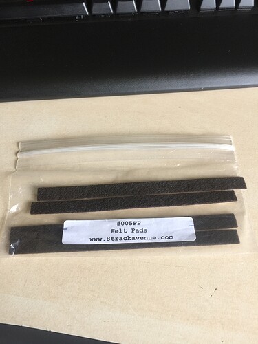

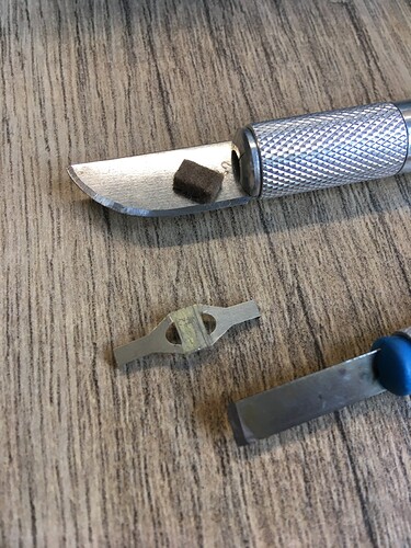

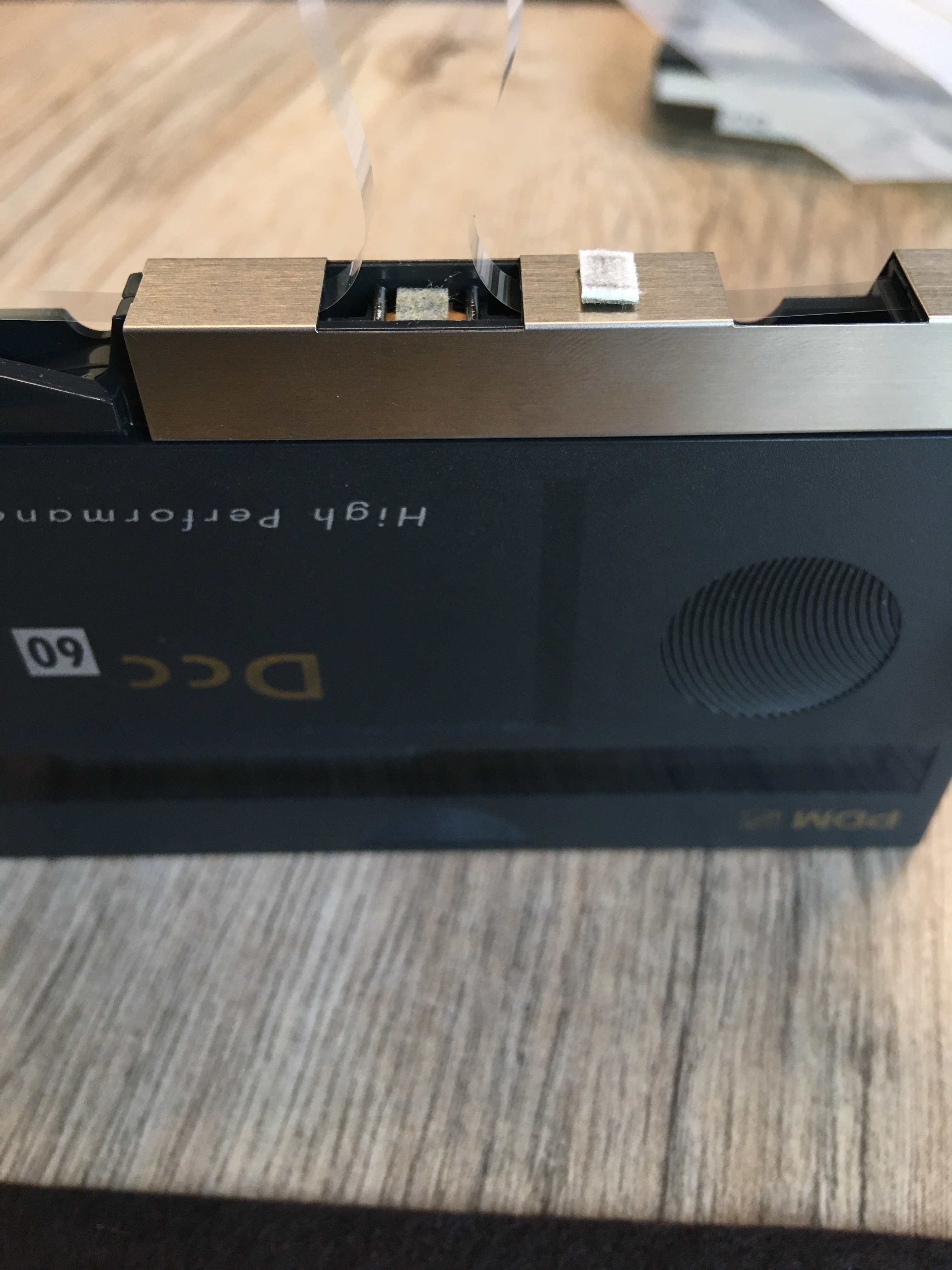

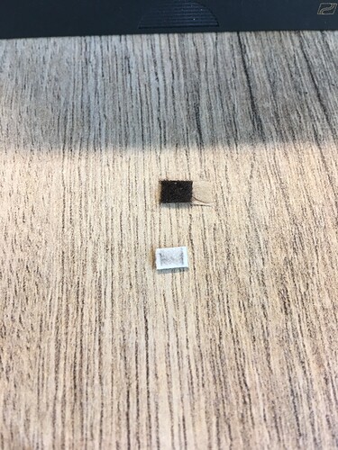

First of all thanks to @bagpuss22 sending the 8track felt pads to us in the DCCmuseum EU/Sub departement.
These felt pads are in a strip which make it possible to cut them on the right size.

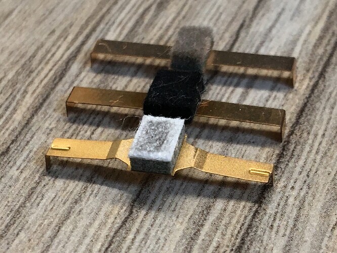

But the hieght is not the same, so I came to the following solution, see pictures and picture name:
11_cut off the top part
12_Top part have aproxx same hieght of the new felt pad
13_cut off to same size

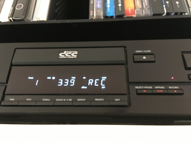

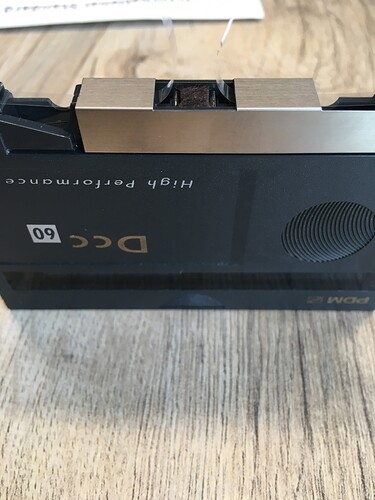

14_Add the felt pad with a tweezer
15_Recording
16_Succes full playback

@bagpuss22 is this the link?
https://www.8trackavenue.com/product-page/replacement-cassette-felt-pads-1
Hi Ralf,
Yes, those look like the strips I ordered. The site has changed and they used to be referenced as #005FP
