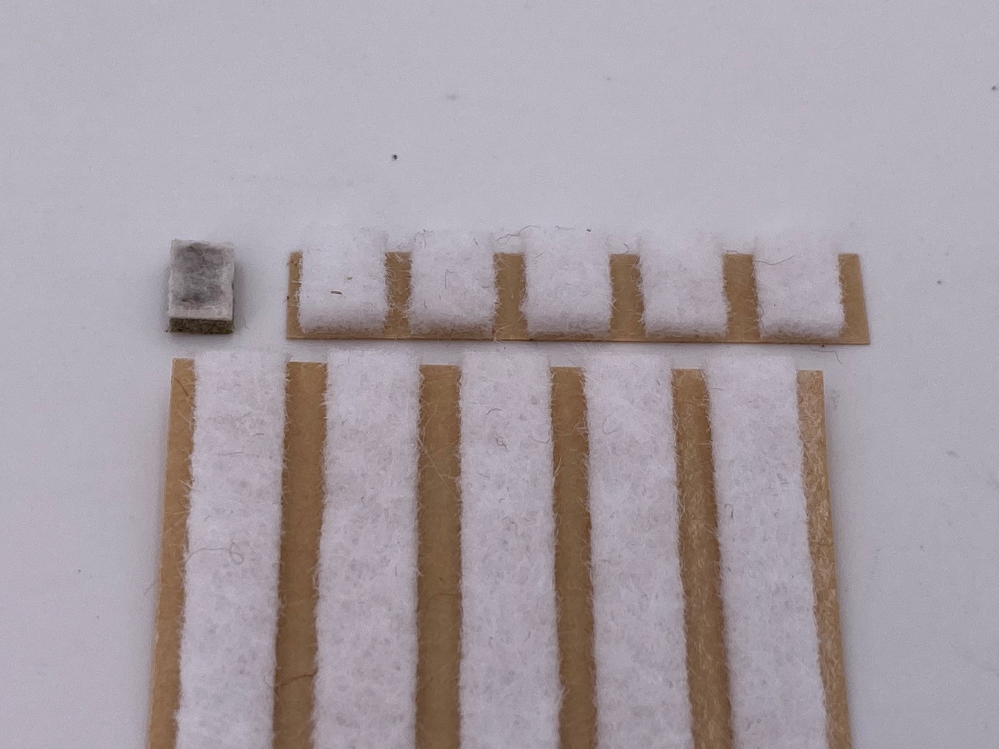

I have ordered them in the pre-cut version and regular version.
I will send an update after arrival.
Received the felt pads today. I had ordered them in white as a strip, but also pre-cut.
I used the pre-cut ones first. Unlike @jorn version, these seem to be ok thickness wise.

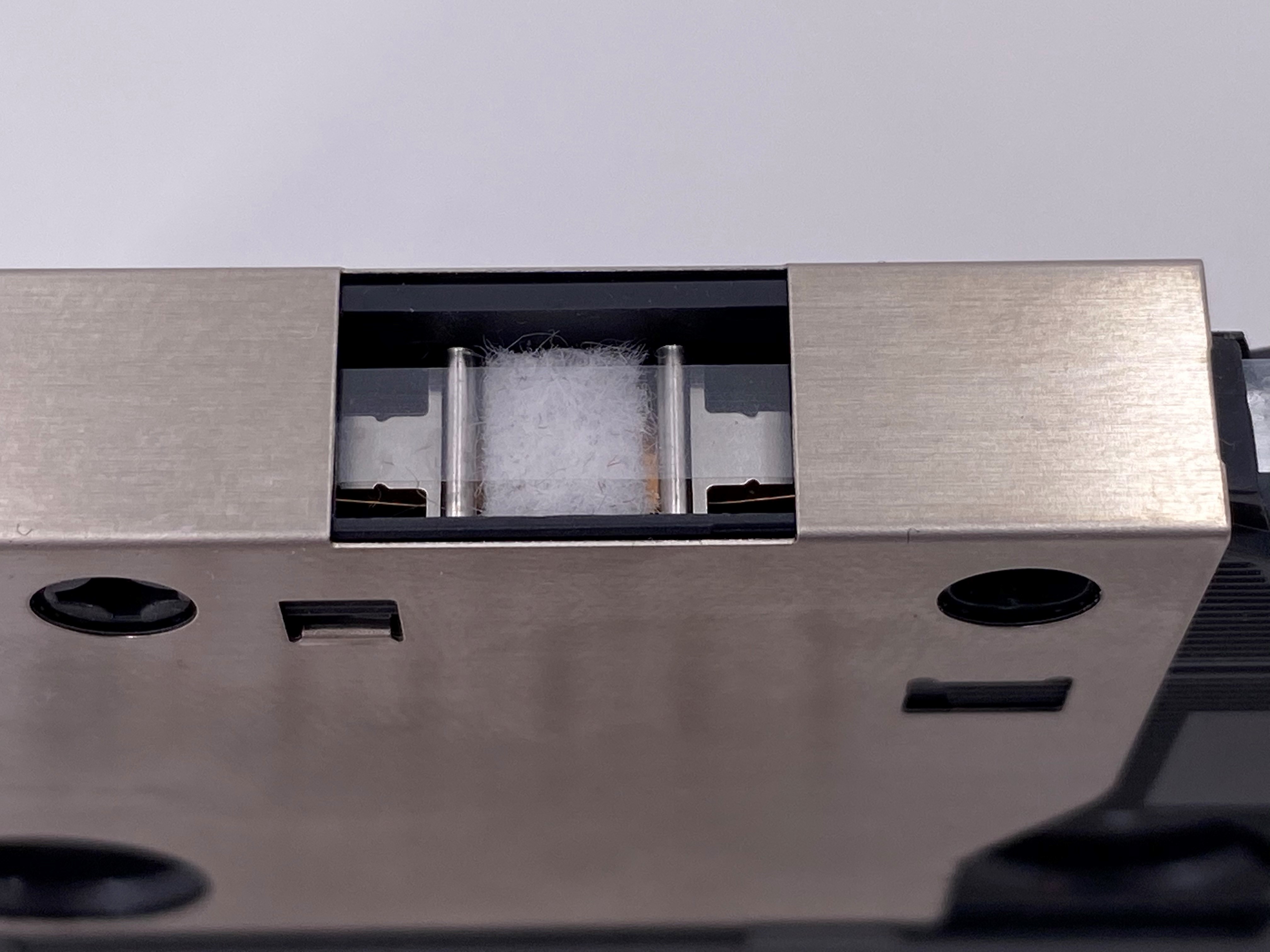

After a straight swap, it worked immediately. Thought the new pad looks a bit scary in close up with all the hairs sticking out, it sort of has the same effect cleaning/roughing the old and dirty felt pad.
Recording and playback worked fine on the very first tape that suffered previously from the stick slip effect. Left top on the first picture is the old pad.
That does indeed looks scary! You would never think beforehand that it’s gonna work, but hey, the result is what counts! :stuck_out_tongue_winking_eye:

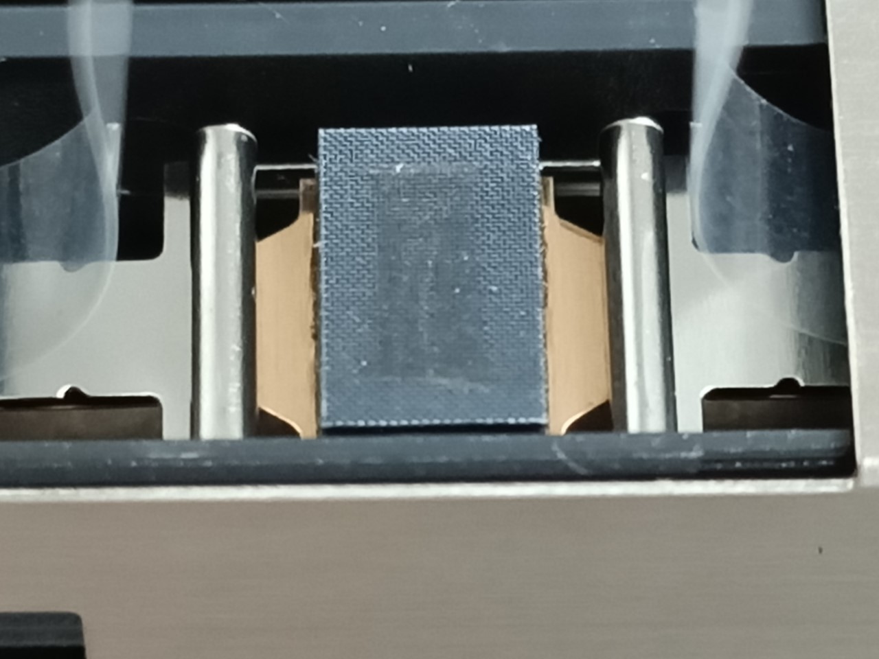

I found this felt pad on a 1st generation Philips DCC90 minutes. Is it a rare example of a felt pad or is it maybe not original?
Looks like a BASF tape. They have this type of felt pad.
@Jurjen and @drdcc, I can confirm that this is a Basf felt pad.
So if it is a Philips there must be a swop in production.
