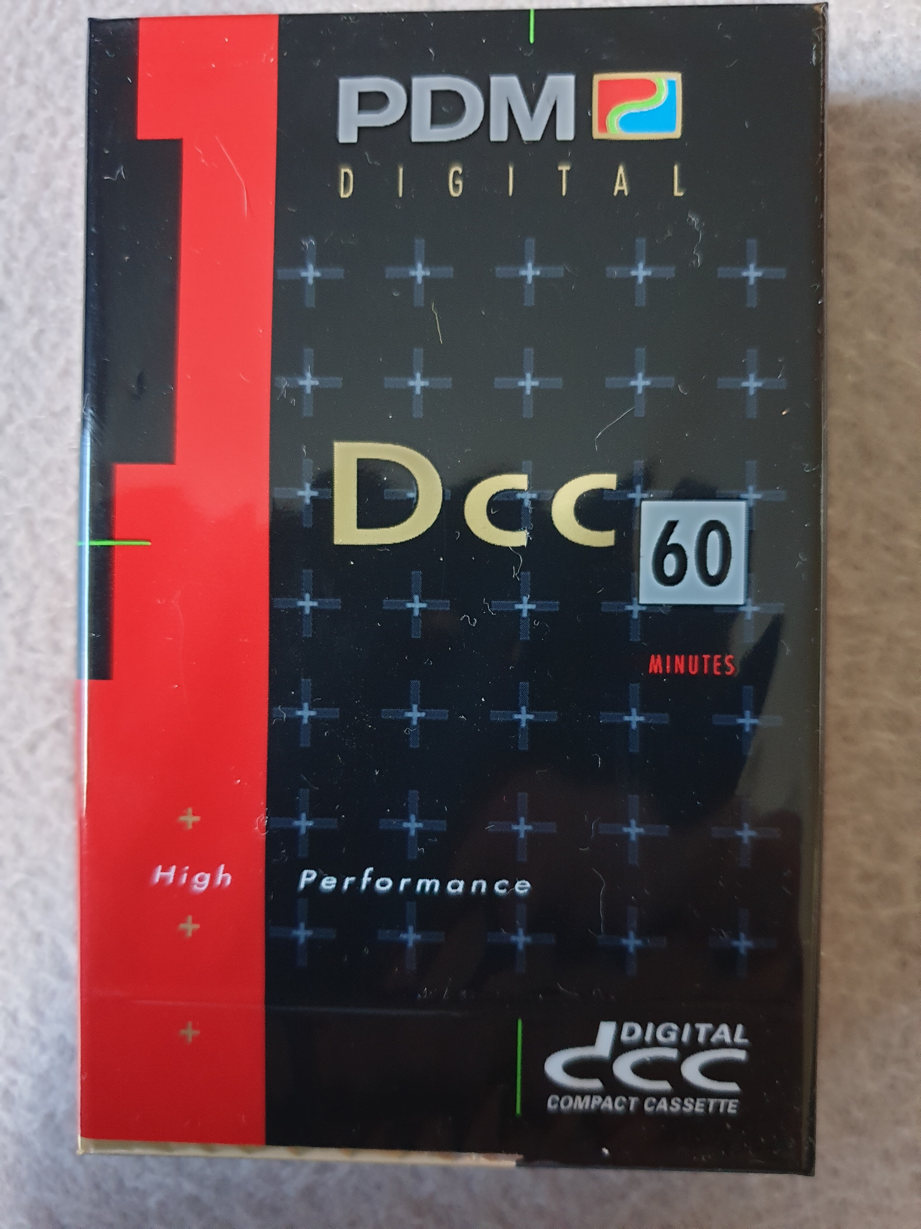

PDM cassette need a new felt pad
I know that the first generation Philips cassetes need new felt pads and I experienced that myself.
But now I found out that also the PDM cassettes make that anoying squaking sound. Are there people who have this problem with PDM?
Going to change the felt pads also for the PDM’s.
Are there more type cassettes known for the squeaking problem?
