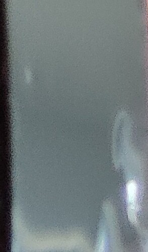

I got a couple of BASF Digital Maxima 90 and FUJI DCC-D90 with a recorder. All BASF were used, all FUJI unwrapped but unused, which could already be a sign that the previous owner was unhappy with them. Tried to record to the FUJI but dropouts every couple of seconds on all tapes. I was desperate to fix it, tried to use a vaccum cleaner on one of them, you see where this is going. After the inevitable happenend, I opened it up and took a close look at the tape still on the wheel, dents through the whole tape that cause the dropouts and on some peeling layer peeling off at the edge.
How about being more explicit about the concrete problems on the website? The felt thing on 1st gen Philips blanks is annoying, but can be fixed 100% of the time, this can’t be fixed.

But it contained a literal dent through the whole tape as one reason for dropouts, that must have come from the factory and was maybe less of a problem when the tape was more flexible in the 90s.
I think you are looking in the “wrong” direction.
Over time the property of the tape changes and effect is different!
It is a mechanical and organic process.
