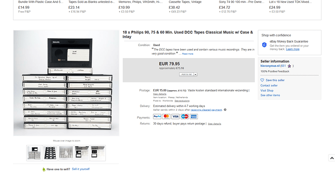

Having decided to use DCC as my main recording format I have bought quite a few NOS tapes which are 100% fine. I recently saw on ebay a batch of 18 used tapes which were sold as in good condition and at a good price. Unfortunately after recording on a couple of them I noticed quite a few dropouts in audio on playback. I’ve tried them in more than one machine but the result is the same. I haven’t tried any others yet but I’m a bit worried I may have wasted my money? Is there anything I can do?

I’m not sure what the return postage would cost, but your screenshot of the eBay listing says “30 days refund”, this may be worth a try.
Thanks @Max, I’ve just sent a return request to the seller. I guess it would be best to stick with nos tapes. Can you or @drdcc recommend a good seller for tapes?
