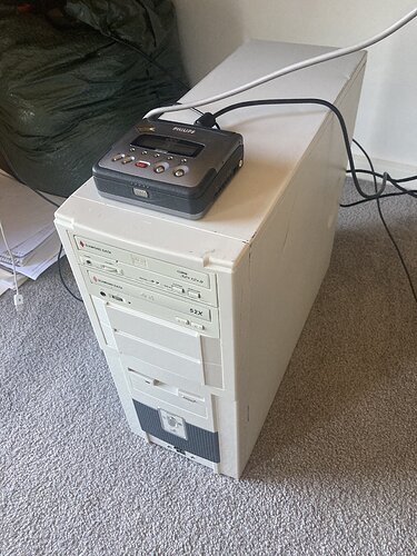

Today I picked up my Windows 98SE computer and so far so good: DCC-Studio and DCC2WAV are both running. I’ve already made a short test recording from DCC to HD and converted to WAV. Then ported the sample via USB stick to my Windows 10 computer and played the test recording. All very exciting stuff! As I’m writing, I’m uploading a complete album (RA from Utopia as it happens to be) and will try to convert to WAV (I gather from what I’ve read on this forum that you need patience with a capital P for DCC2WAV to do this, but frankly it doesn’t bother me too much…yet!) and see if I can get it to play on my A&K 70MkII.IMG_2639|666x500
Nice! Audio through the printer port! Now I’ve seen it all! ![]()
That is a full on retro looking PC, love it. You just need an enormous CRT monitor to complete the picture! ![]()

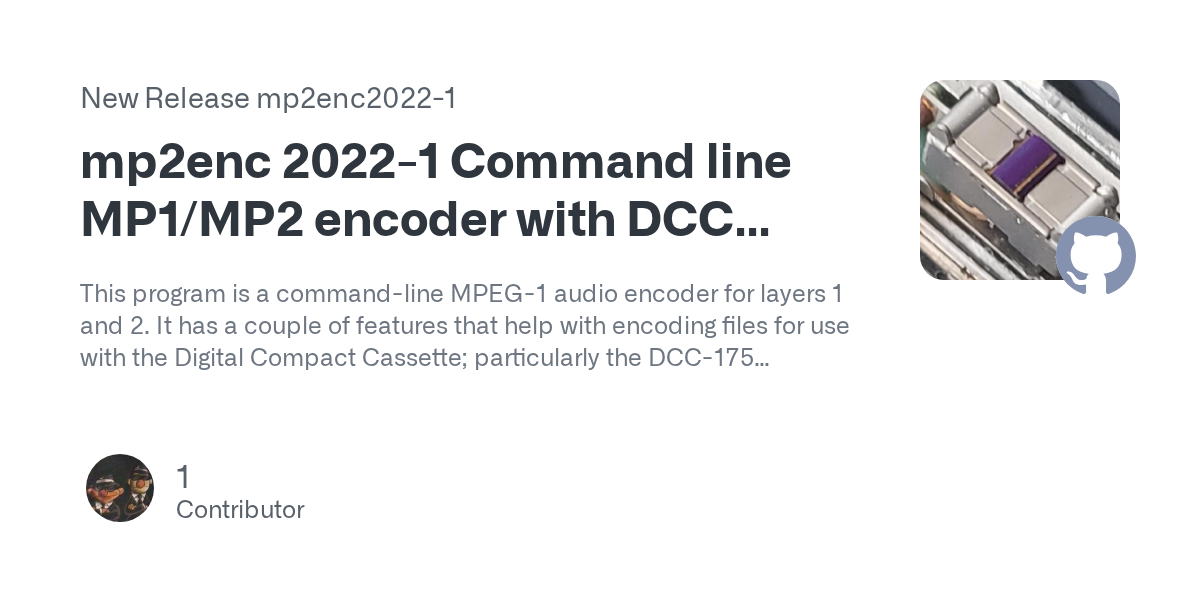

You can use MP2ENC to convert WAV to MP1 much faster, and then use DCCU to convert MP1 to MPP/TRK.
(I hope to integrate the two programs together one day with a friendly graphical user interface)

Vice versa, you can also use DCCU to convert an MP1 to MPP/LVL/TRK (the LVL will be empty because I haven’t figured out how to generate VU levels yet). And you can use MP2ENC to convert WAV to MP1. See links in a previous post.
MP2ENC is much faster than DCC2WAV, I think on my 300MHz Pentium 2 laptop it works faster than real-time. On my Windows 10 system it converts the files almost instantly.
