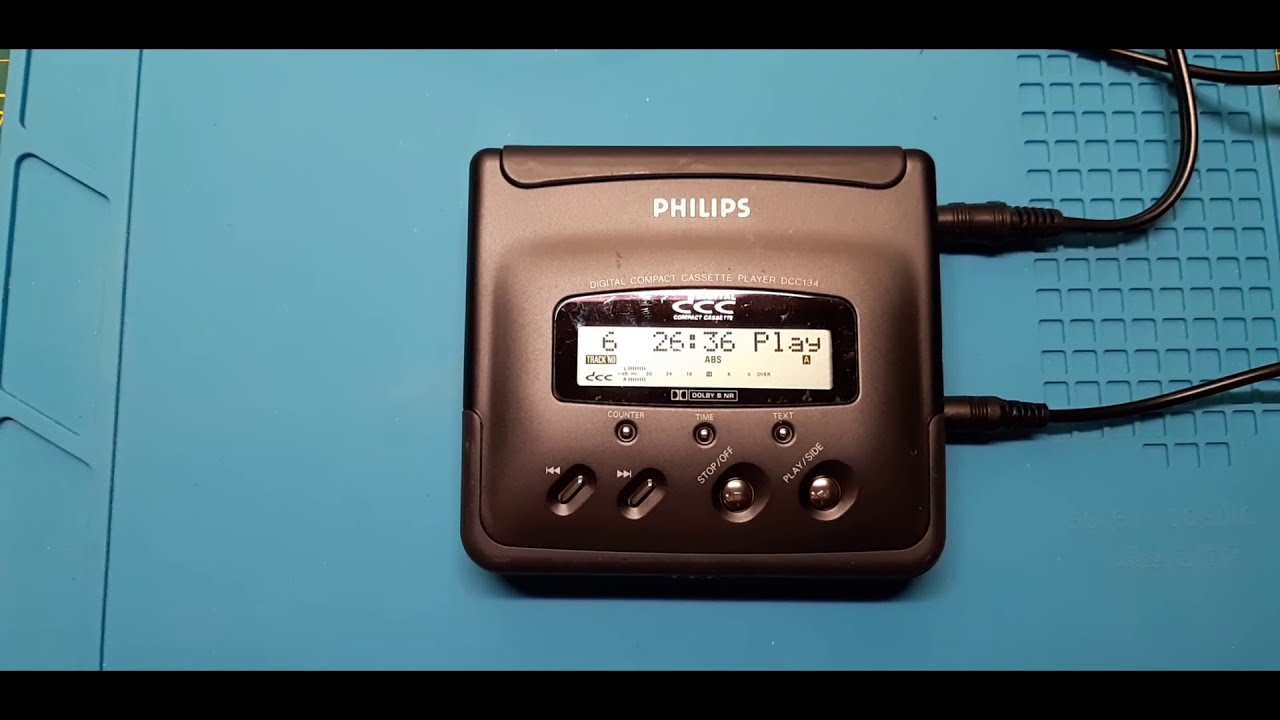

I have a weird noise coming from my newly acquired DCC134. See and hear it in this video:
It was dead when it arrived. I cleaned the tape path and replaced the worn out belt.
I have never before heard such a sound from a portable DCC.
Any suggestions?
Yes, it is, weird huh?
It is now playing fine without noise and good audio for over an hour.
It seems mainly a problem when you first start the player ‘cold’. After a while it might disappear. Need to test more I guess.

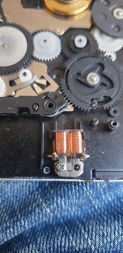

The heads on the 134 seem more problematic to me.

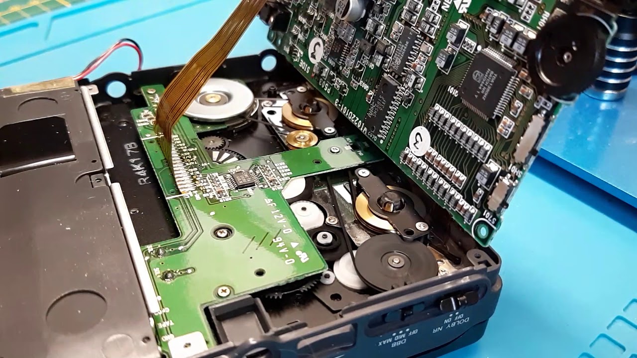

So I have three DCC134’s, all of which have some problem:
Player #1 has no audio on the left channel on the headphone output
Player #2 keeps reversing the tape A<->B constantly all the time
Player #3 the motor makes a scratching noise
Through a lot of testing I found out that it appears that all these problems originate from the main Circuit Board. Because when I exchange this board among the three machines the problem stays with the board.
So for instance I can make Player #1 produce a scratching noise from the motor by putting the top circuit board from #3 into #1. Et cetera.
So even with 3 malfunctioning DCC134’s I can not make 1 good one unfortunately. Pity.
