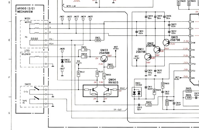

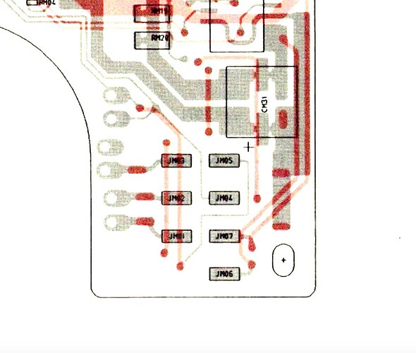

I should remove the pcb and put the player in rewinding mode with the solenoid. Than directly power the motor and see what the problem is. I think there should be something with the solenoid/cam gear/trigger lever. Or some old grease on the mechanics that keeps a gear out of position.
