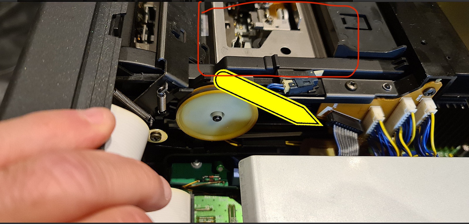

Most likely is the slider mechanism on the top left of the mechanism broken. This is a relatively easy fix as we have this part available.
You can check by opening the machine.

This might not be the plastic part as this only affects dcc.

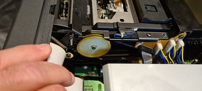

Check the belts
I Can see only the belt on the right from top, the belt for the open/close mechanism
There are more ?
On the right side there are two belts just for the tray.
Are there any video showing how to unmount and check ?
Start watching this at around 3 minutes. Design of your player is the same.
The other belt is hidden here.
No, it works fine only for normal cassette. For DCC it does not slide anymore the slider, thus the message. Check my older topic with the same problem:

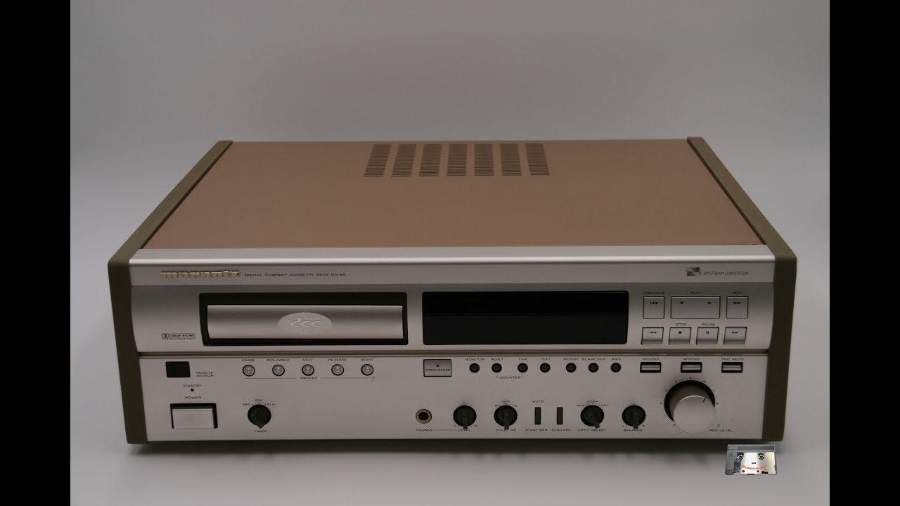

What I see, another DCC900 preproduction sample! You’re a lucky guy catched this unit!
Sorry for asking but how can you identify a preproduction sample?
Look at the color of boards and the shape of the top metal part of the tape drive mechanism and compare them to images of production units, you see the difference. From the other side Ralf had already posted video with a working preproduction sample on YouTube, you see then the similarities. I have such a unit too and see lot of similarities.
