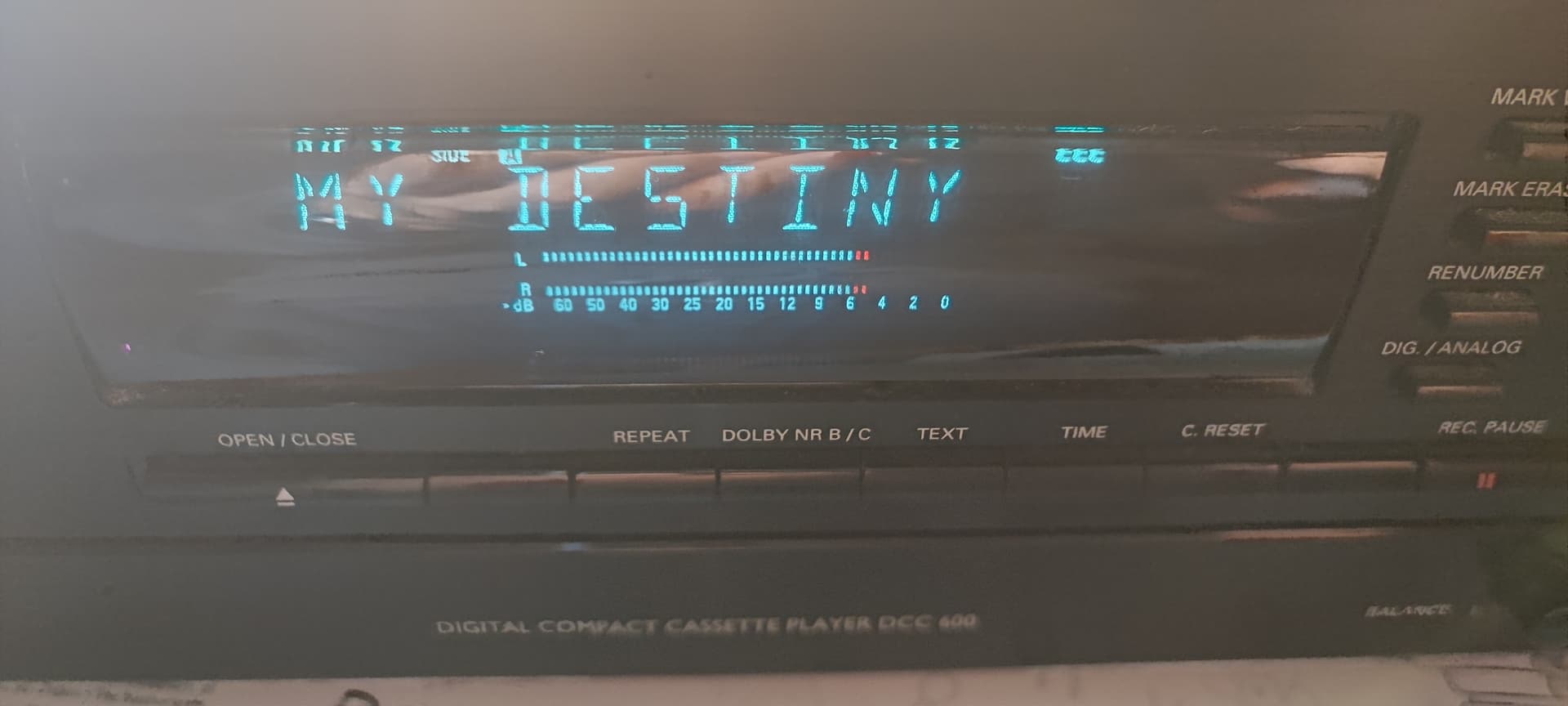

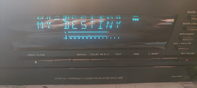

Unfortunately i still have issues with the player.
With original tapes the recorder plays well. Not all tapes but most of them.
It is not possible to record on a tape. You can record and you do see the VU meters but nothing is recorded. There is no sound (analogue tested only)
Is it possible that because of the issues with the loading mechanism the head is somewhat out of place and therefore has issues with the tape to be transported the right way along the head.
What else can i check?
I am a little bit lost and i think that this is not a common issue because this player has been treathed very rough and therefore has other issues than just belts and gear unfortunately.
I can’t find something in the service manual which tell me how to re-align the head.
If i move the head a little bit while playing a tape which is not working at all it sometimes gives sound for a fraction of a second so at least the head is not dead.
