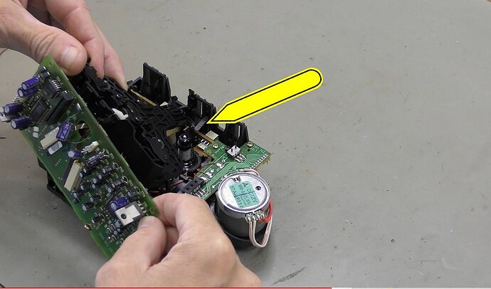

After watching the youtube video about the gear change about 10 times, I felt comfortable enough to have a go at repairing the device. I have disasembled the dcc 600 and noticed that somebody tried to repair the device in the past. I noticed that the front screw was missing and found it later on when I lifted the tray mechanism out of the chasis.
Findings
1 The clog did not seem broken.
2 The main belt was way to loose.
3 The pinchrollers seems to be fine
4 The head looks fine.
When I turned the mechanism upside down this felt out:
I cant seem to find a sensor that this lever should be triggering. (is that right?)
Any advice what to do next?
I guess changing the belts, clog and pinchrollers?

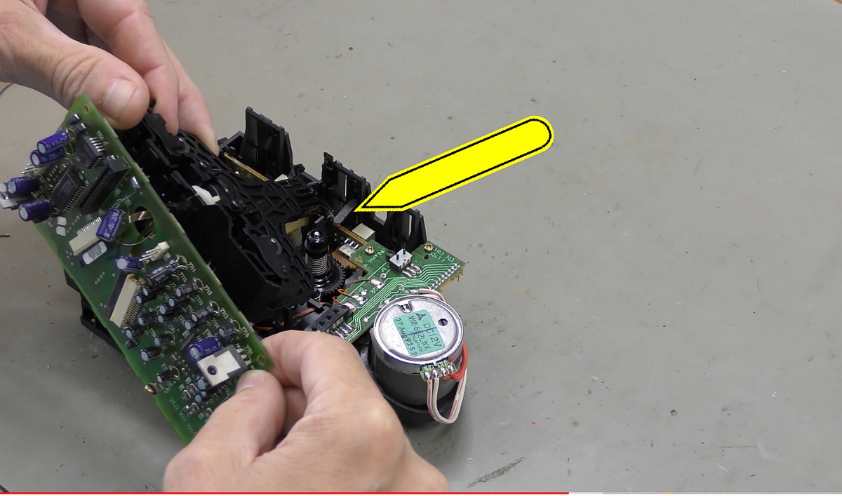

I believe this is the part mentioned in the video when you start mounting the mechanism back together.
The lever shown at 9.00 Might be broken.
Thank you for your illuminating photo Ralf. I’ve tried on the part you point to in the picture, but it won’t stay put. I assume it is broken. Can the DCC museum provide me with the necessary replacement parts? The device is open, so I might as well replace all maintenance-sensitive parts?
