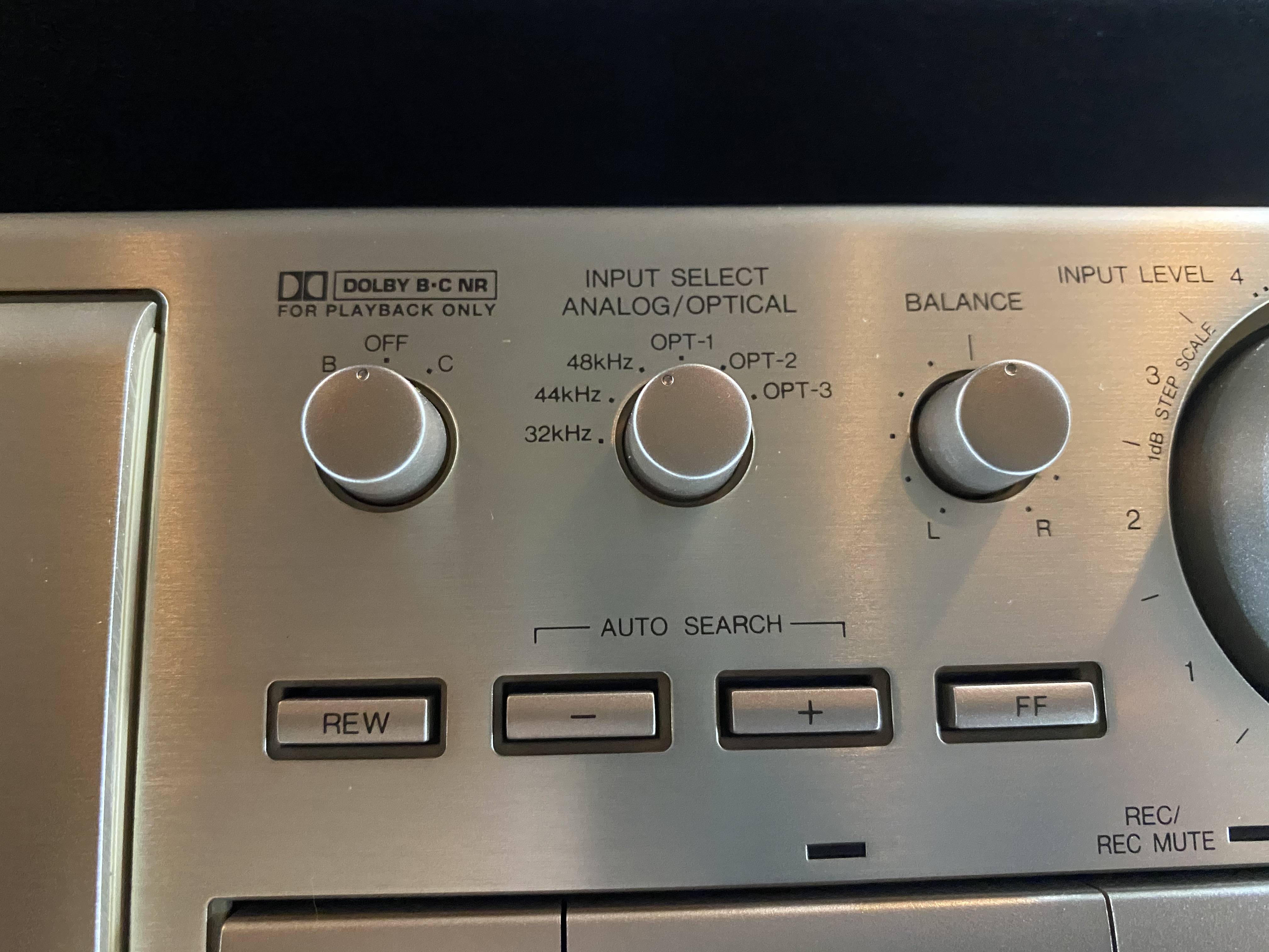

Great update. I was always convinced that digital in only allowed 44.1kHz 16bit and analog would allow switching to 48kHz 18 bit only.
When using the analog input, all DCC recorders record at 44.1 kHz only.
That is not exactly true.
The Victor for sure lets you select 48kHz On Analog
input
I didn’t know that, but that’s a special recorder :slight_smile:.
So there is at least one exception to the “rule”.
There is no reason for DCC recorder not to have analog inputs at other frequencies (I think the DCC spec mandates that recorders at least have 44.1). Internally, the PASC encoder works at all 3 frequencies; Philips just decided it wouldn’t be important enough for consumers to have more than one analog sample frequency, and perhaps different filters for each?
It wouldn’t take much to put a different ADC on the I2S bus to record from, either. Or an entire different device such as a microcontroller with I2S interface.
