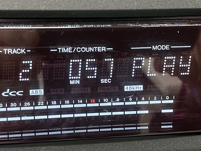

@Jac is correct. Feeding the correct signal into the spdif input on a 3rd gen will create a 48kHz signal and that could be 18bit depending on the source.
@Jorn and Krzyzstof have confirmed this.
We have tested Jac’s test solution for the dcc175 successfully this week. The breakthrough is that depending on the master, the next release done by the dccmuseum could be the very first commercial release on 48kHz 18 bit (or higher).``
