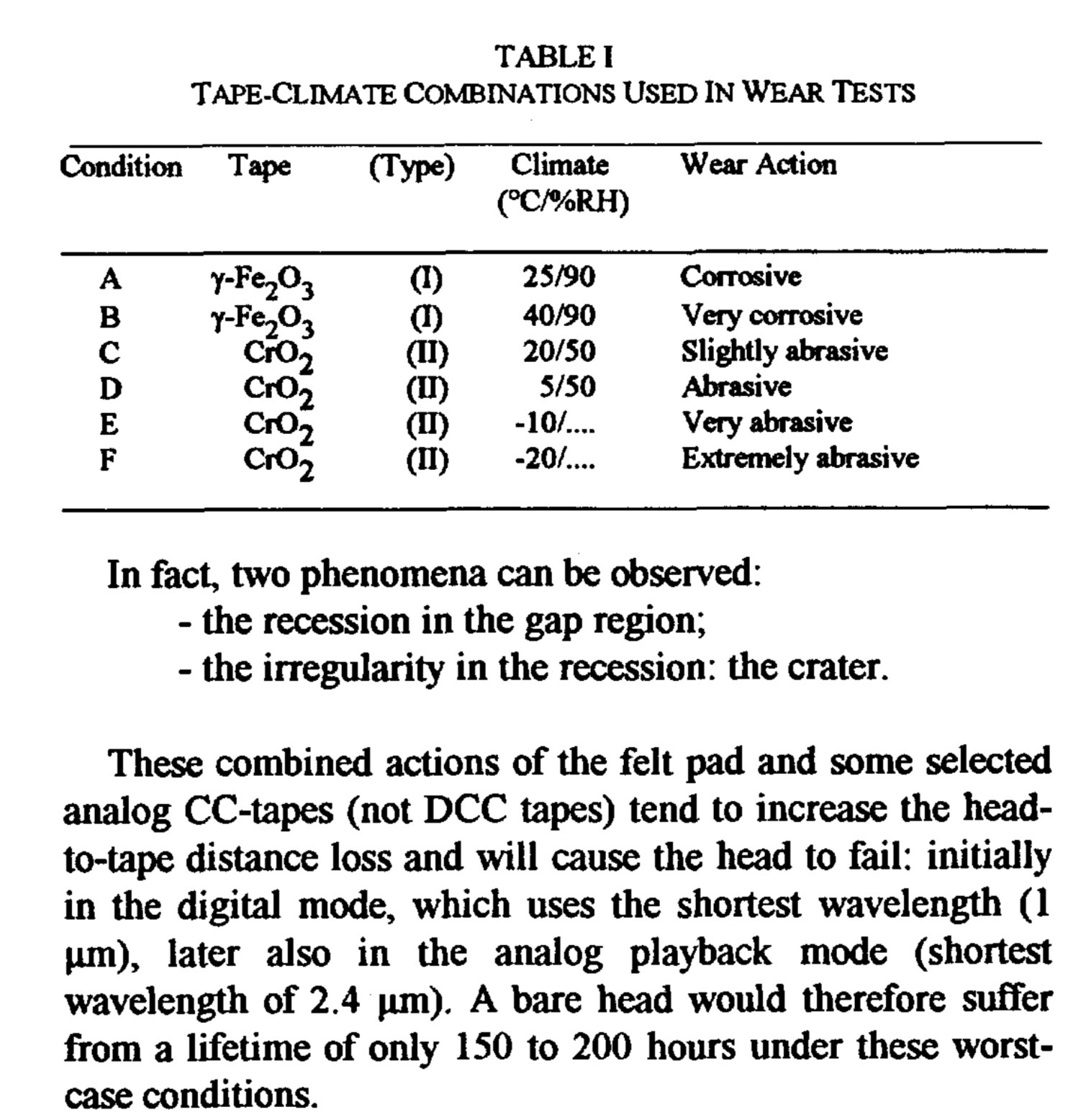

The abrasive and corrosive affect of regular analog tape still happening on the coated new thin film head was documented in 1993 and 1994 . Now that most heads are 30 years old it is even better to not be using any analog tape on DCC players.
Full Articles (they are not free unfortunately). We have added some highlight as a picture.
