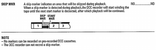

  1. There is the possibility of a SKIP marker.
    so you basically should probably replace the START marker of track 1 with a SKIP marker
    -unfortunately I have no experience with that. The screenshot comes from the manual of a DCC175 page 16.
