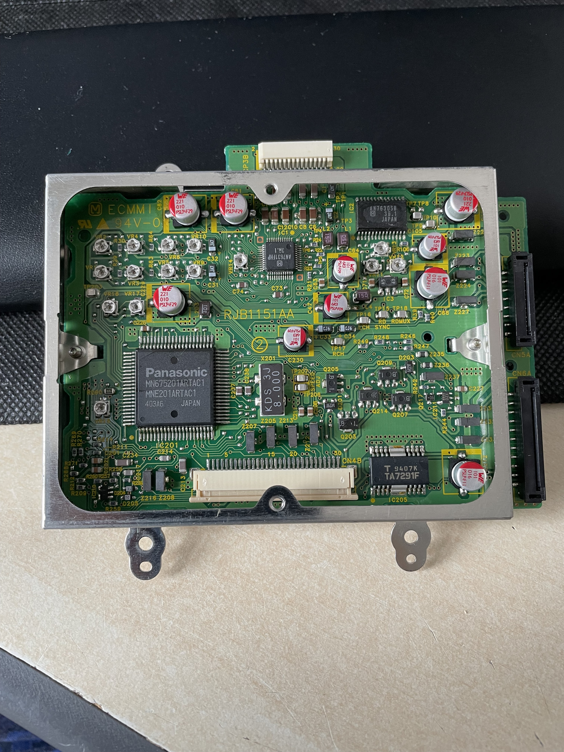

Polymer re-cap on the DC8 read/write board. A couple of “smelly” caps during removal of old ones and a good clean.

OK new gear, pinch rollers and the above read/write board installed. RS-DC8 is now working again and audio is good! BUT, unfortunately a BUT! Looks like the head is still missing the same 2 channels. No data or timing info displayed… E20000000110 displayed.
My next question is can this be recovered, no change after head clean. Ralph, will this need a head replacement and are they available?!
It looks like a new head might be needed. They are really hard to find at the moment.
You would need a donor 1st gen machine (900/DC10/82/92/2000) as those heads are the same.
It is best to verify that the head is ok before buying such machine / buy a restored one.

Also would have to get the rwed/write board matched to the head? Not sure how that would be done, maybe a trip to the DCC service centre would be needed…
You are using the service mode to test, so that is the best assessment.
The RW board recording current has to be matched indeed. Playback should work immediately with a donor head.
