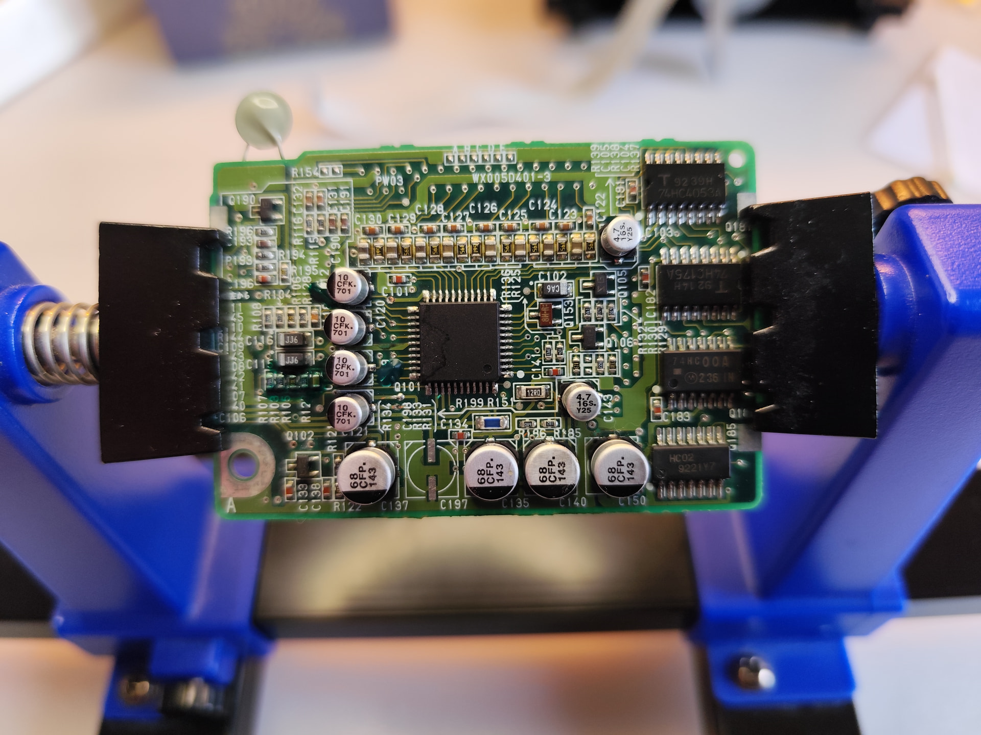

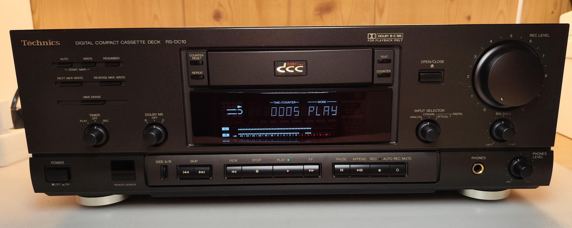

Hi. I have a Technics RS-DC10, in beautiful condition. It plays and records DCC cassettes, but has a problem with CC cassettes. One channel only plays, the other is silent. I replaced the capacitors with new ones, and still nothing. I should add that I have two of these DCC cassettes, and both have the same problems.

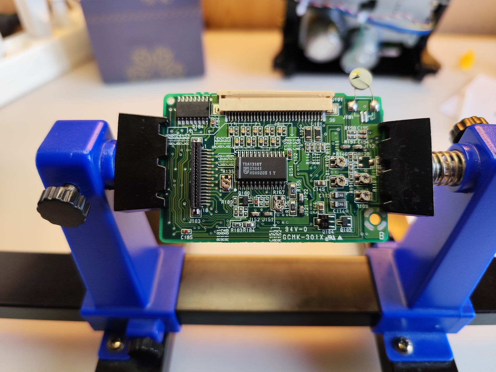

Most likely there is either still a problem in the Read-Write board or the head is defect.
We can rather quickly test the RW board problem as we have upgraded/new ones if you are interested. We no longer restore old RW boards .

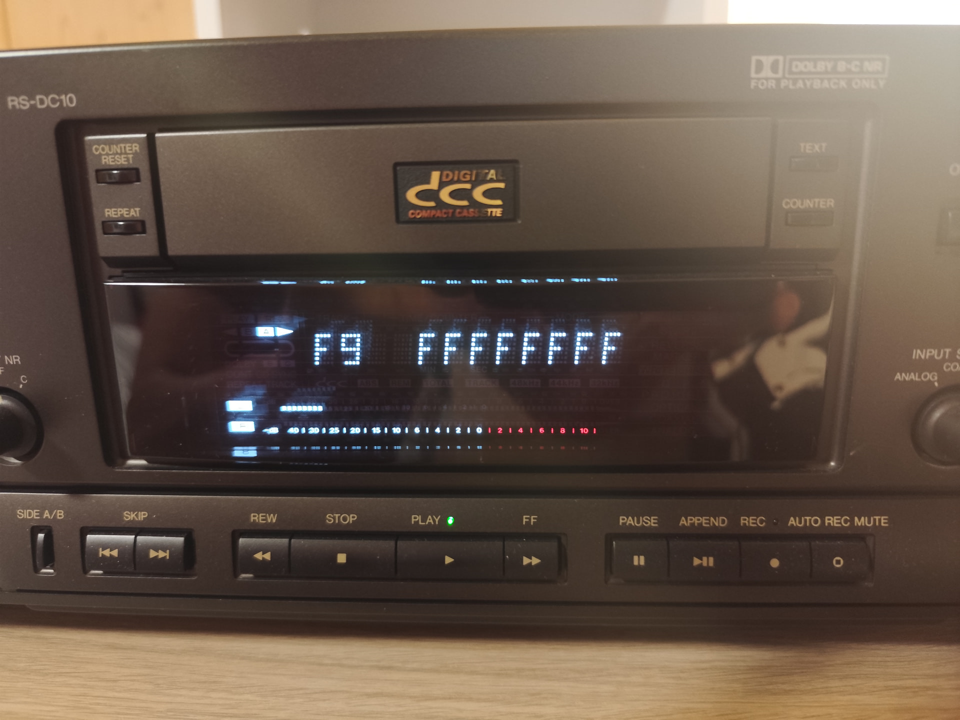

Service mode and error F9, CC cassette.
The DCC cassette has no errors.
This is just update reading digital forms, you would in theory need a much more involved procedure for CC as outlined in the service manual.

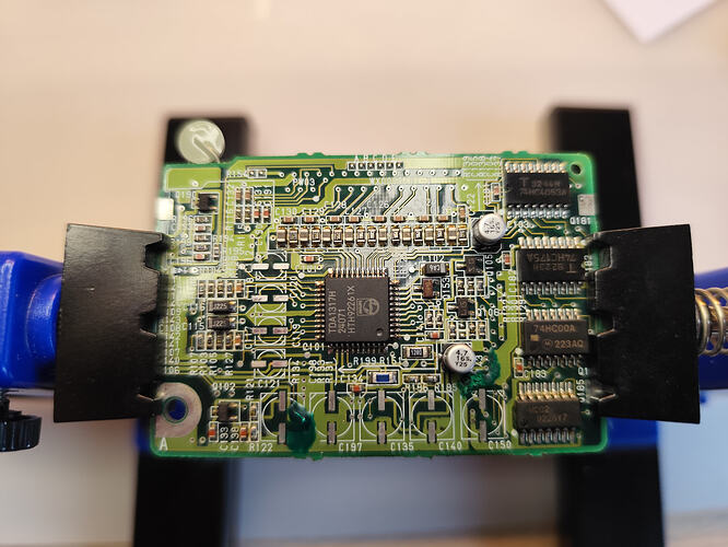

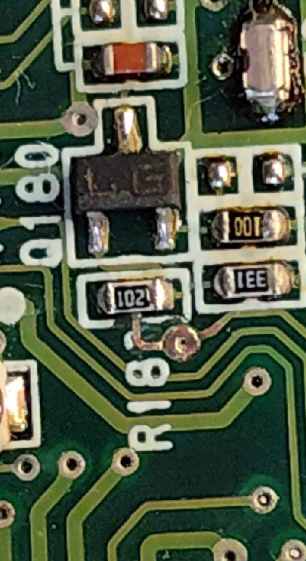

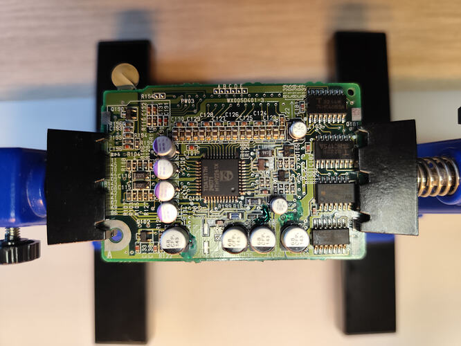

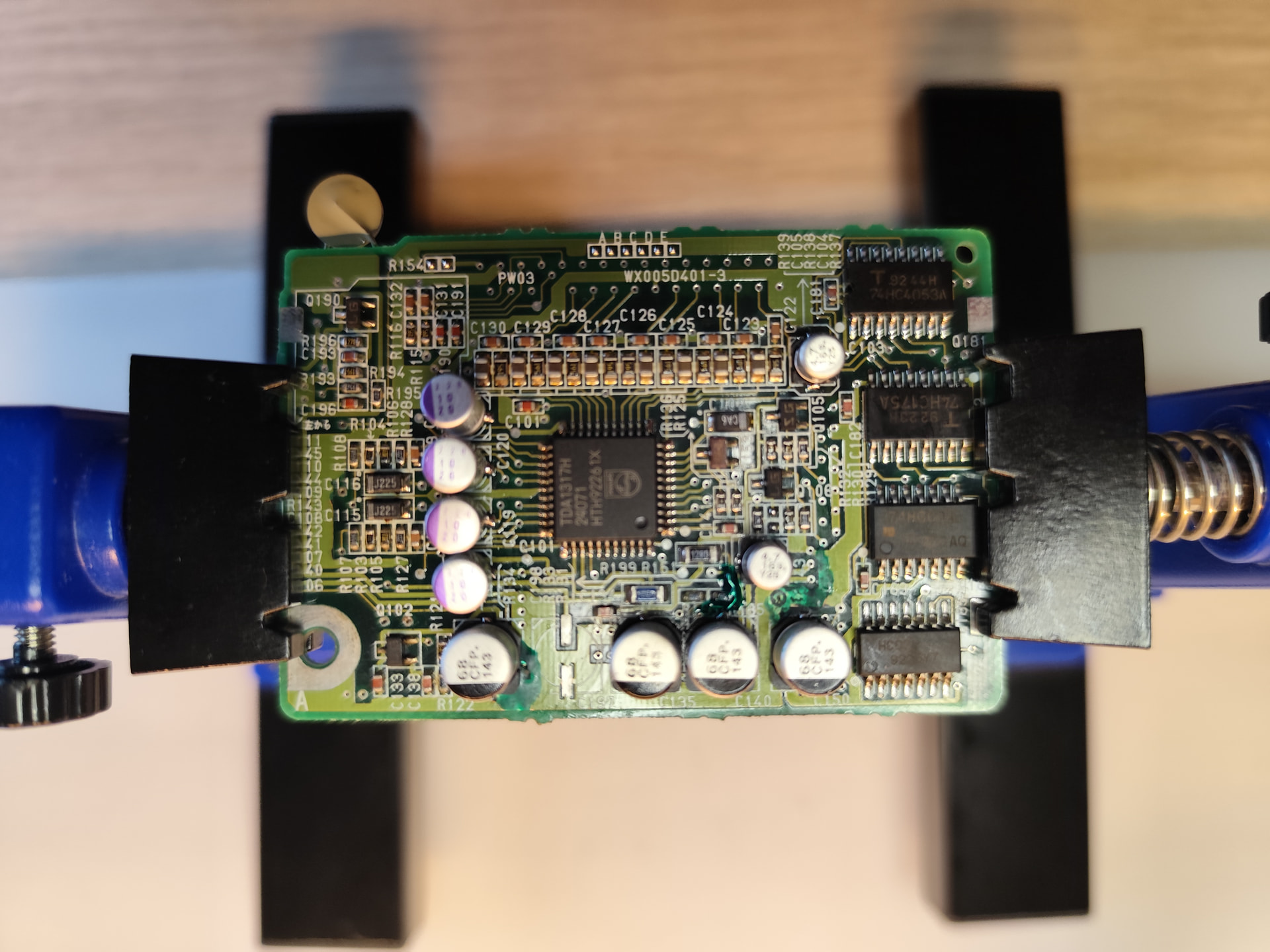

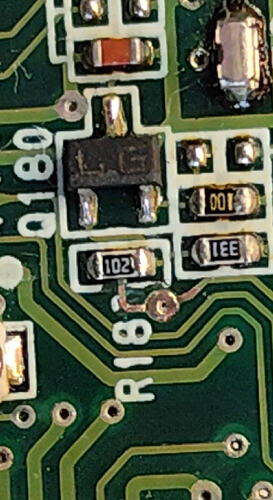

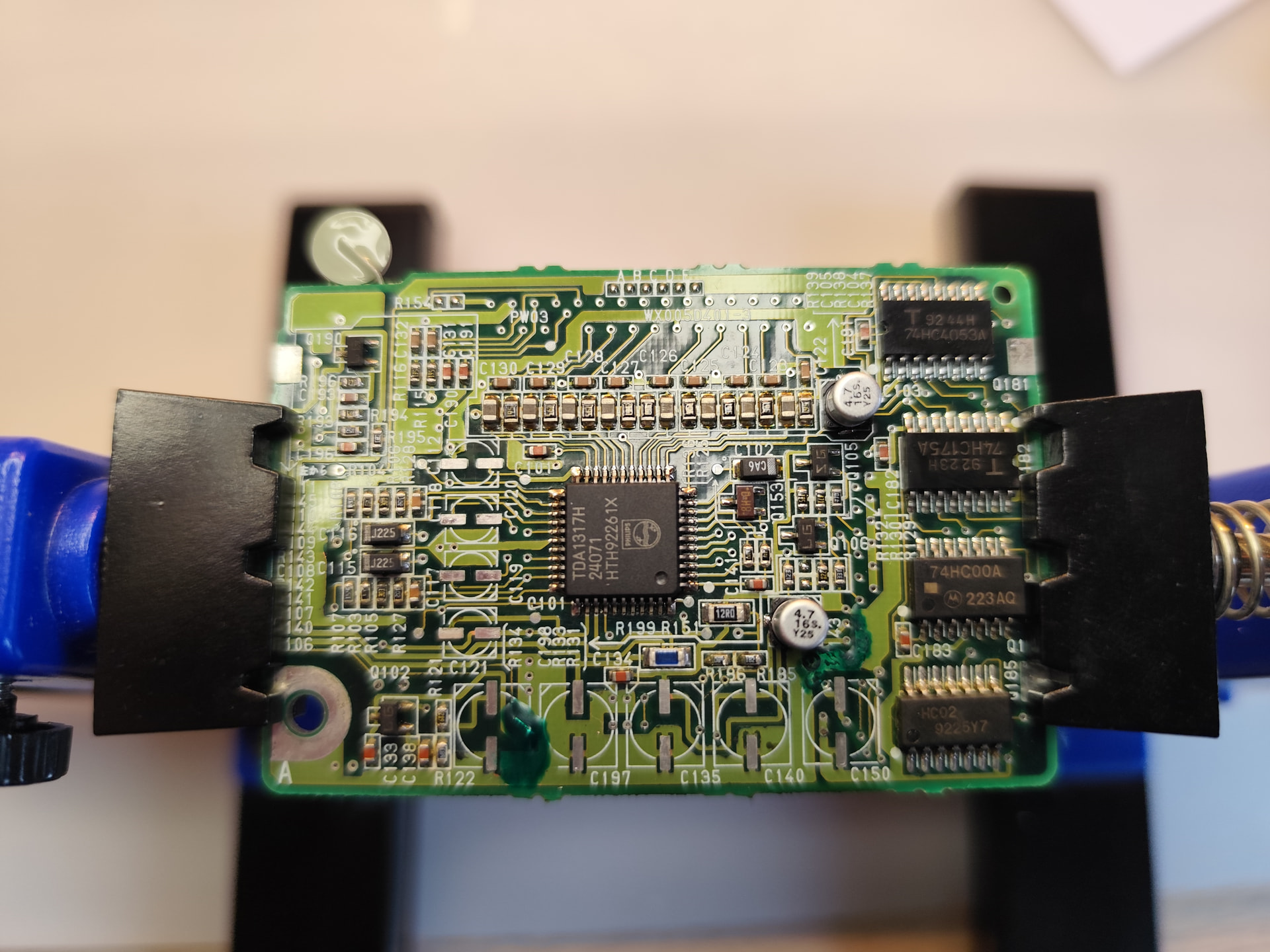

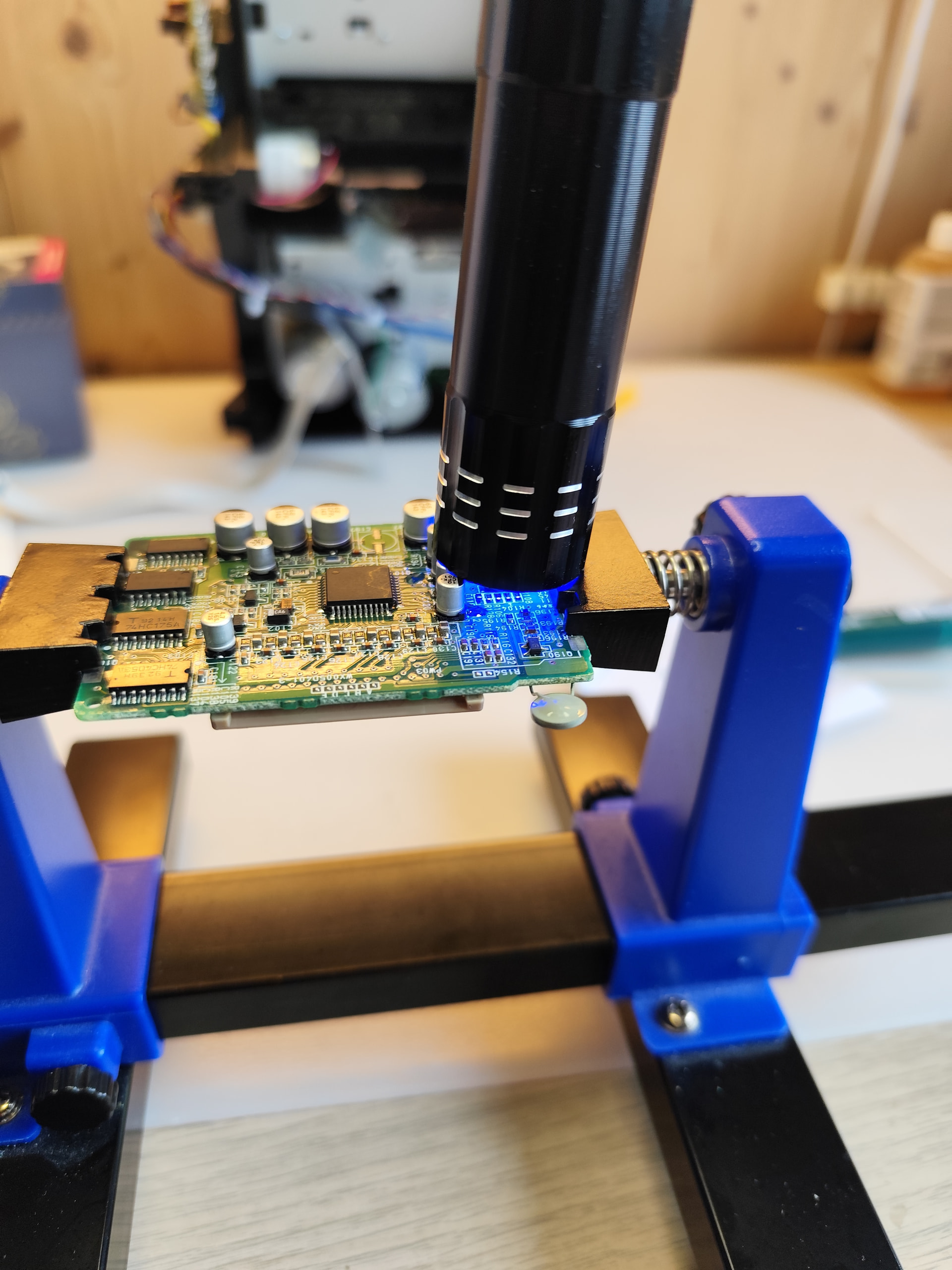

Today, I spent almost the entire day troubleshooting. It worked, it works 100 percent. The PCB traces were damaged in several places.
Good job and nice photos :+1:

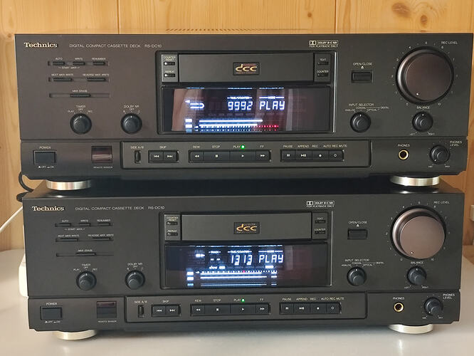

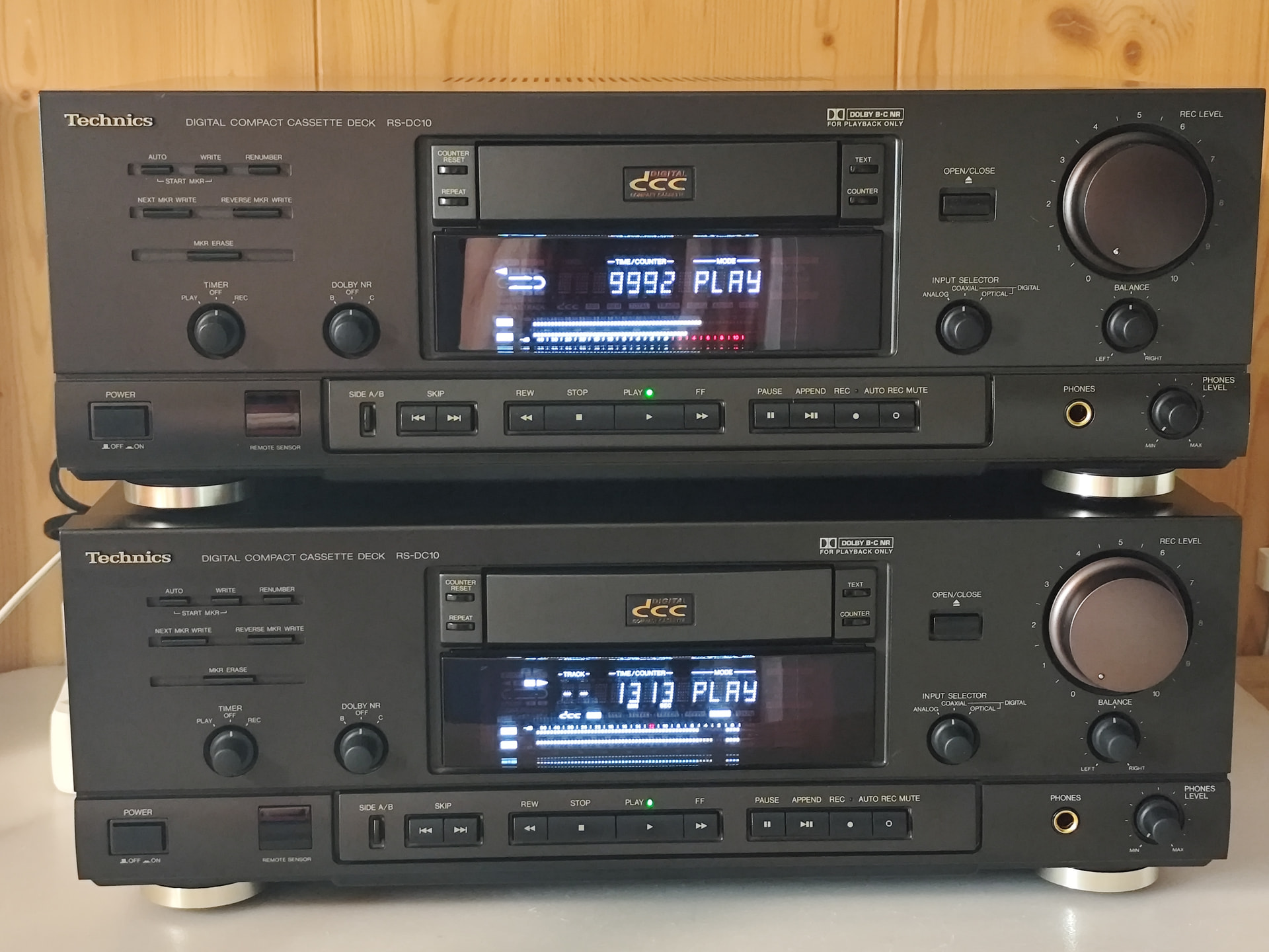

I spent a long time looking through the RS DC10 schematic. Multimeter in hand, searching the PCB. I found a few broken traces. I connected them, applied solder masking, and everything returned to normal. Now I have two fully functional DCC Technics. It’s worth the time.
