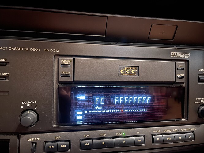

I don’t know what to look but I included the picture of the All Rate services. So you can see and tell me what goes with my desk. I try to play the same tape by eject and loaded it back in. But not repeat play with audio.

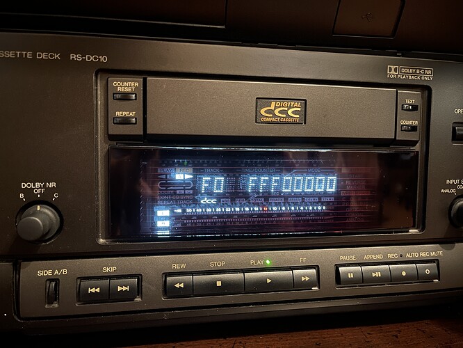

If the first picture is taken with a prerecorded tape (known to be 100% good), and the tape head is clean, then the head or amplifier has those bad channels where you see F. That means the time code channel (the left most) as well as 3 first audio channels are dead. Next would be to check if it the head or the amplifier chip.
I have no idea. But I push the head down and work for now. I Thinh It needs a hard alignment, not a chip issue. All capacitors have been replacing bought from the DCC museum.

If you push on the head and the audio channels change from F to 0, someone has misaligned the head.
You can do it in service mode while playing a pre-recorded tape.
