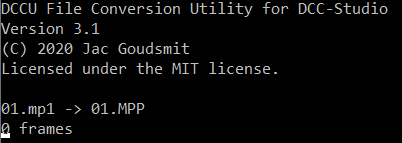

Finally! I’ve been playing around a bit with mp2enc and the new DCCU. My source WAV originates from a 24-bit 96kHz FLAC file and is therefore a 24-bit 96kHz WAV file as well.
However…
When using:
mp2enc -v 1 -b 384 -p 1 -r -o 01.wav 01.mp1
… I’m getting a somewhat distorted or dampened MP1 file that seems to miss out on large parts of the audio. I listened to it on Foobar and VLC.
And if I’m trying to use DCCU 3.1, it won’t do more than mentioning “0 frames” and seems to hang.
Anything I am missing?
Thanks!
I think you needed the patched encoder by @Jac, I am not sure if it is released yet.
The latest version of MP2ENC is at Releases · DigitalCompactCassette/DCCSE · GitHub
The latest version of DCCU is at Releases · DigitalCompactCassette/DCCU · GitHub
The correct command to encode a PCM WAV file to MP1 is:
mp2enc -l 1 -b 384 -o “outputfilename.mp1” <“inputfilename.wav”
The first option is a lower-case L (for Layer). WIthout it, you get an MP2 file which is not compatible with DCC.
By default it will use 48000 Hz stereo but 44.1kHz or 32kHz are also available as an option.
Don’t forget to use the ‘<’ in front of the input file name. The program gets its input from stdin which makes sense on *nix environments but not in Windows. I will probably make a modified version some day that works differently. I will also eventually integrate the DCCU functionality into it.
The correct command for DCCU is:
DCCU inputfile1 [inputfile2…]
The command line syntax for DCCU is also not very useful and may also change in the future.
DCCU automatically generates an MP1 file if the input file name has an MPP extension, and generates MPP and LVL and TRK files if you the input file name has an MP1 extension. The LVL file is a dummy file; you won’t see the audio levels in DCC-Studio. I’ll fix this in the future.
The reason your DCCU version doesn’t work is probably because you are trying to convert an MP2 file so it can’t find any MP1 frames. You also don’t have the latest version (currently 3.2).
