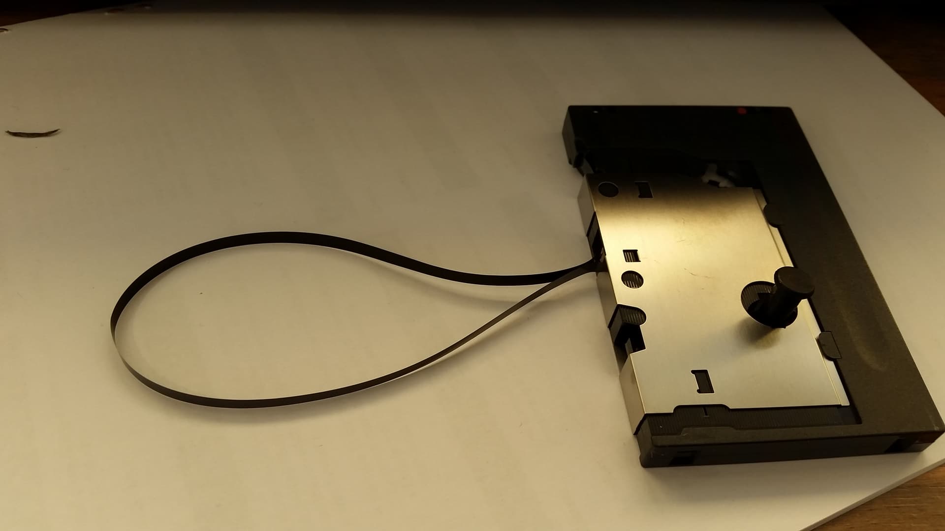

Second, VERY CAREFULLY pull the tape out, I usually pull it out for around 30-40 cm so that a total of 80 cm of tape is out of the shell, and make SURE that the tape unwinds from BOTH spindels.

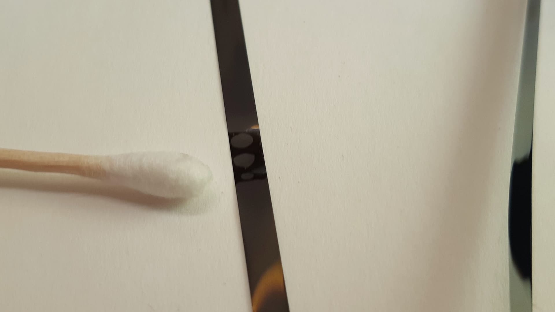

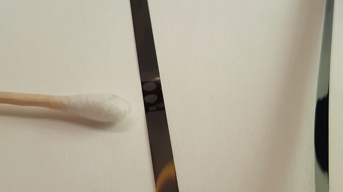

Third, place the tape with the back of the tape up, on a flat and clean surface where you can shine a bright light on it. Find the spots where there is some (greasy) residu visible. It will probably repeat every 10cm or so.
Fourth, clean the back of the tape with cotton swab with alcohol, rub until the surface is spotless again. Be VERY careful to not damage the tape, or that spot will become a spot where dropouts in the data(music) will be heard.
Fifth, after you cleaned all the spots, carefully wind the tape back into the shell. Then it is probably best to rewind the entire tape 1 or 2 times in its entirety.
