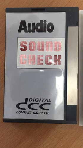

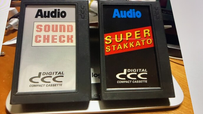

Today I like to ask everyone to share about service tapes sometime age I so on eBay set of six or seven tapes DCC to service player at this time I didn’t have any knowledge or interest on purchasing this set

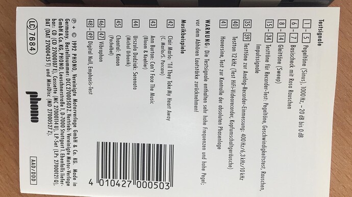

where he test his Kenwood player with 1000hz tone and check left and right channel
Sometime I see tapes with 1000 hz -3000 hz for speed correction player with faulty belt then need adjustment

I have some test DCC’s I bought off eBay a while ago and I think they were used for production testing. I haven’t listened to all of them but I think they have repeated frequency sweeps recorded on them. This was probably done to test the digital filters.
There were also DCC test cassettes that had a 96kHz signal on each track, according to the service manuals. These probably don’t reproduce any audio, they’re intended to adjust the read amplifiers and test the low level hardware. In theory it should be possible to use a microcontroller to generate these by directly controlling a DCC deck’s write amplifier. Maybe I’ll get to creating those one day. But creating a DCC with a 1 kHz or 3 kHz or 3.14 kHz signal is not that hard. I have a test CD that I could digitally record, and just yesterday I found how to encode a file on a PC and put it on a DCC through DCC Studio, so it should be possible to generate a DCC with a test tone or a sweep or whatever by using a computer.
