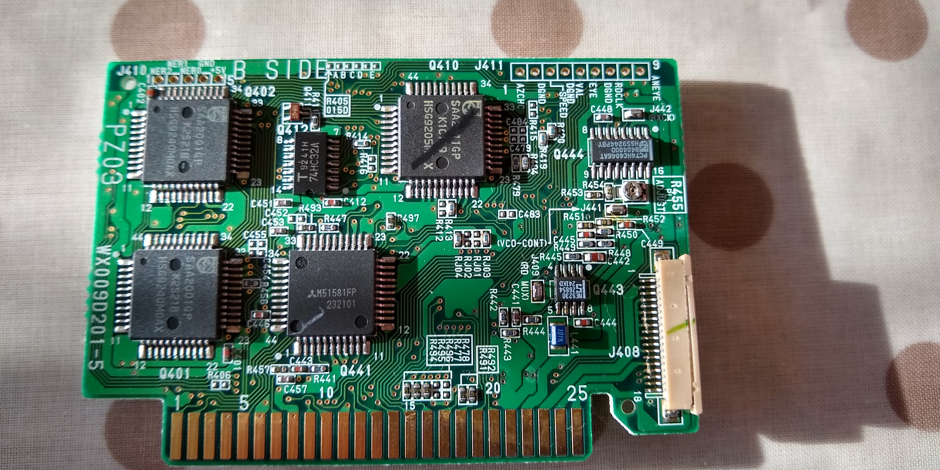

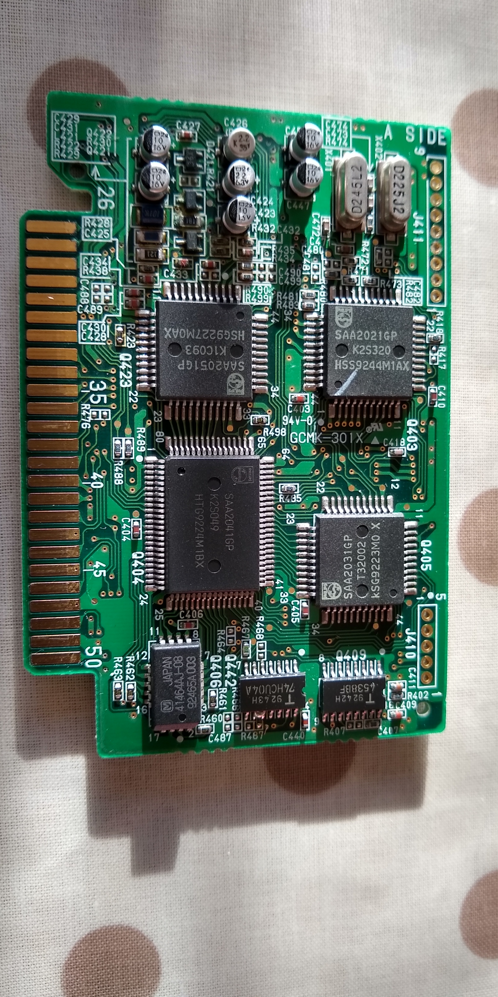

Hi Mario and welcome to the forum. Clean your head, check and clean your pinch rollers, clean you capstan rollers first. The machine will need recapping without exception I’m afraid. Here are some pics of a board I’m working on this morning, you may think they look ok, but using 20x magnification, they dont look good!
