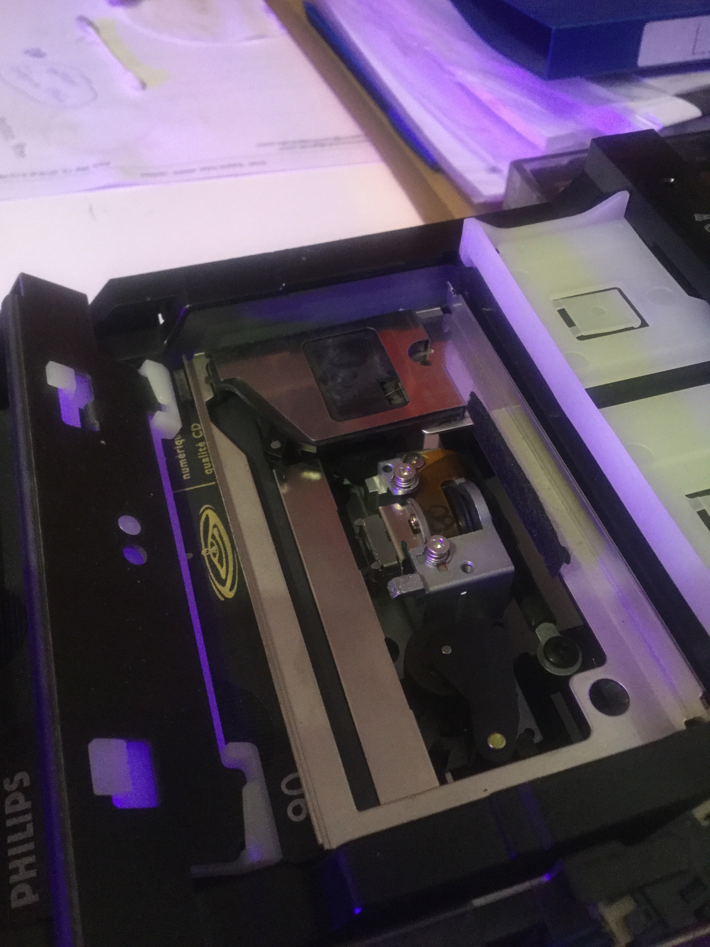

As you see on picture two pinch rolers replacing them is part of maintenance I don’t know how to replace them I have to ask for advice or video link thx
It is relatively easy. The right pinch roller is held down with a clip. By inserting a screw driver the clip can be moved (don’t put to much pressure) and the entire arm with pinch roller will come out. You can remove the metal axle and put a new pinch roller in. Then simply click the entire arm back in place.
The left roller is a bit more work, You have to remove the metal cover (held down with one screw) to gain access. Other than that it is the same procedure as the right roller.
