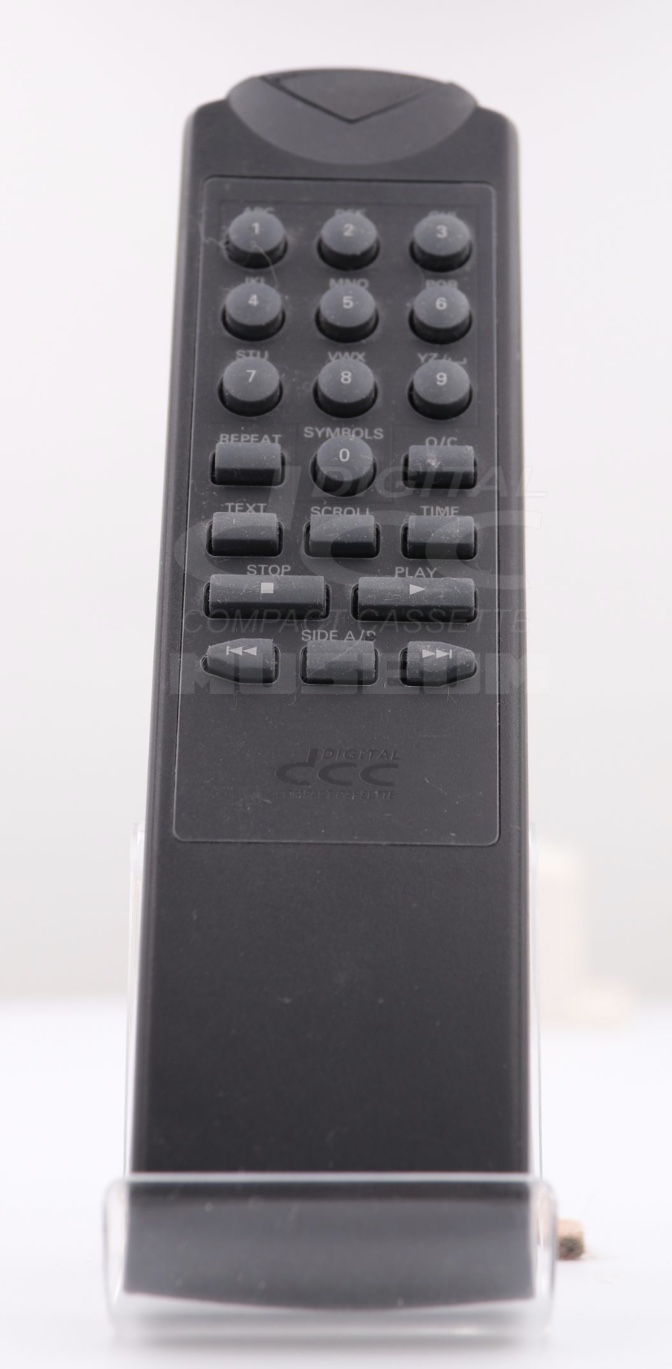

All remotes that you listed will work on the 951 and 730.
The original one is smaller and has actual numbers and letters on it, to make programming easier.

All of them are the same form factor as you show here.
But which belongs to which recorder.

All of you remotes listed should belong to either first and/or second generation players.
The 951 and 730 start normally with 6842. That remote is a bit smaller.
