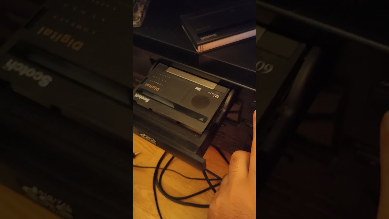

I leave you videos so that you tell me what you think…
I had the head cleaned by a professional and since then I haven’t touched it so I think that in terms of cleanliness it’s normally OK.
https://youtube.com/shorts/hRY9cukb6oQ?feature=share
https://youtube.com/shorts/nYQ8sUl2IVM?feature=share
Judging from these videos, it looks like at least the head, the pinch rollers and the mechanism and electronics of your recorder are working great. There are almost no dropouts on either of the two prerecorded cassettes and the analog tape sounds fine too, no excessive wow and flutter.
I can’t really tell what’s going on when you switch to side B, though. It looks like the B-Side of your tape is blank, maybe it’s past the end of the recording. Try putting the recorder in service mode and playing side B of a prerecorded DCC tape, and see if the dropouts are just as low as on side A (i.e. you should see 00000000 most of the time). If not, there may be something wrong with the head pivoting mechanics but we would have to look more closely at the details.
It looks like you’re trying to show the pressure pad in the cassette in the last video, but you’re holding the cassette away from the camera when you finally figure out that the slider opens the other way :slight_smile: .

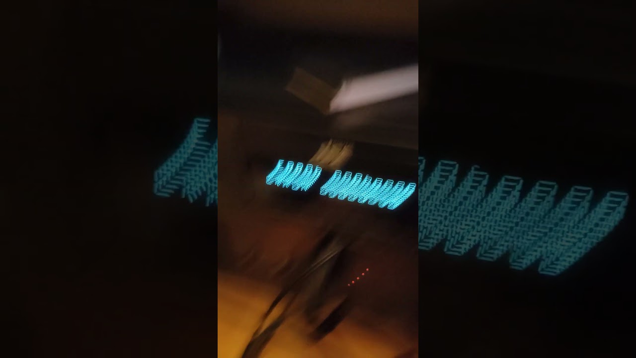

I tried different cassettes but most of the time I have the message “cleaned the head” which is displayed…

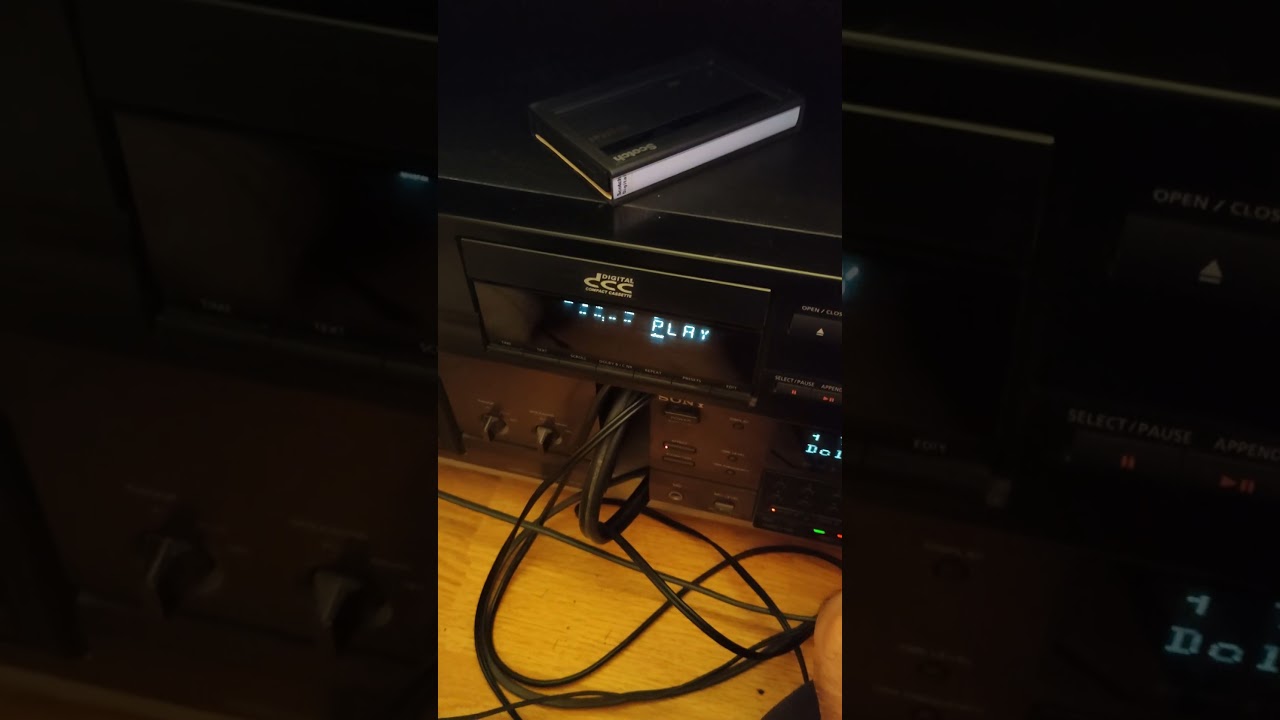

here are 2 videos where I test analog recordings but no sound comes out.
at the connection level. I connected the output of the amp to the analog input of the walkman but nothing..
can’t get sound…
it is impossible to know if the sound to be recorded reaches the cassette player?
what does aux1 aux2 tuner etc mean at the top of the player screen? I’m just careful to be on analog when I’m on break…
Thanks
If you are not hearing any sound, you most likely have selected the wrong input channel.
On the second video however, I can hear the source, so that is ok as a source input.
The clean head indicates there is bad contact between the tape head and tape. This often leads to playback issues but also recording issues. Make sure you clean the head and pinch rollers.
Another problem I noticed in your video is that the gear is cracked. Minor problem, but the rattling sound when winding/rewinding indicates that. We have the gears in stock if needed.
