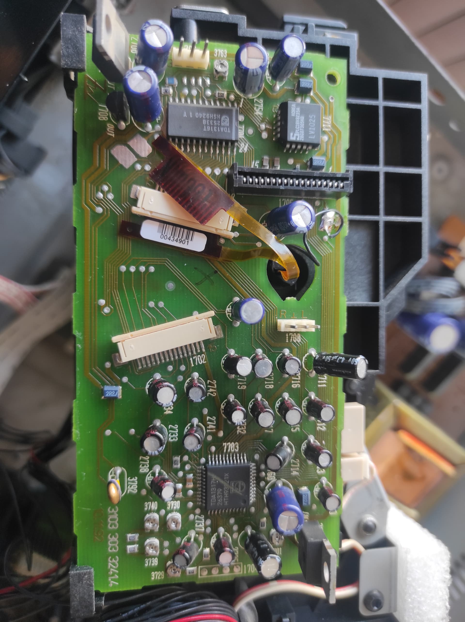

When I checked capacitors and lines… dcc tape is recognized…when i pull out cables for heads. Try to check board… Nothing is leaked or broken. When a assembled again… No dcc recognized a tape only…

How to check DDSP procesor, why is in READING mode?
How does the player initialize a DCC tape? What signal is needed?

Is this part digital reading from heads>digital board where heads are connected? Or a board behind where play and buttons are? With SAA2014
