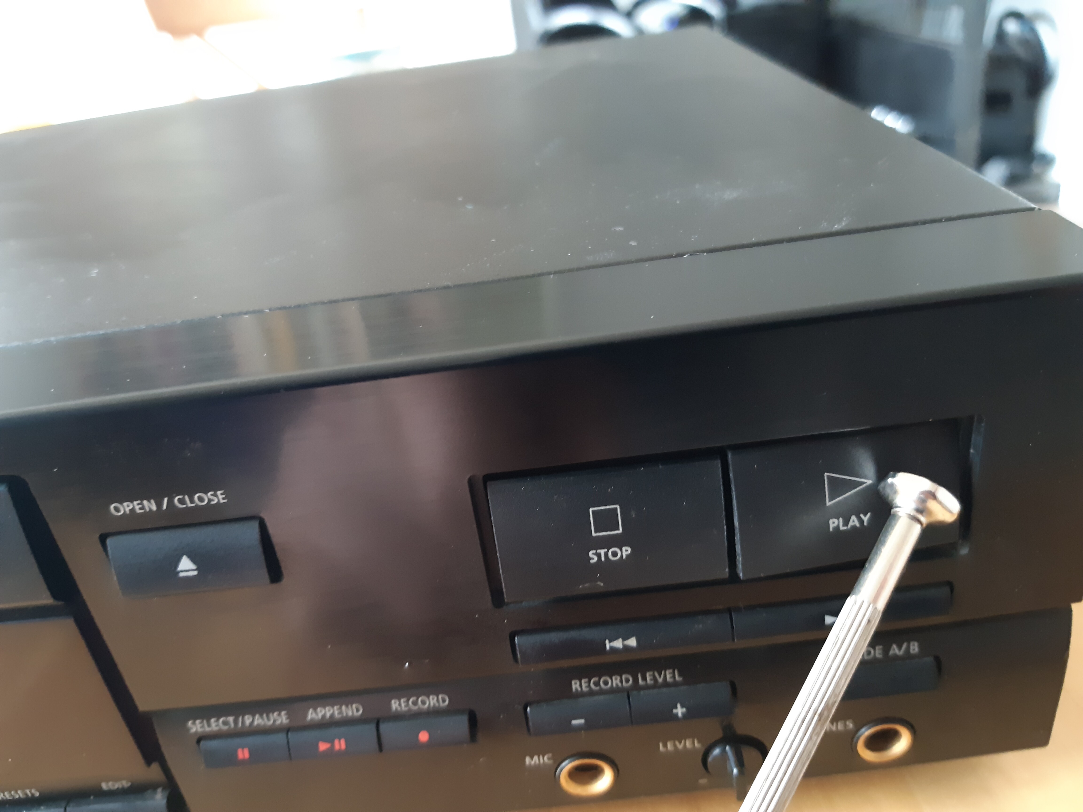

Maybe anybody has any expierence with button repair on a 730. My play-button is loose on the right hand side, the left hand side is fine so the button still works, it looks like this
I took the hood of, and find a lot of screws on some board attached to the buttons (I suppose). What is the trick to get to this play button (the easy way) and see what is going on ?
I have seen this several times. Solved it by taking it completely apart.
Used hot glue, as that it flexible to repair.

I repaired this week the same situation in one of my several 730 models, I make a repair as Ralf told, with hot glue. Works!
Obviously that, having the opportunity to open the equipment, also clean with alcohol the Head and Pinch Rollers and change the position on these ones due to the fact that A roller is always more brilliant and less adherent than B, due to greater use of A side compared with B side, if both working correctly… you can use more time until the replacement of new ones.
