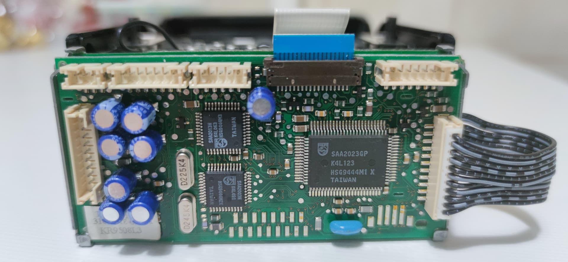

I then examined the digital board and found a leaky SMD capacitor.
I therefore decided to replace them all.
once desoldered, 5 of them left traces of acid on the PCB.
All replaced with normal electrolytics, never more SMD.
The 951 is back to life and no errors on the head channels.
I’m thinking of changing those on the head amplifier PCB too, before something irreparable happens…

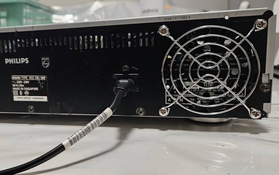

To avoid the increase of temperature, a great factor to this problem, that happens when playing but also on standby, I decide to do this improvement.
