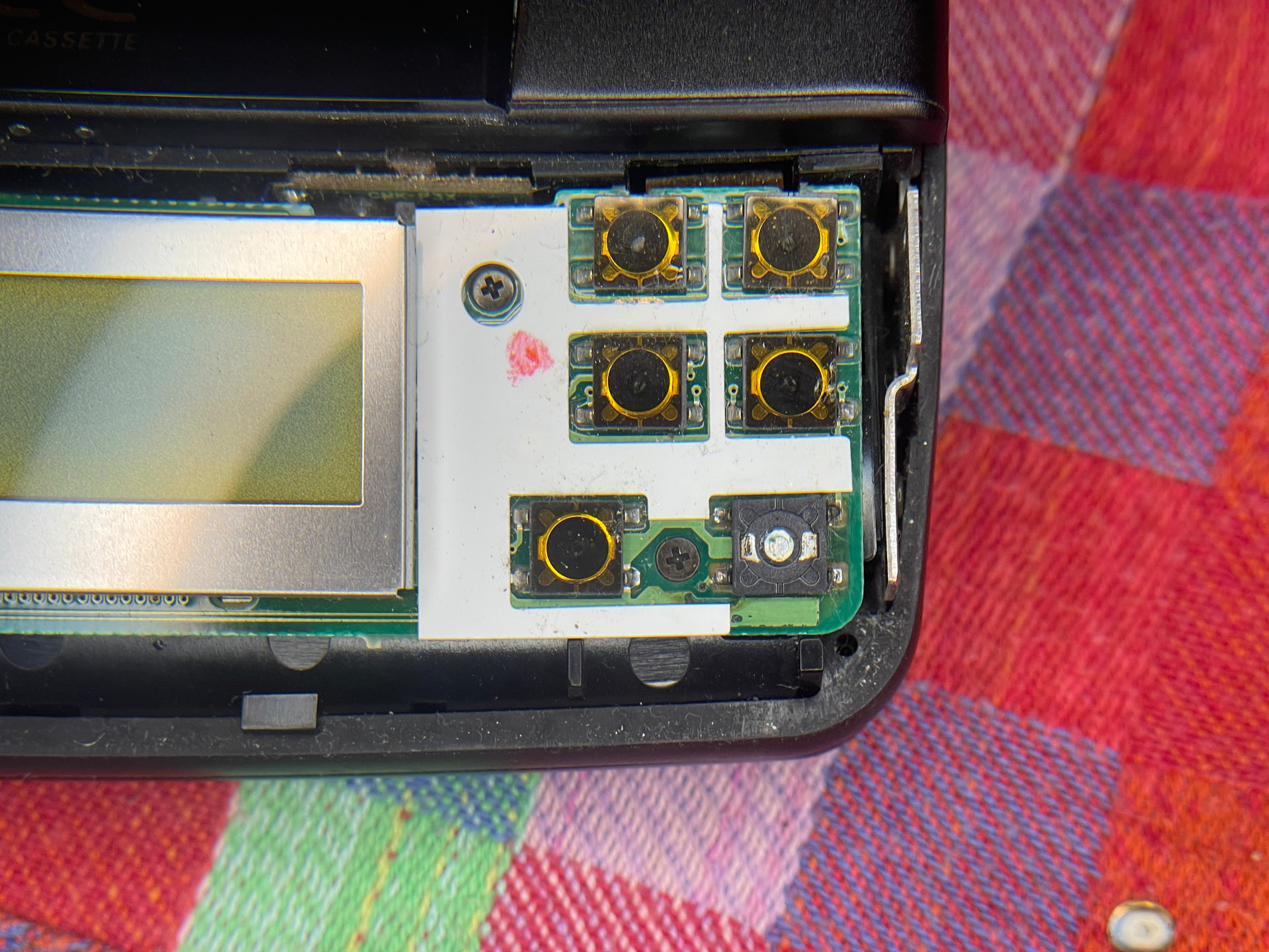

I have seen dirty switches, causing strange behavior, but it could also be that while pressing play, another/multiple buttons are pressed at the same time.
It is fairly easy to take the cover off, by removing 4 screws and check underneath.
2 screws on the left and 2 on the right hold the cover to all switches.
Thanks, Ralf. Since PLAY engaged through the remote and the on-device buttons goes through two entirely different electrical routes, and since the on-device buttons make use of a resistor ladder to signal IC500 which button was pressed, my first guess is that there’s something wonky with the resistor ladder. I’ll check its values first and also the two transistors connected to it. Maybe I can dig something up here.
Just in case someone stumbles over this: it turned out to be worn buttons (switches). I disassembled the relevant ones, removed corrosion or oxidation, and resealed them with some superglue. That worked just fine.
