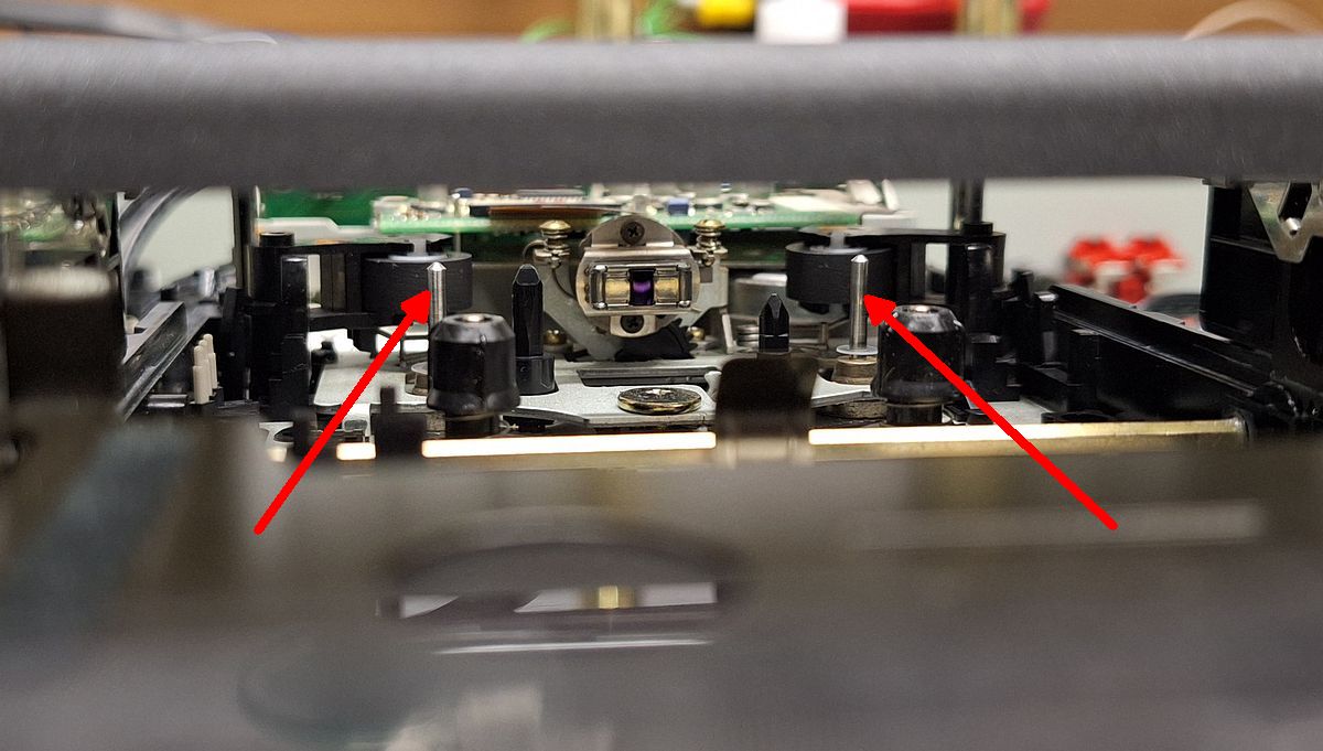

Thank you for your quick responding, and yes i have erros on 9 channel mostly 20 but playing from 17,18,19 and 20. Im afraid the R/W board maybe, what you say? by the way the head is clean, but what is the capstans, you mean the pinch rollers?
The capstans are the axles that the pinch rollers push to when playing.
