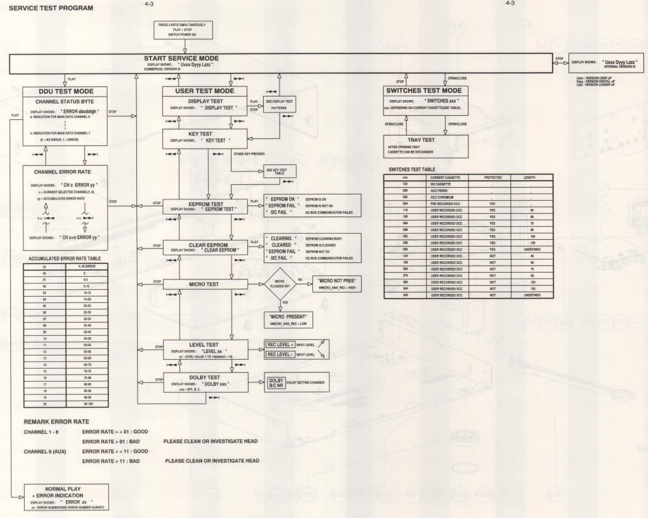

You can download the service manual from dccmuseum.com and put the machine in service mode.
It will give you more information on the head - read write board.

Hello. I have tried more than 10 dcc cassettes with recording. on one dcc cassette, the sound appears and disappears on the B side. The speed of the audio cassettes is normal, the pressure rollers are normal. Please tell me how to put the car into maintenance mode, which I haven’t found (I don’t know English well (()
When should the fan in the back turn?
Hi Kos62 and welcome. I take it you mean DCC951? To get into service mode- with the power switch off, you have to press stop and play at the same time and turn the power switch to on. I think you then make your way through the menu using the ffwd / rwd keys until you get to the page showing error rate.

The DCC91 and DCC951 are completely different machines. The DCC91 is a 2nd generation 36cm wide system with “portrait” loader, and the DCC951 is a 3rd generation 42cm wide system with “landscape” loader, 18 bit audio and turbo drive.
And no, they don’t go to service mode the same way.
