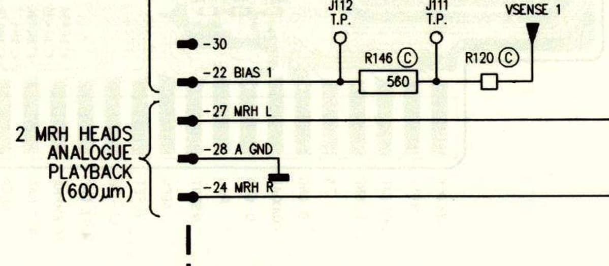

I recently acquired a Philips 900 series DCC player in mint condition. It plays dcc cassettes perfectly - love the sound.
However , it just wont play standard cassettes. It will fast forward , rewind and all seems fine mechanically when i press play - alas no sound.
Has anyone had this issue and found a solution.

First you can try to clean the head with alcohol. Analog tracks (2x) in the lower part of the head.
Then you can try to check if the analog tracks of the ribbon cable that connects the head and the RW board are all OK.
Those pins 22, 24, 27 and 28 are responsible for the analog part of the head.
However, there is a strong opinion that you should avoid to playback ordinary compact cassettes. In a certain condition, environment those old CC can damage the head that you will not be able to play DCC tapes and only CC will leave for a while. So maybe it is not that bad that you are not able to play them now and leave it as it is. ![]()
