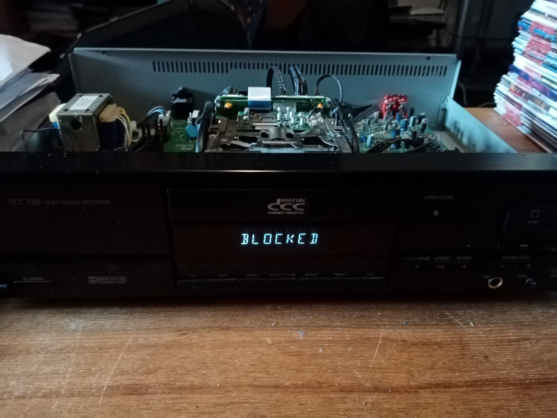

Philips DC 730 "Blocked"
I have a Philips DC 730, put a digital cassette in today and the message comes up “Blocked”… Now I can’t get the tape out of the machine… Help please!

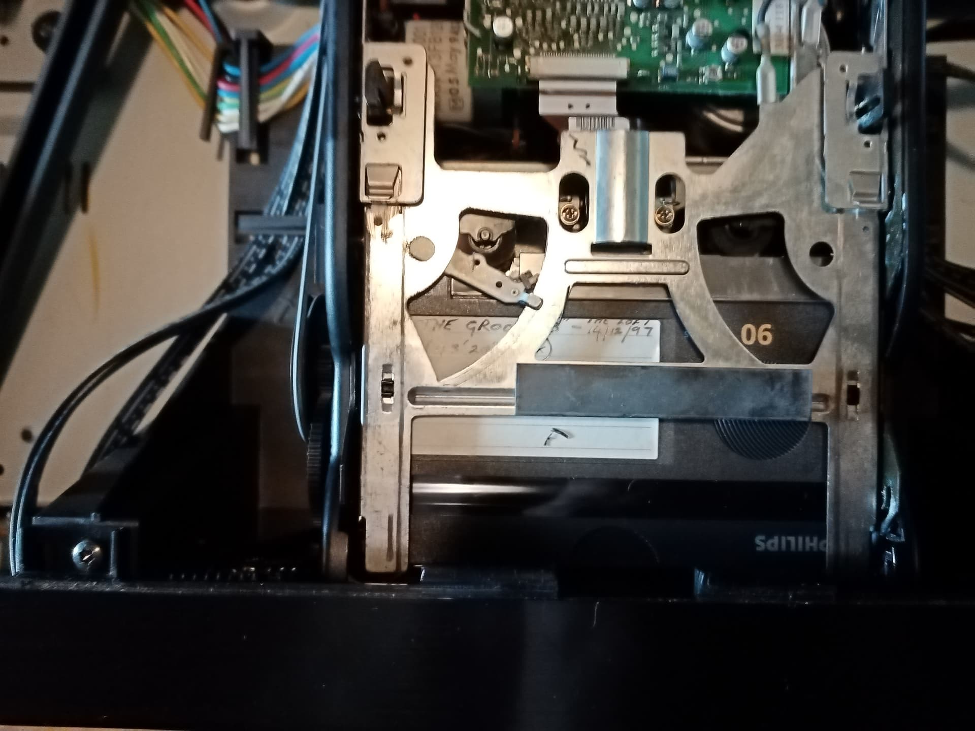

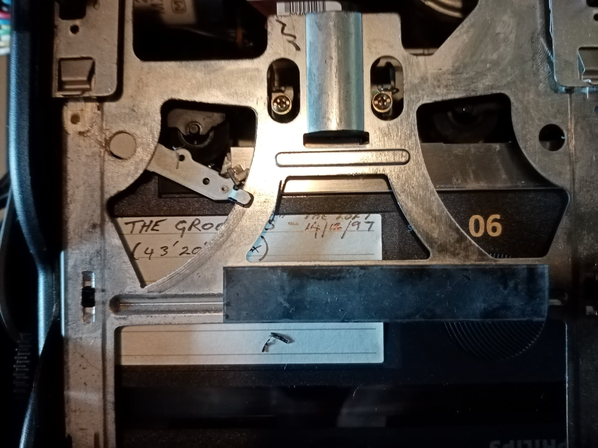

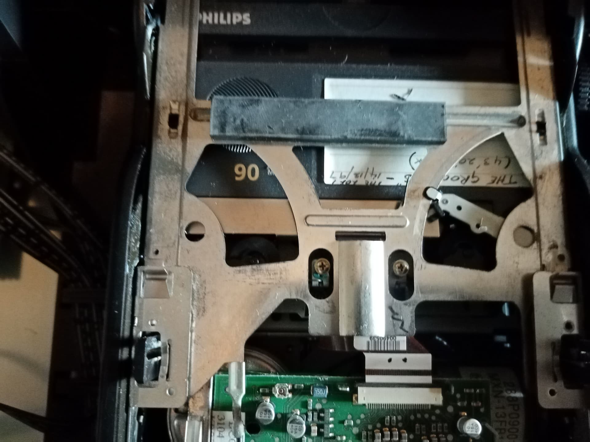

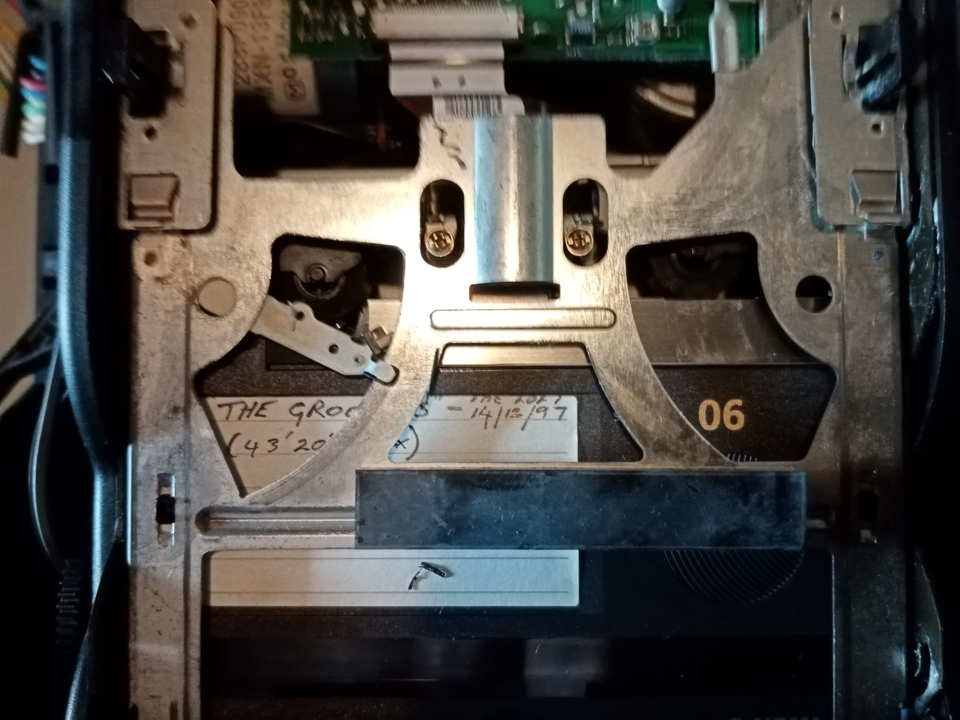

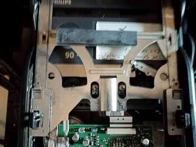

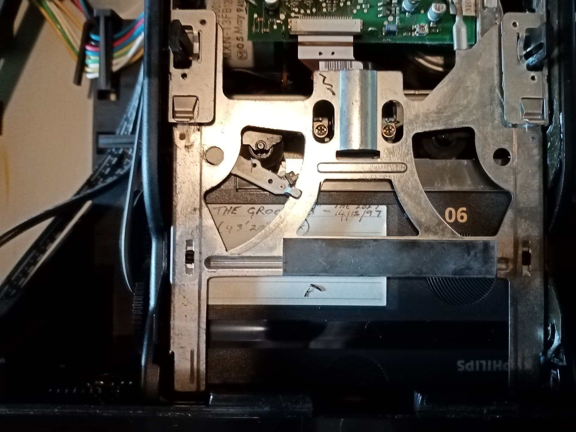

Can you open the player and take some pictures? It might be that the mechanism that opens the DCC slider is blocked.

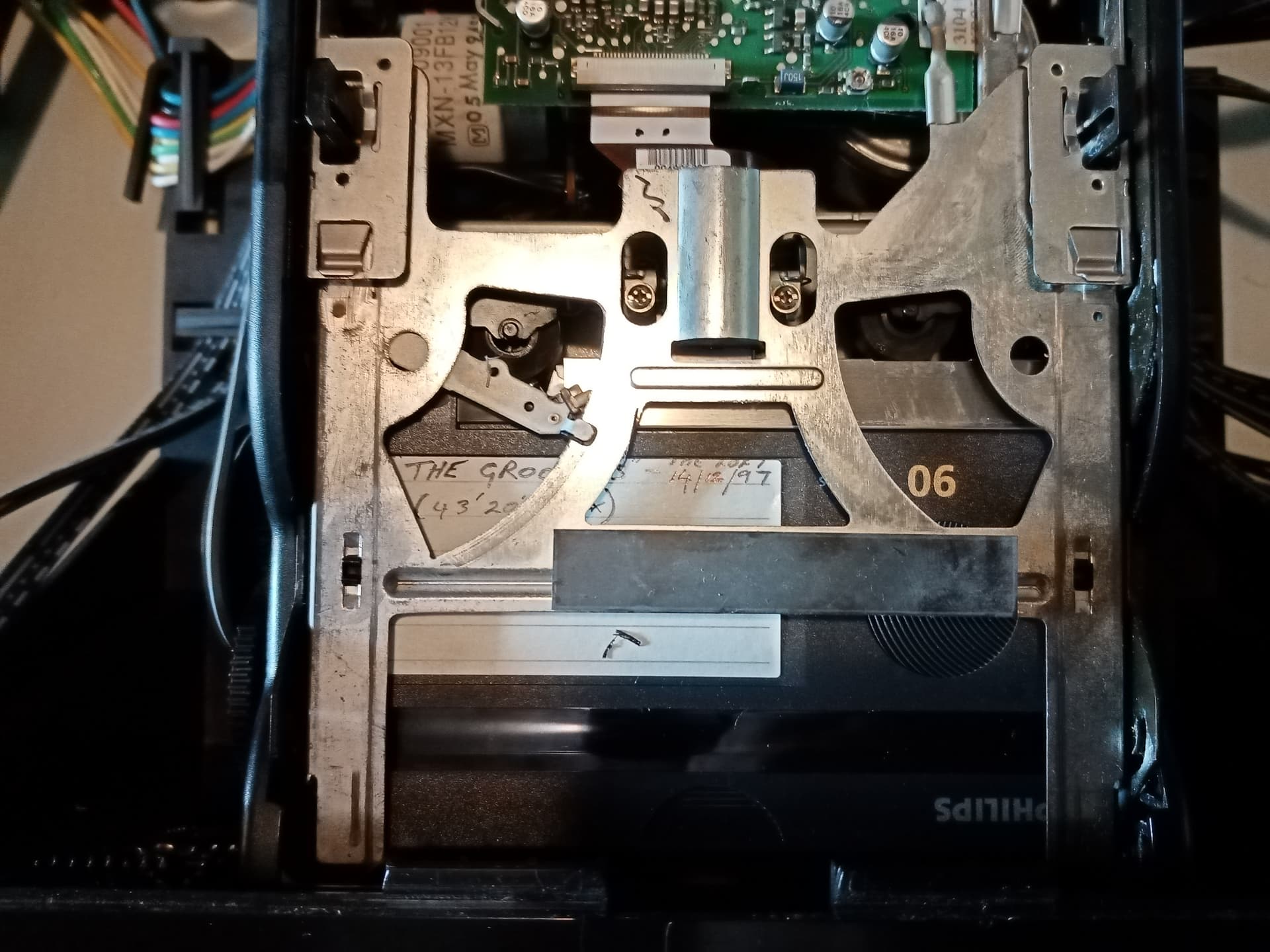

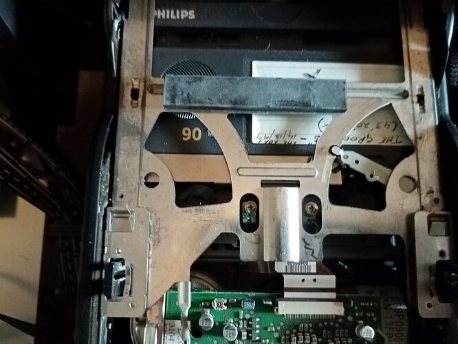

Pictures enclosed…

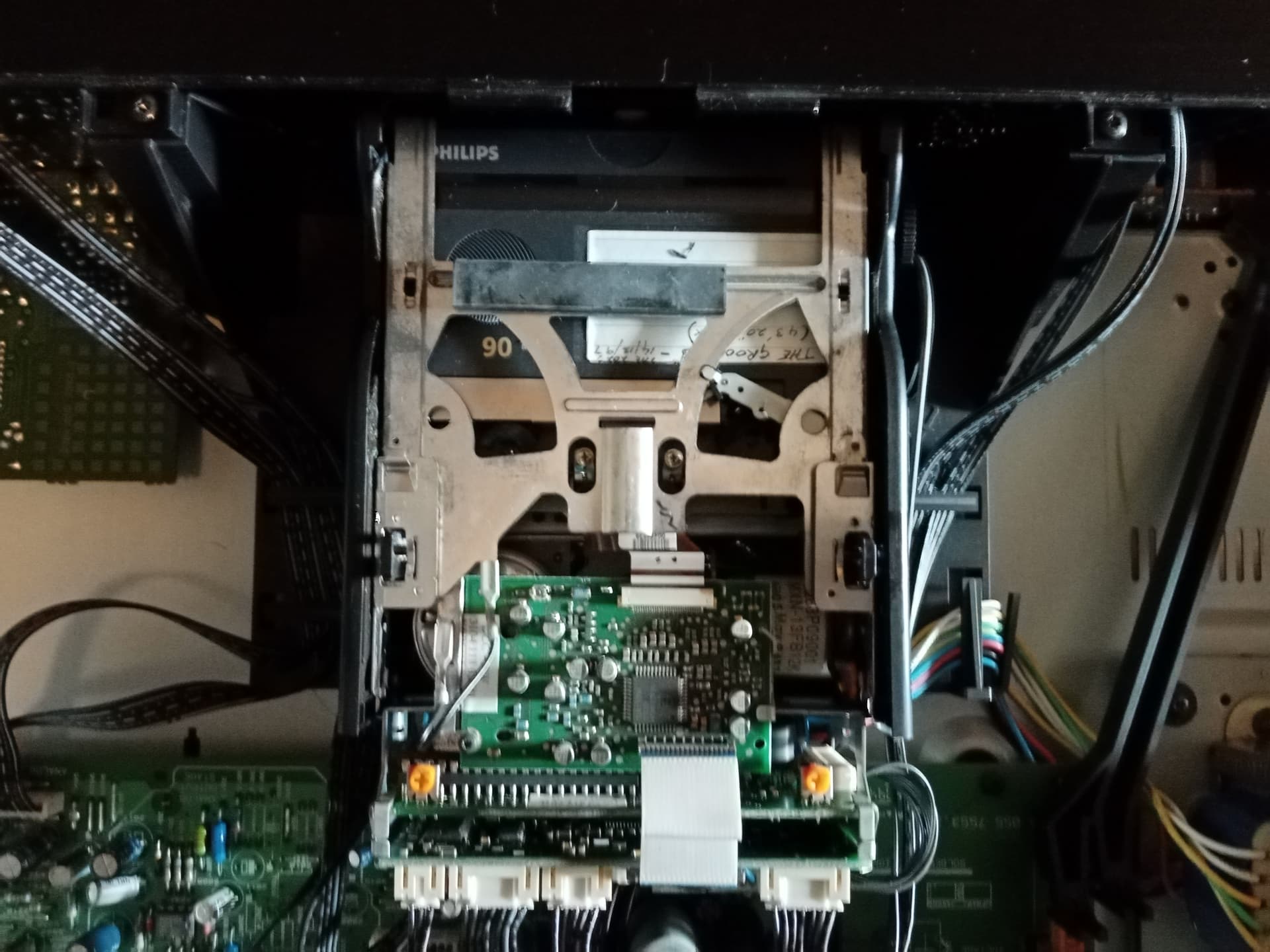

The head seems stuck in the play position, thereby blocking the cassette. Might be a timing issue with the gear at the bottom.
Use an antistatic mat and wrist wrap. Try to manually turn the belt on the left side. If that does not solve the blocking, remove the two black screws holding the mechanism to the bottom (near the main board).
Remove the cables that connect to the main board. Lift up the mechanism carefully and try to remove the drawer front piece that says Philips.
If you succeeded, lift out the mechanism completely and you can remove two screws and so investigate the mechanism and other belt from the bottom.
