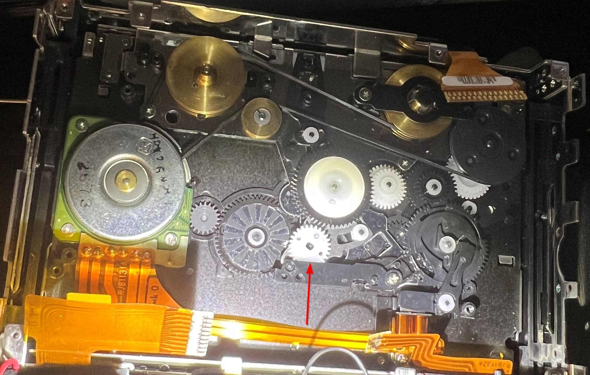

Well, I decided to open it up, and after removing both boards, I found what must be at least part of the problem. The white gear indicated in the picture was just resting loosely in that position. I’m not sure how to proceed because the center hole of the gear doesn’t seem to fit on the spindle beneath it. If anyone has any suggestions, please let me know.

Here’s an update after I have looked at it for a while. Yes - the white gear was completely loose and free. I could pick it up and inspect it. After a while, I realized that it would press onto the black spindle underneath it – I just had to look more closely and use a little more force than I wanted to.
After it clicked into place, I was able to capture the video below. There was an analog cassette loaded at the time, and the first time you see action, I pressed the play button. This resulted in the clicking back and forth. Then I pressed rewind, and it seems that the gear engages correctly for a couple of seconds, but then it goes back into the clicking.
Shortly after I stopped the video, I pressed rewind again, and the gear popped right off and flew across the room. By some miracle I found it.
Bottom line, there is an outward force on it that’s popping it off of the spindle. But even when it’s in place, the player just clicks.
That part is definitely broken. That clicking might have to do with the fact that the board is not attached as the lever is not engaging the electronic switch on the board.

Update: I was able to replace the mechanism. If anyone is curious, the white gear that was popping off is apparently supposed to be one piece with the spindle it’s pressed onto. Once they separate, you need a new one.
