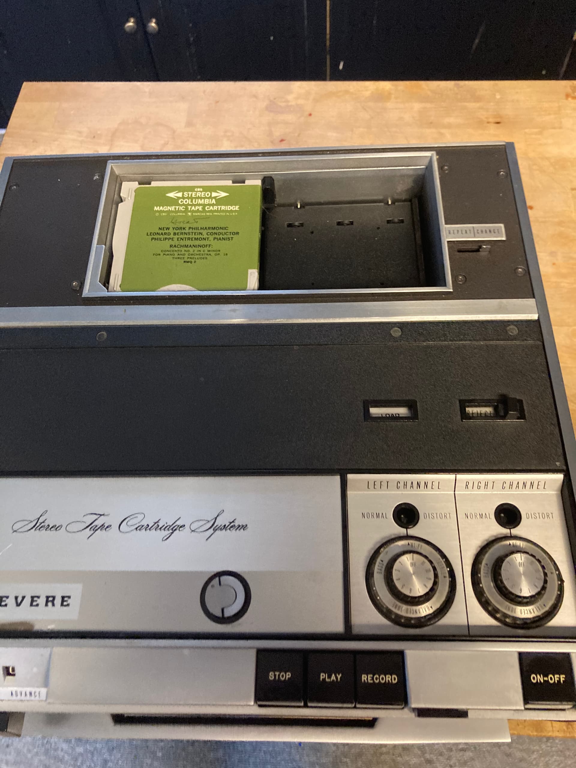

Now I need to find a repair guy that specializes in 3M Revere cartridge machines!
Oh, man… you’re going to have all kinds of fun finding anyone to work on one of those! I’m afraid to even think about how many belts and pulleys there must be in that auto-changer mechanism…

Oh yes it a complicated mechanism. Just like with My DCC machine, it’s better to keep the work into the hands of a professional. These machines are rarer than DCC Machines are!
Electronics work doesn’t faze me – I’ve re-capped a whole lot of devices, including my DCC900, with bad or suspect electrolytic capacitors – but complex clockwork mechanics like that is definitely not my forte. :slight_smile: If I had one of those beasts, I’d hand it off to a professional, too!

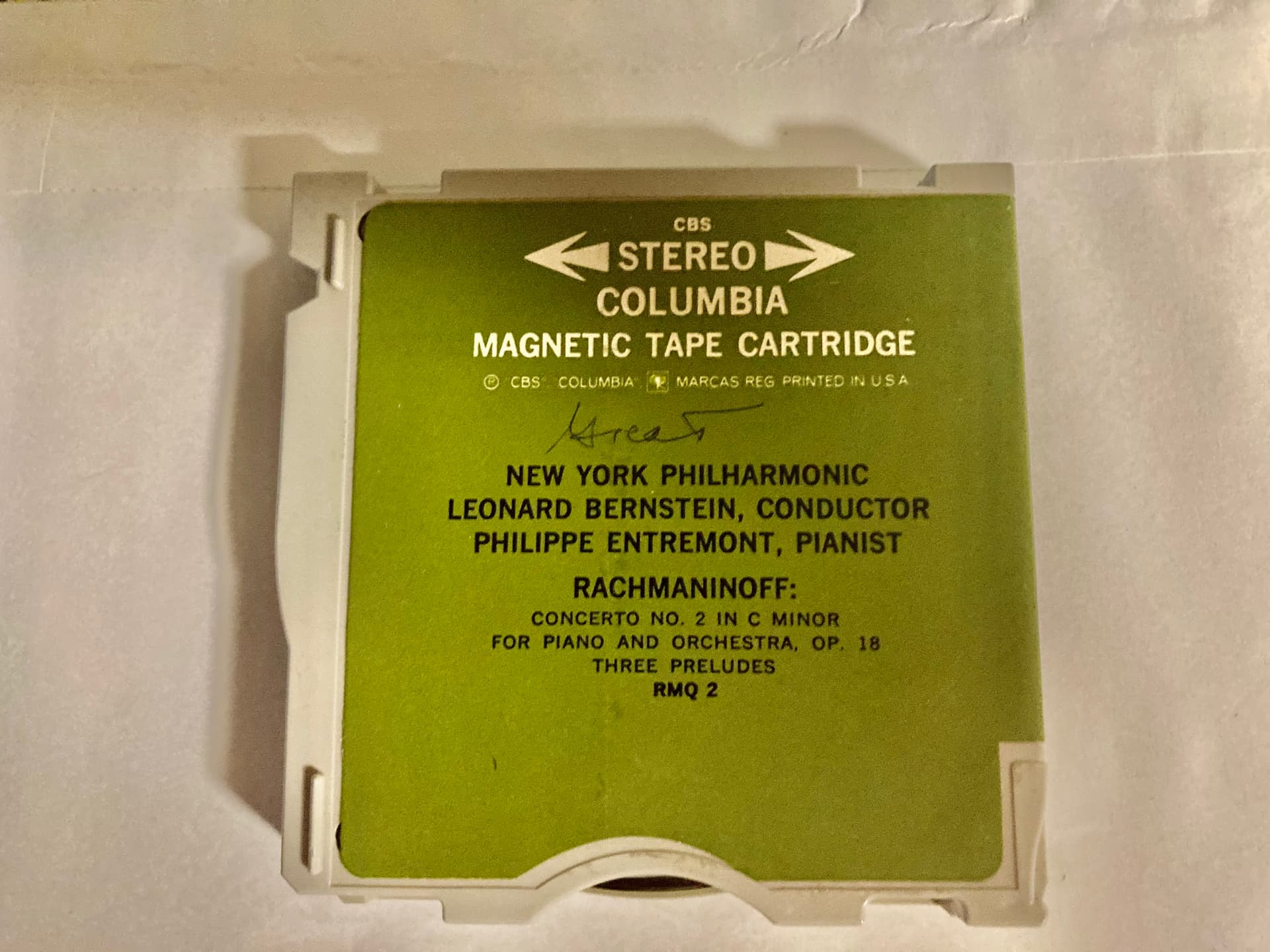

I forgot to mention the larger version of the playtape/Smith-Corona mail call:

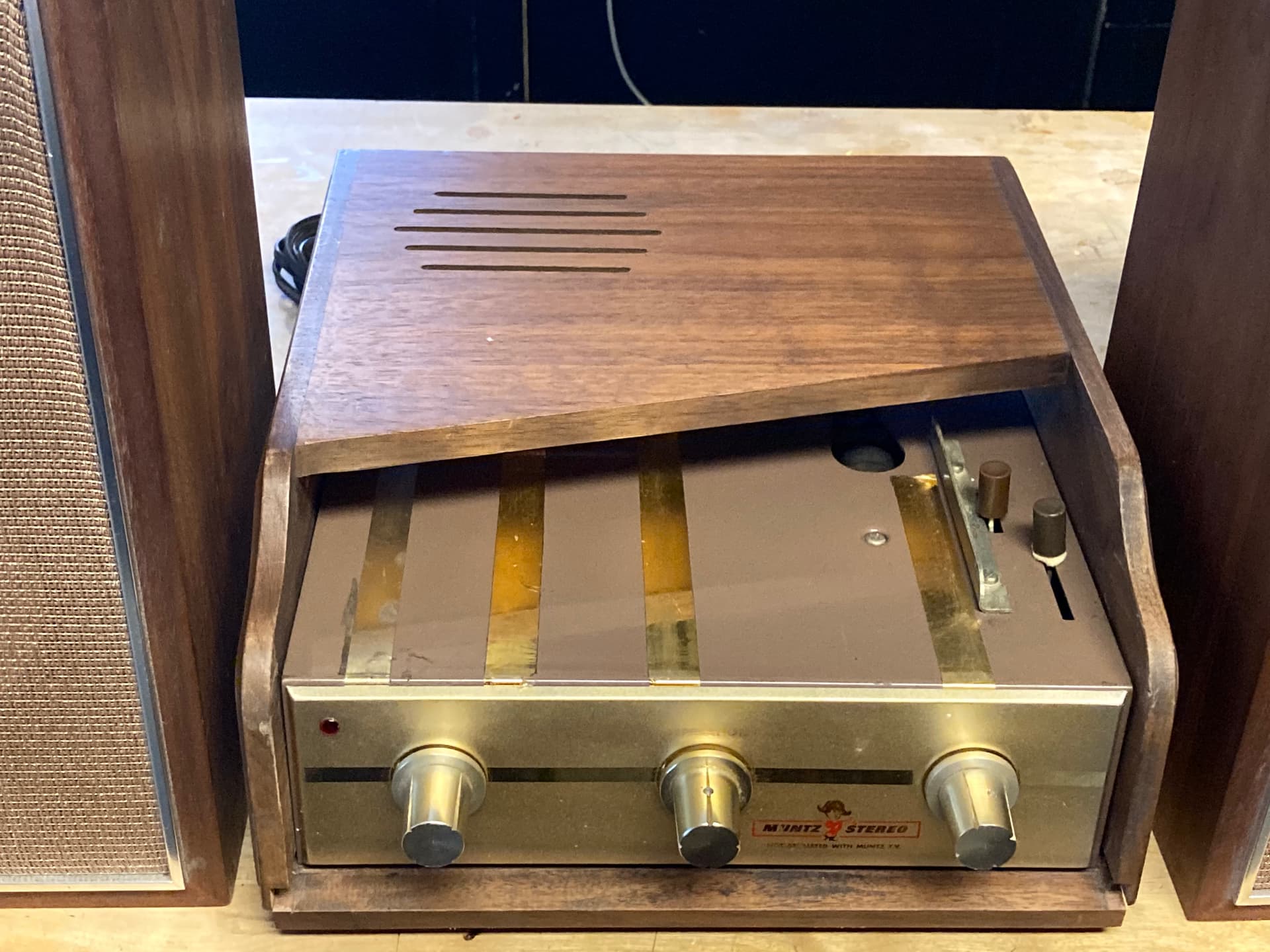

The Muntz 4 Track player!
Mine kinda works but the head needs alignment and I think the speakers that came with it are bad.
Exactly that. Never understood those devices.

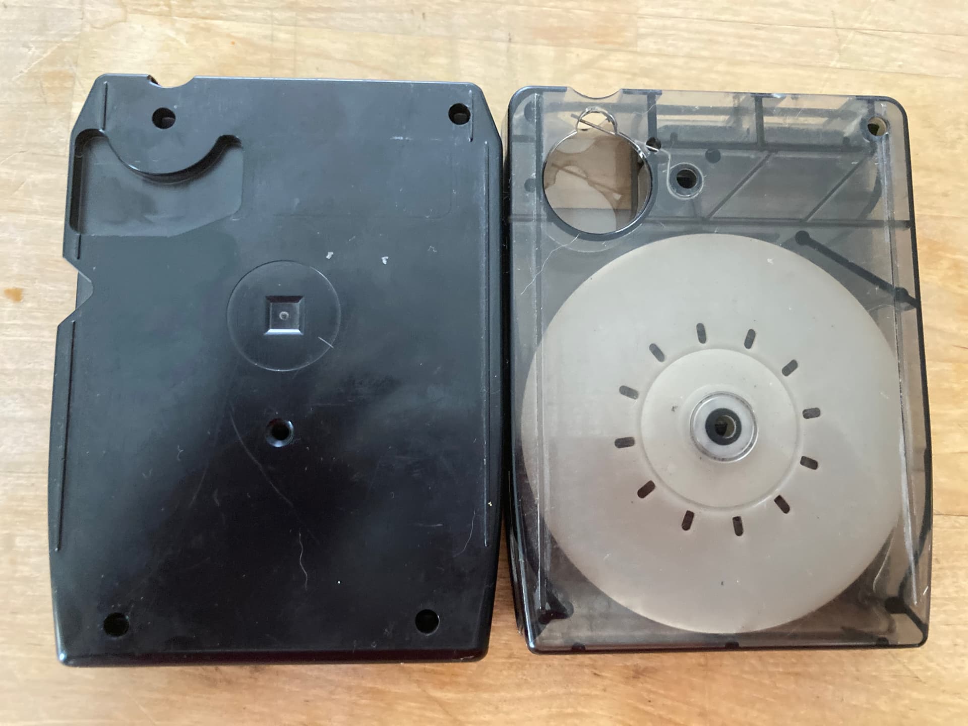

If you ever do get your hands on an Elcaset, a word of caution: For some reason, Sony felt it necessary to lubricate the tape hubs where they contact the outer shell – and that “lubricant” has, over the years, turned into something more like a 30-year epoxy that will make the hubs “stick” and keep them from turning. Which, inevitably, leads to tapes getting eaten when the take-up reel is the one that sticks, which happens with alarming regularity. (What will often happen, especially in the EL-7, is that the drive mechanism will have enough torque to keep things moving initially, but as the take-up reel gets loaded down with more and more tape, eventually the motor can’t overcome both the weight of the tape and the resistance of the “sticky” lubricant. Single-motor models like the EL-5 and EL-4 often won’t even be able to start the tape at all; the belts will just slip.)
There is a cure, but it involves disassembling the cassette entirely, and using 91% isopropyl alcohol and several Q-tips to thoroughly clean that wretched gunk out of the tape hubs and the crevices in the shell that they fit into. It’s such a common problem that nowadays, I just do this to any Elcaset tape I get my hands on, whether it seems to need it or not.

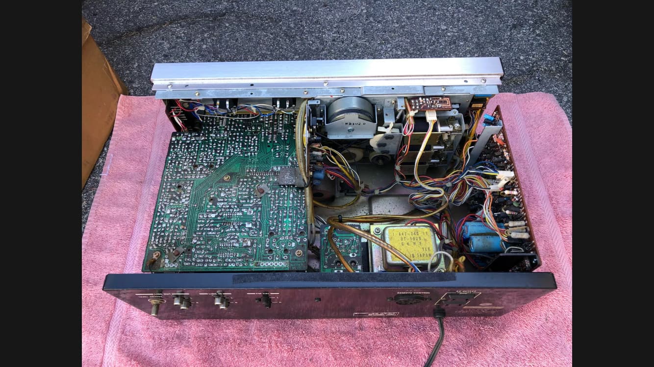

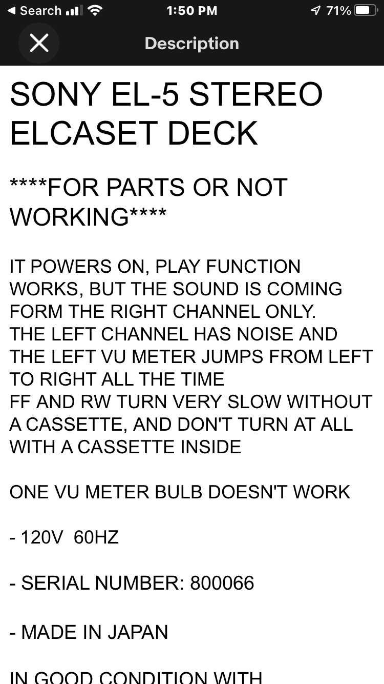

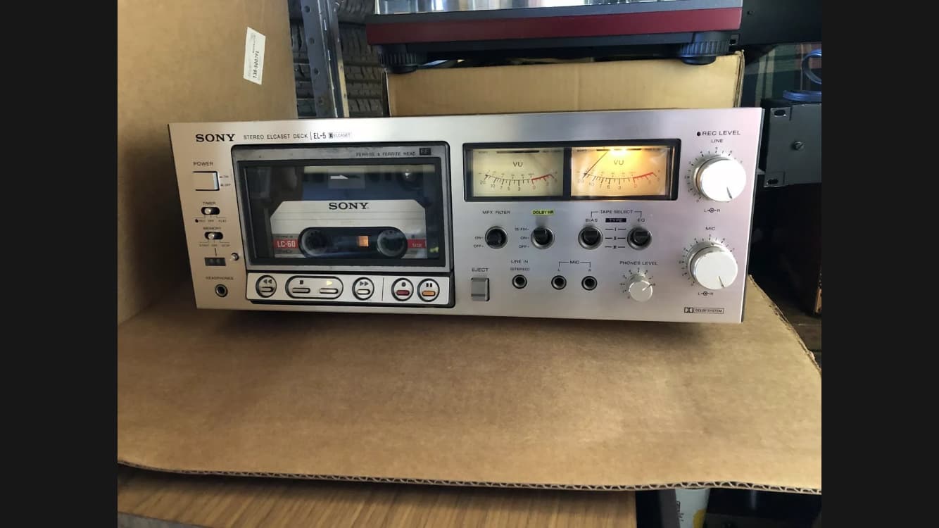

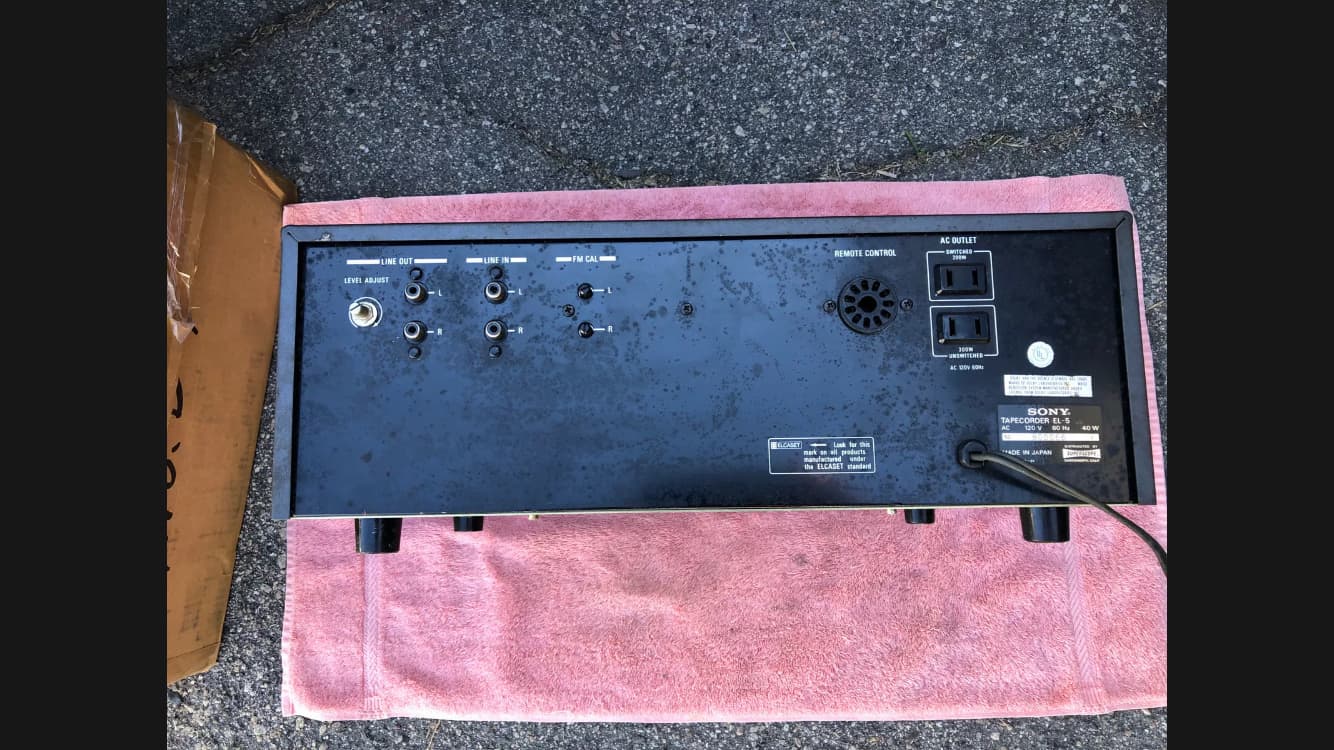

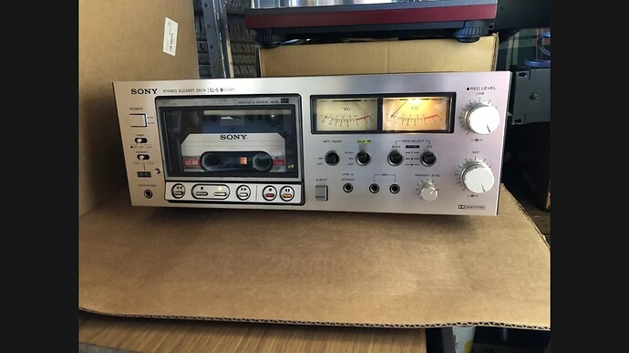

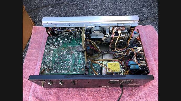

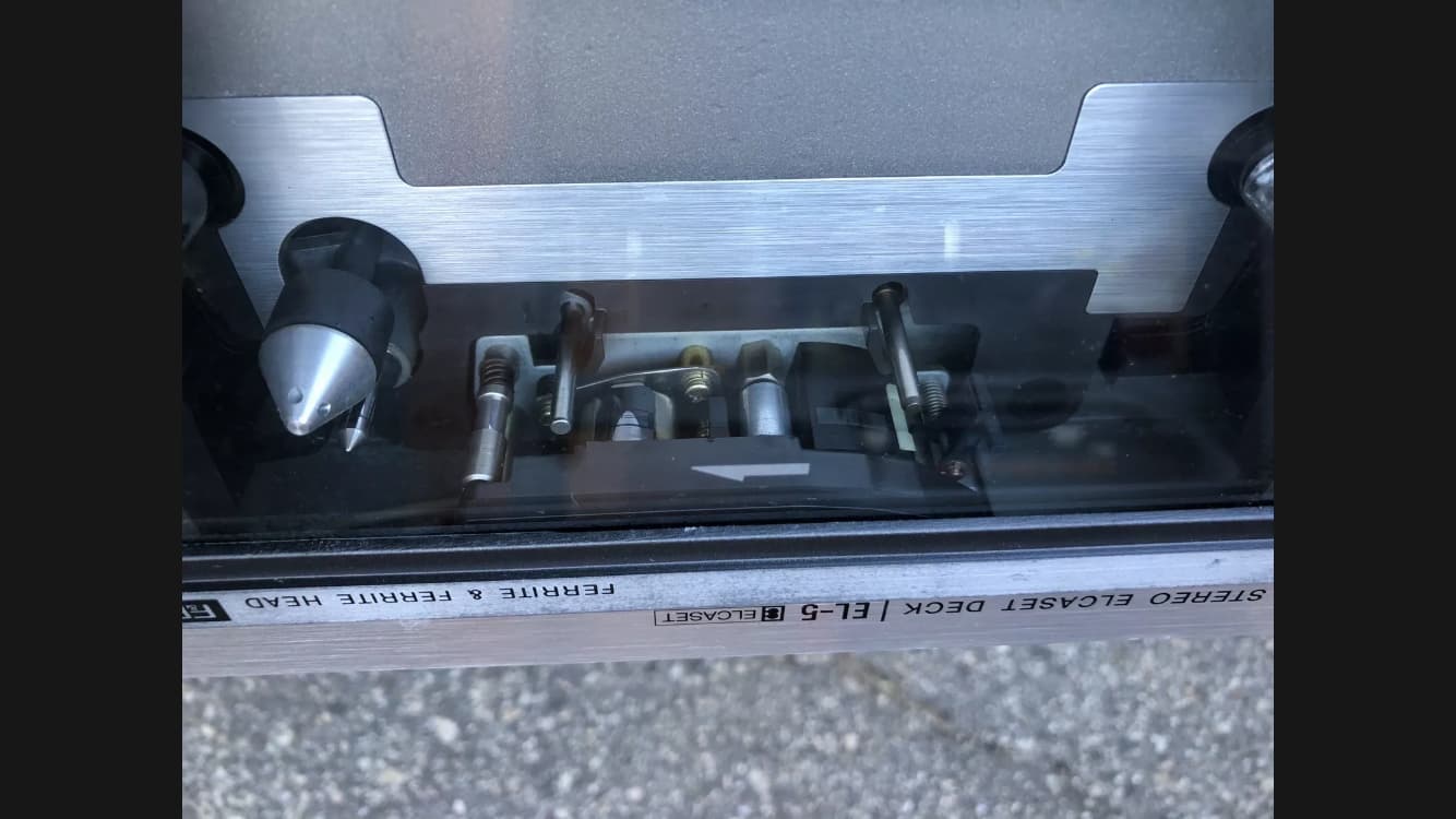

I just ordered this EL-5 Elcaset machine judging by the description, it seems to be in partially working order. I bought this one because just like how I now got a awesomely working DCC machine, I decided to go with a buying a cheap fixer upper because a restored deck goes for $1800 or more (granted they’re also the EL-7 model too) I’m going to replace the belts myself and if not have my repairman do it. I do not have any tapes for it yet and I read Ralf has some for sale?
Some photos and the description of issues this machine has.

The slow turning is almost certainly the belts – although the whole mechanism probably needs cleaning and lubricating, really. One thing about the EL-5 is that it has a single motor driving everything, so it can’t bring as much torque to the supply and takeup reels as the EL-7 (which has separate motors). This, among other things, is why it’s doubly important to make sure you do the “de-crudding” process to the tapes themselves; that dried-out lubricant will stall the EL-5’s mechanism.
The bulb is an easy fix. Some people even replace them with LEDs.
The noisy left channel is probably either a bad transistor in the left-channel amplifier circuitry, or cracked solder joints somewhere. Fortunately, I don’t think any of those transistors are particularly difficult to obtain replacements for.

No, you don’t need to bake the tapes – this isn’t the notorious “sticky shed syndrome” where the binders on the tape stock turn gummy and clog up the heads and tape path. This is a different problem entirely. :slight_smile:
See my previous reply in this thread, about a month ago. The culprit isn’t the recording tape itself, its a thin layer of lubricant which Sony applied to the tape hubs at the point where they contact the inside of the plastic cassette shell. It’s purely a mechanical issue with the way Sony assembled the cassette shell, not a tape-stock problem.
Fortunately, it’s also relatively simple to fix; it just takes a couple of small screwdrivers to open the shell, some cotton swabs and 91% isopropyl alcohol, and a little patience. (Although there is a bit of a trick to getting the shells open due to the spring-loaded covers on each side – once you’ve done it a few times, it’s easy, but the first couple of times you try it, make sure you’re working in a place where you can easily find the little spring when it pings! off in some random direction when you’re not expecting it. :grin: )

I got my deck and thankfully FedEx didn’t add extra damage!

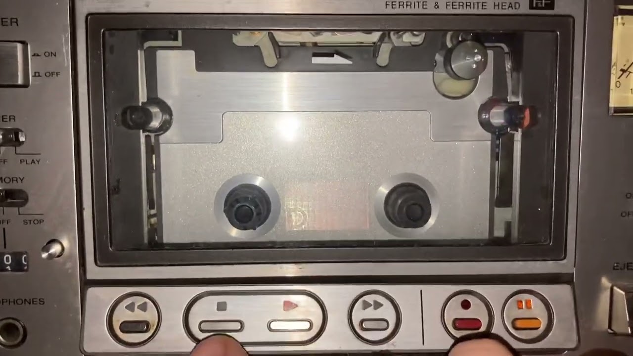

I made a video showing the EL-5 operation without a tape since the tape and extra set of new belts I ordered for it haven’t shown in the mail yet.

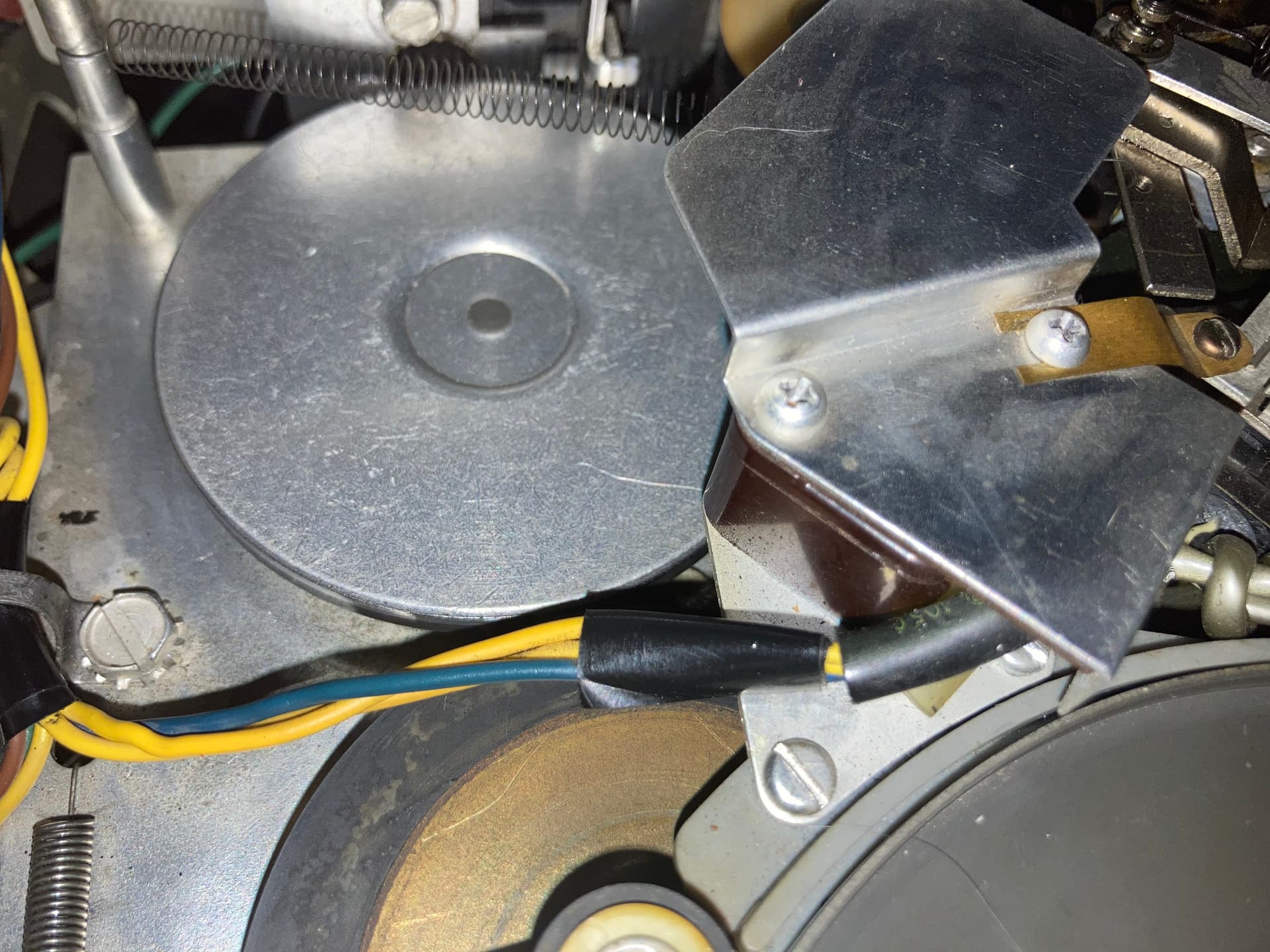

I noticed when I pressed the rewind, and FF buttons only that one hub moves. Is it supposed to do that?
The belts are clearly in need of replacement there, since I can see just from that video that the take-up hub is turning erratically even though there’s no load on it. (So don’t put your tape in it to try it out until you’ve serviced the mechanism, or it will eat it.)

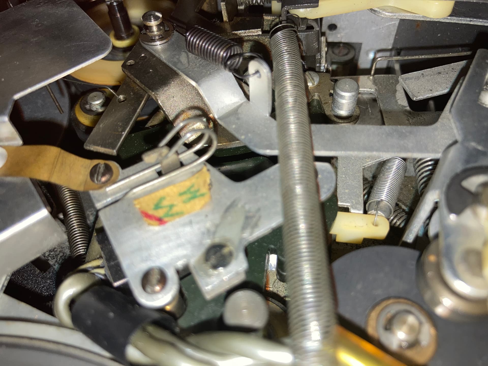

Keeping in mind that intricate mechanics isn’t my forte (which is why if my DCC130 portable ever needs repairs, I will likely send it to the Museum guys :grin: ) — given that the take-up hub continued to turn even when you put it in “pause”, that looks to me like the mechanism which determines which of the two hubs is driven by the drive wheel isn’t moving, so the take-up hub is always engaged by the drive motor.
According to the service manual, there are two solenoids which pull the drive wheel back and forth. PM2 pulls it against the takeup hub for forward modes; PM3 pulls it against the supply hub for rewind. If both are de-energized, then a spring should shift it to the center position where neither hub is engaged. So either the mechanism is stuck due to gummed/dried-up lubrication, one of those springs is missing, or the transistors which drive the solenoids aren’t switching properly. (Q734, Q735, and Q736 control PM2; Q737, Q738, and Q739 control PM3.)
