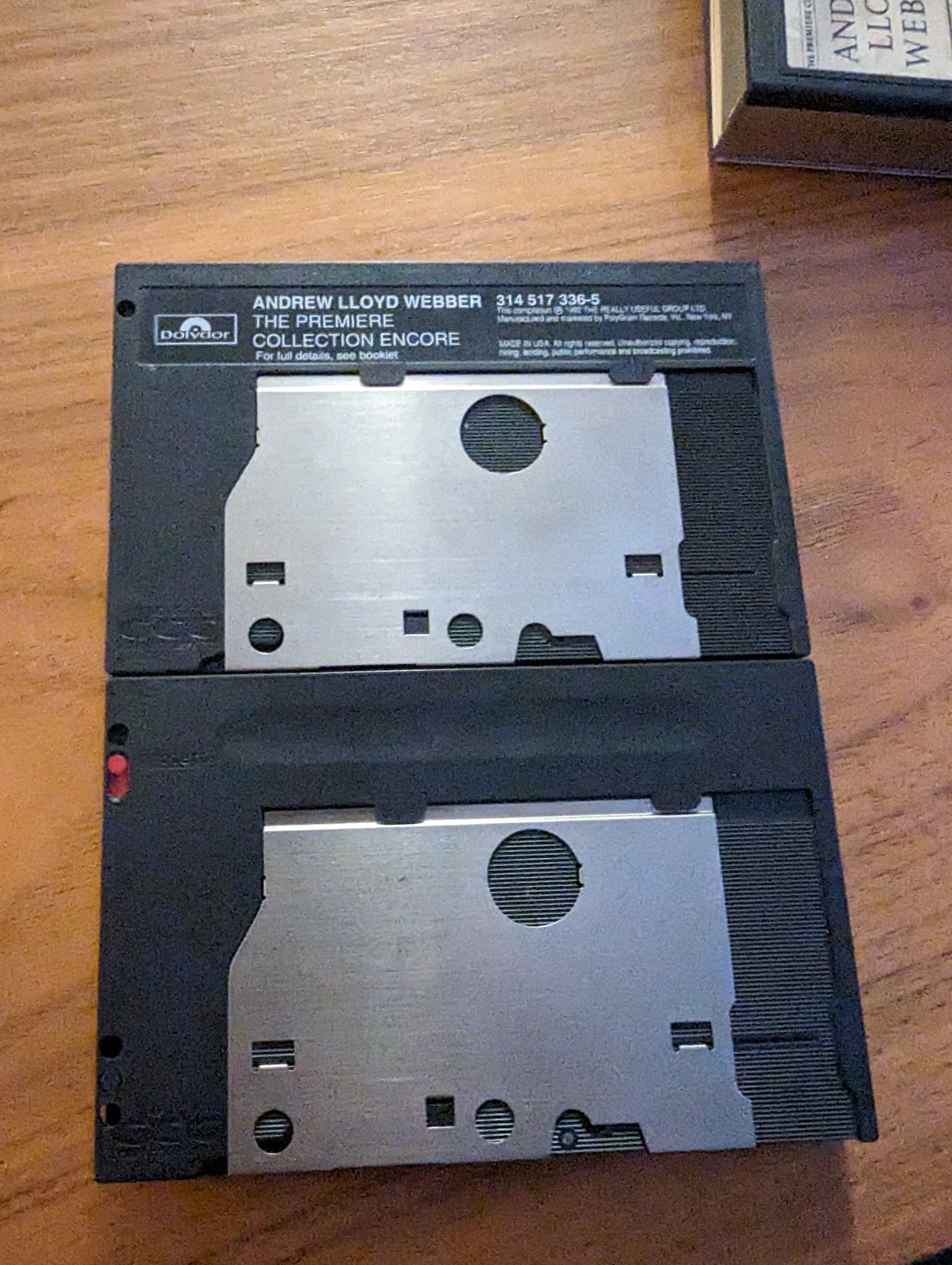

Hi, I have an issue with a DCC170. It plays own recorded tapes but it doesn’t play pre-recorded tapes. I have tried to figure out what the issue could be but I can’t tell the difference between the two tapes. Only the protect button and the holes left bottom are different. But as far I know the holes are not used for any detection. What could be the issue causing this problem? (The belt has been replaced recently)

Hello Ralf, thank you for your reply. We figured out that the cassette was not Recognized correctly. Possible cause: It could be that I didn’t press the PCB completely to the frame when I soldered the parts back together after a belt change. It must be minimum but could it cause the issue? The tapes I tested were not recorded with this DCC player. I have tested a pre-recorded tape and this played without issues. I don’t think the speed is a issue.
