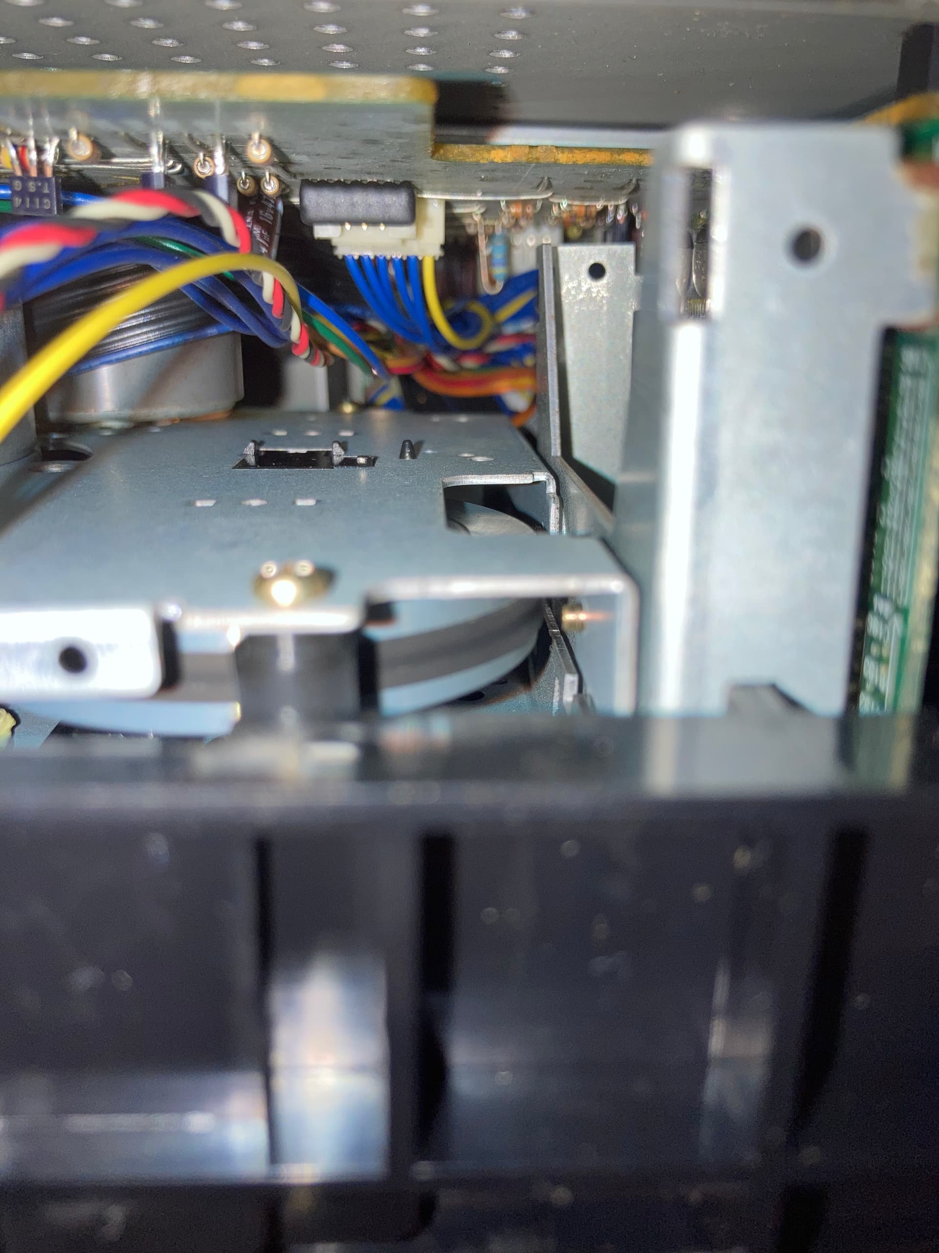

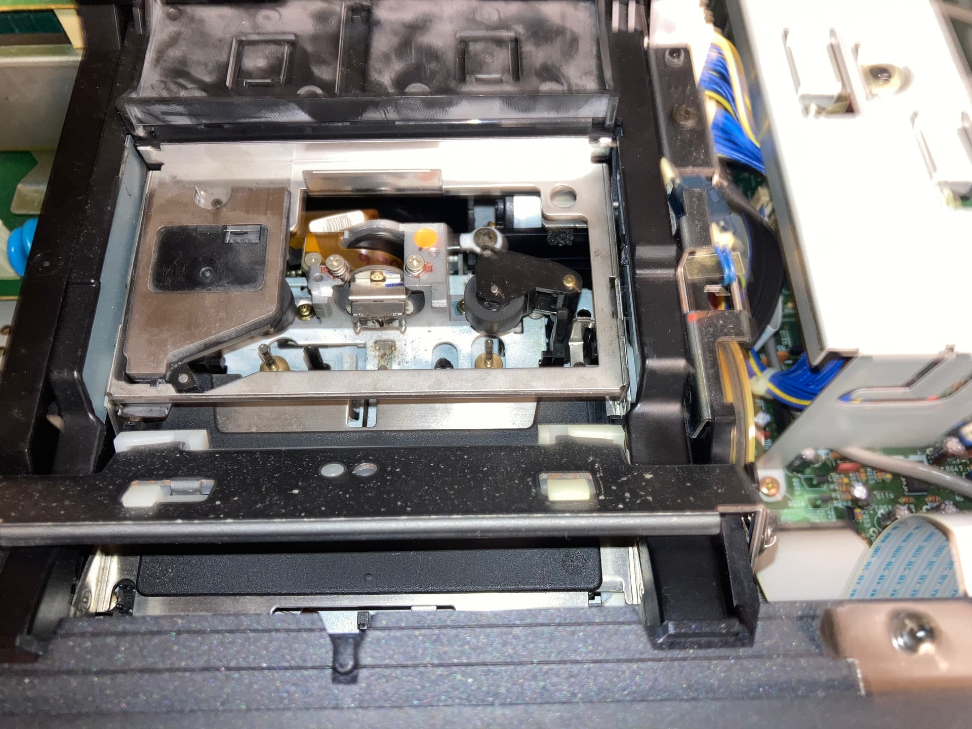

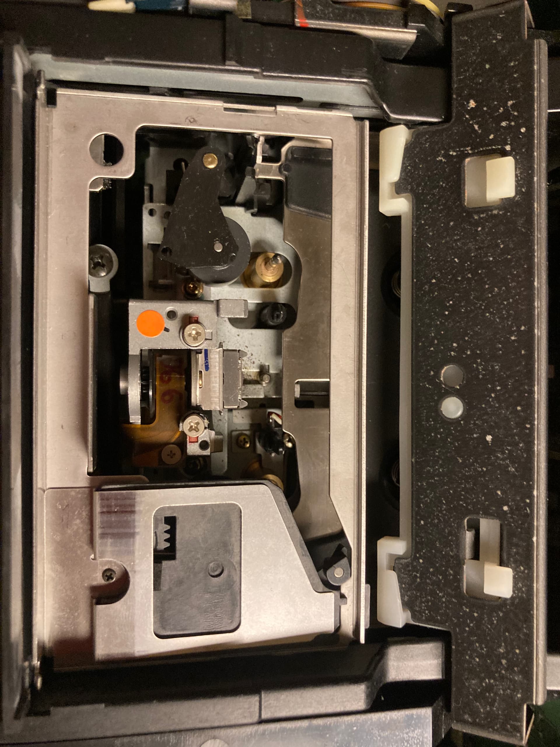

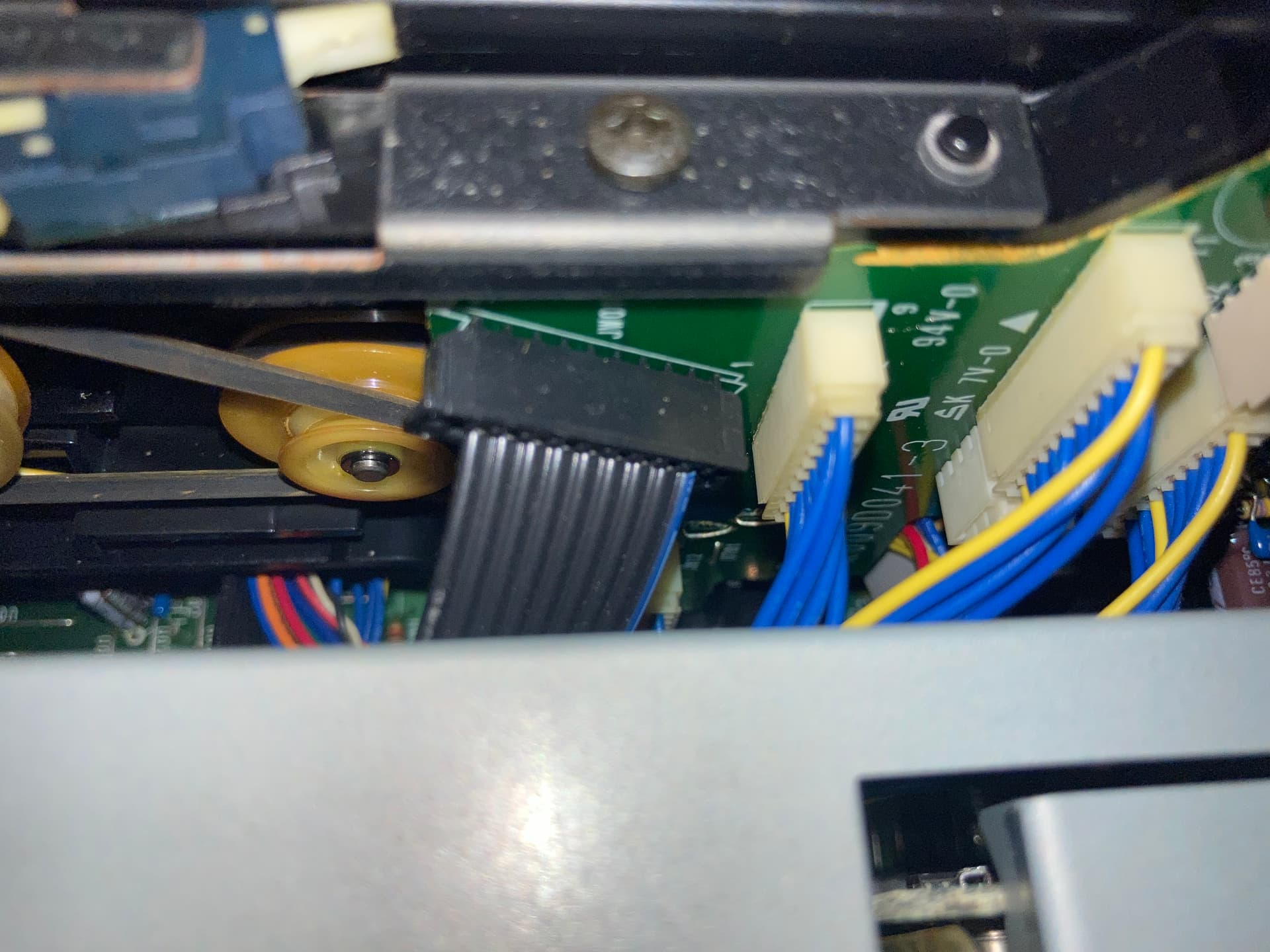

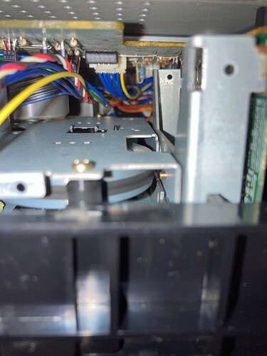

A few photos… nothing looks abnormal maybe beyond the replacement of almost 30 year old belts? Or does something look out of line?
As far as I can tell, it looks very normal.
900’s are almost always repairable.
The cassette blocked problem is probably caused by the belt, and it certainly needs new caps.
That’s what my repairman said. it could be the belts. But just to be 100% sure I made a video of the problem. Pushing The Open and close button. I just hope it wasn’t banged up coming from the seller’s location…
It is a mechanical failure. Try and move the spindles that hold the belts on the right (at the end of you video manually). If you need to apply a lot of force, stop.
If it does not move, the lift/sliding door is jammed. This is most likely caused by a drop/transport.
The mechanism needs to be removed to repair this. It needs to be removed for a recap anyway.
The drawer and or metal top bar would have to be readjusted if possible. If anything did break, we have spare parts to fix this.

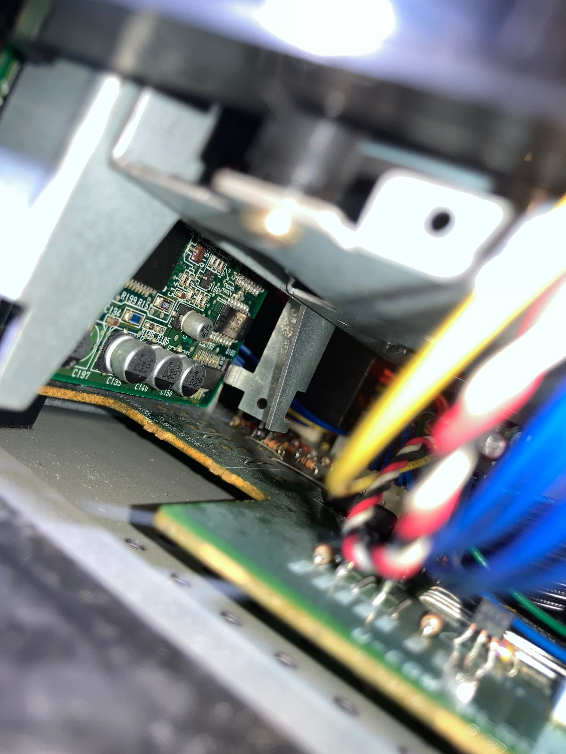

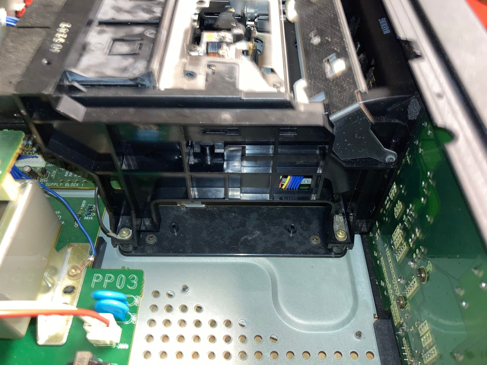

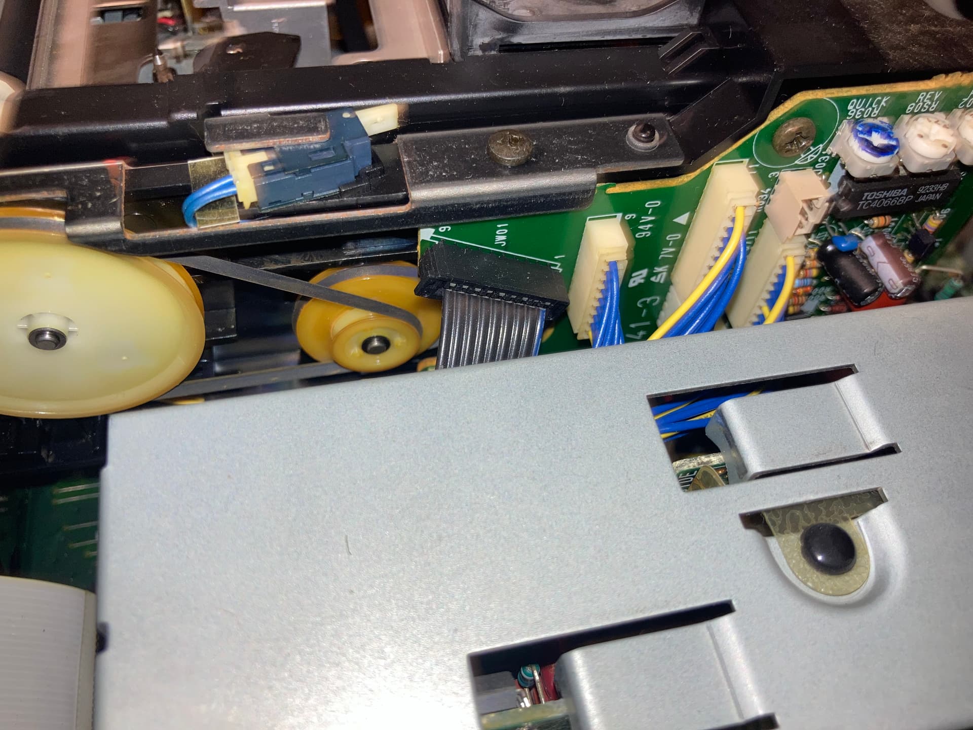

Ok I managed to get a photo from under the tray. The read write board doesn’t look like it has any damage from caps but we will have to see what the other side looks like…I also noticed the metal bar for the tray it looks kinda crooked? I think I may found out what’s wrong with the tray not coming out.
You know something speaking of capacitors and ones that are infamous for going bad? On Betamax VCR decks circa 1982 there are these blue Sanyo caps that also go bad in those. (I have a SL-5100 that has this issue) causing no picture to display when you pop in a tape.

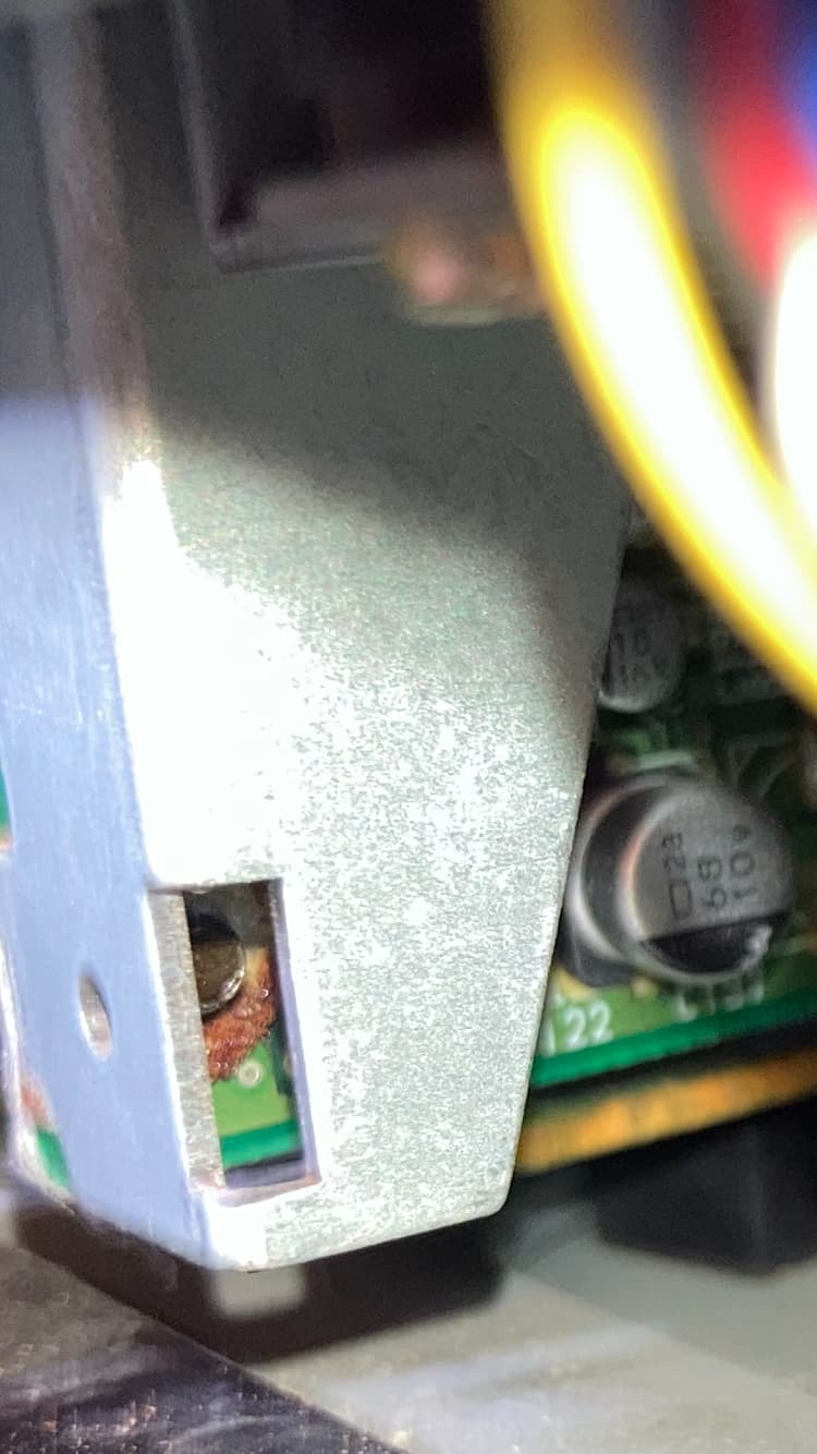

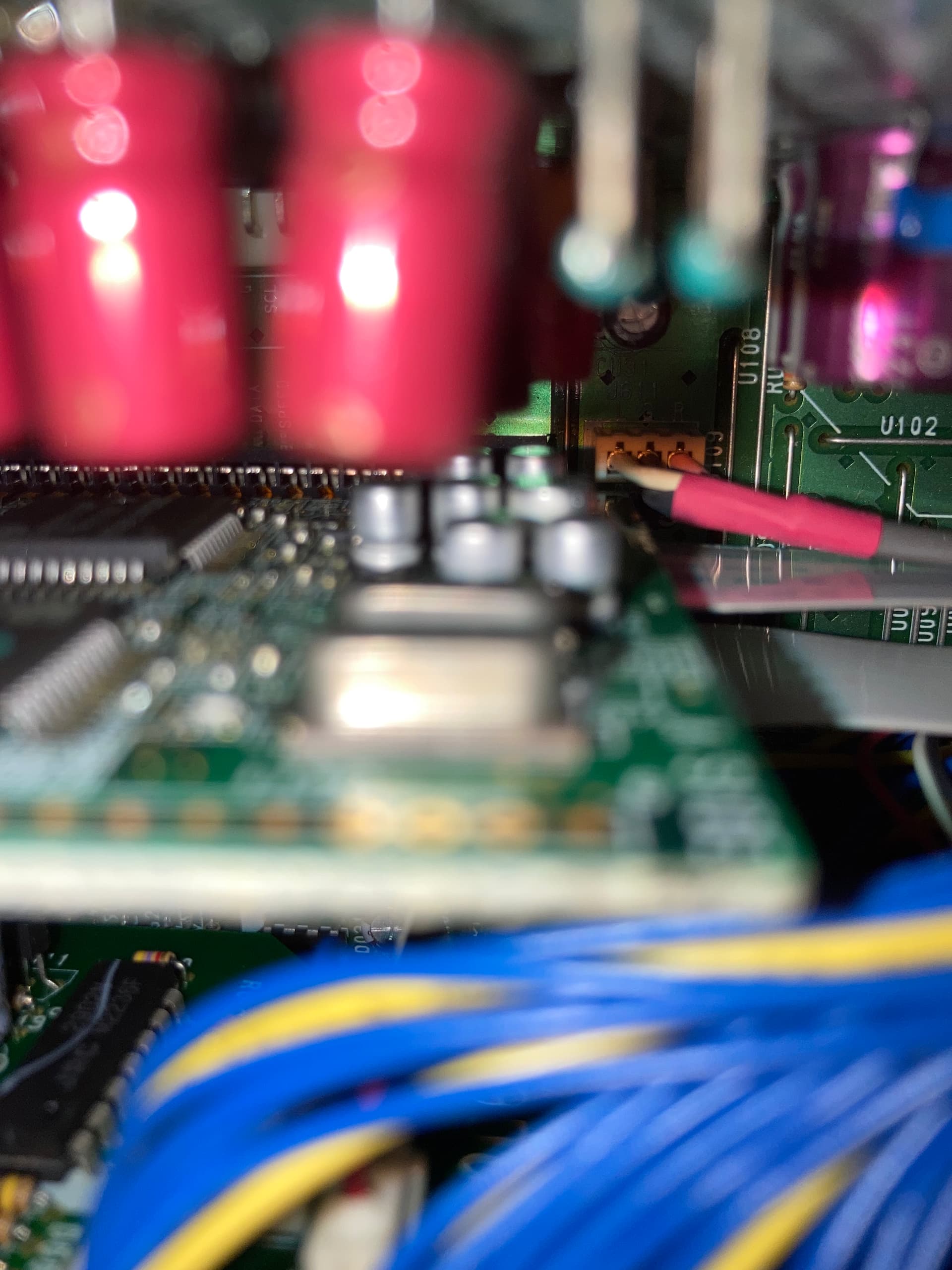

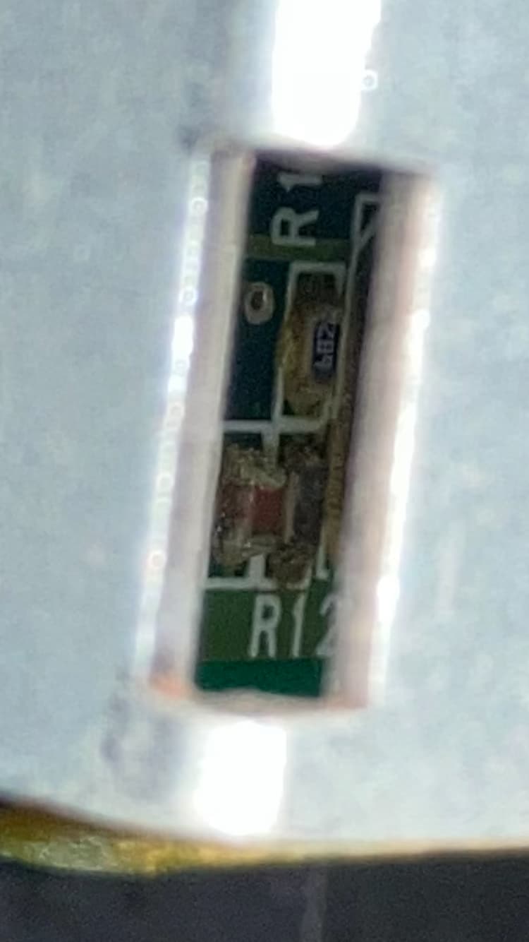

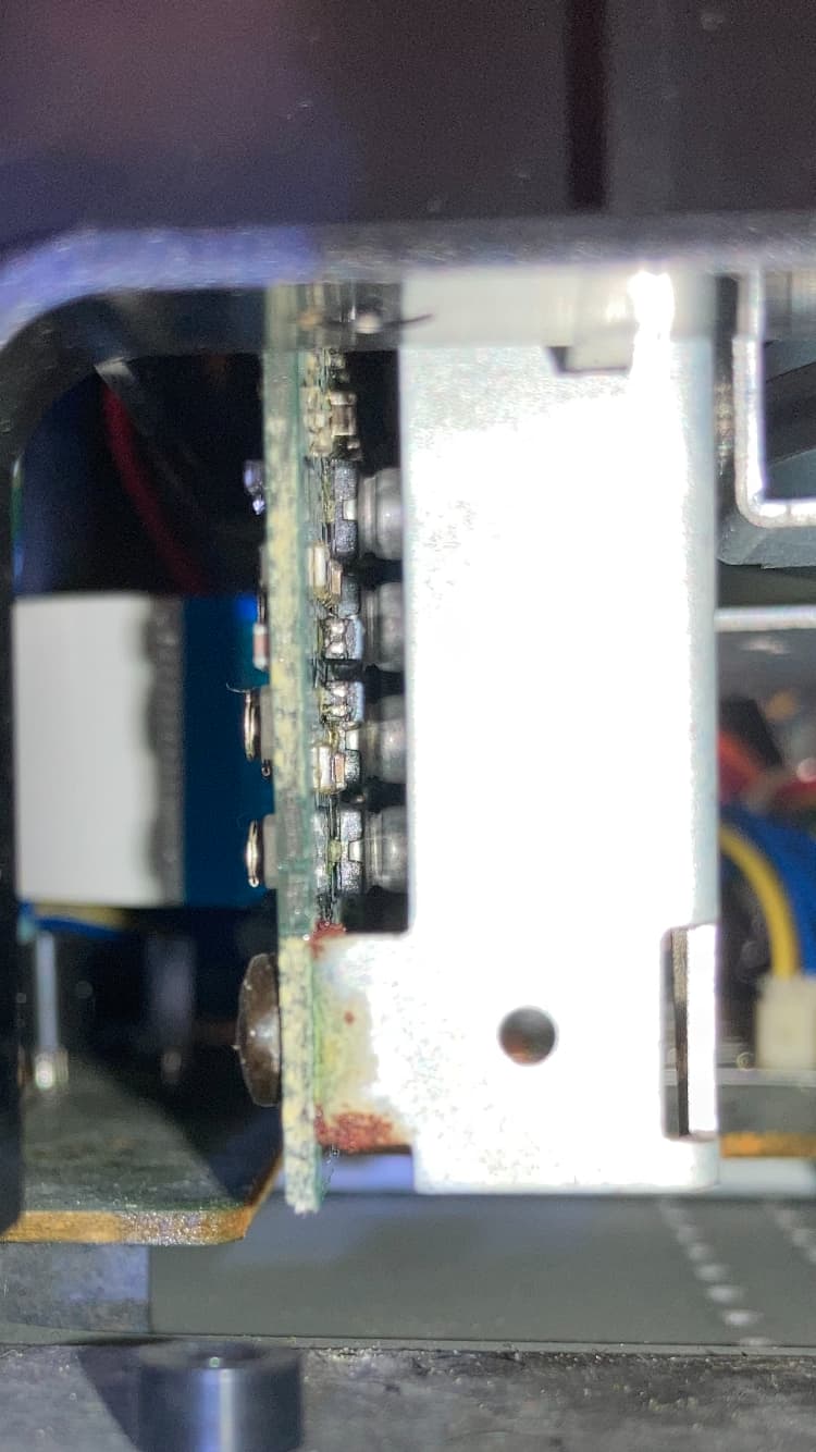

Ok I took even more pictures of what my camera could reach of the read/write board. The caps I can see don’t appear too bad, but the ones behind the metal piece has me a little concerned because around the screw there is some rust. :grimacing: I’m feeling a little concerned here about that…
Totally normal unfortunately.
The acid leaking from the caps are causing this.

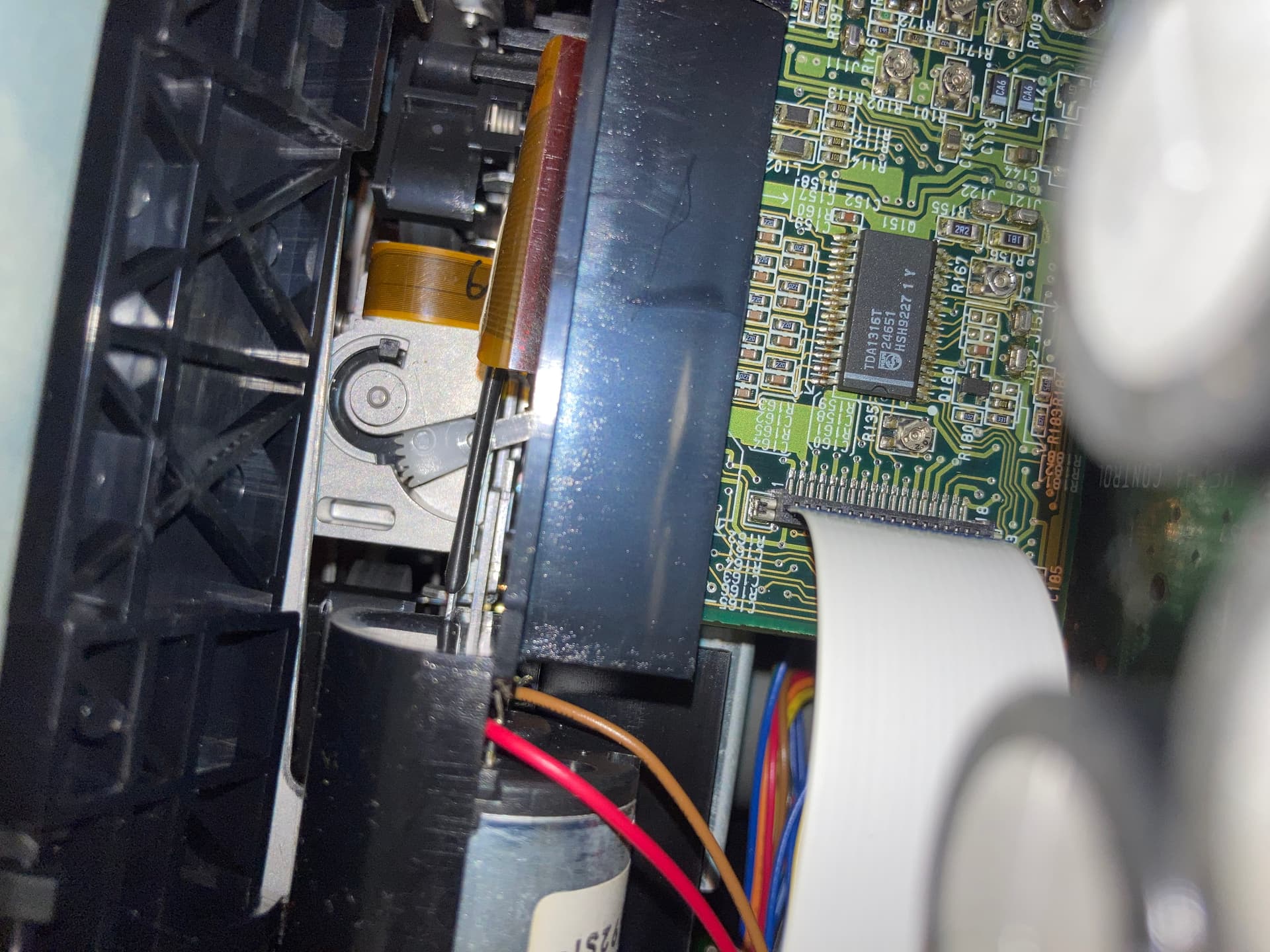

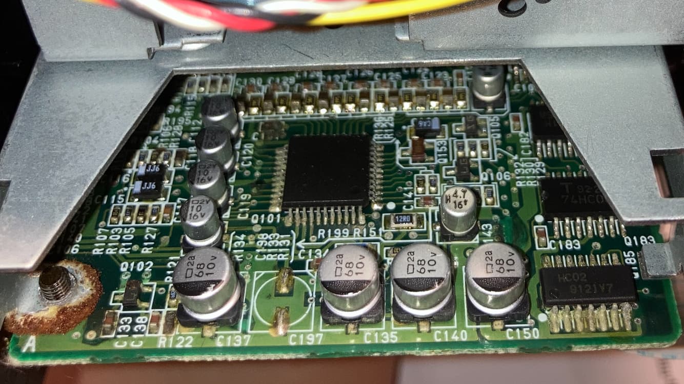

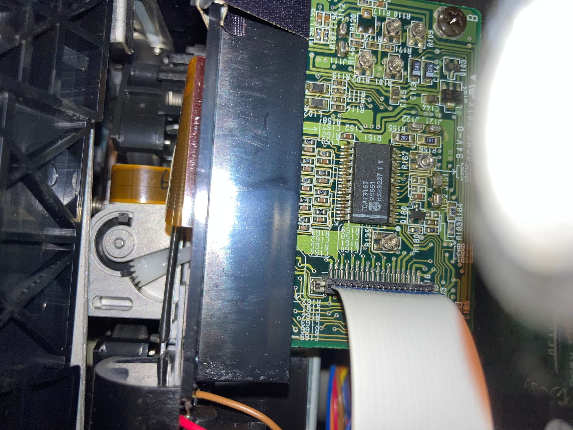

Ok update. I’ve removed the PCB and the tape mechanism and thankfully nothing got broken or damaged in the process.
Both boards appear to have minimal damage, but both are gonna get all their caps replaced anyway to work properly.
