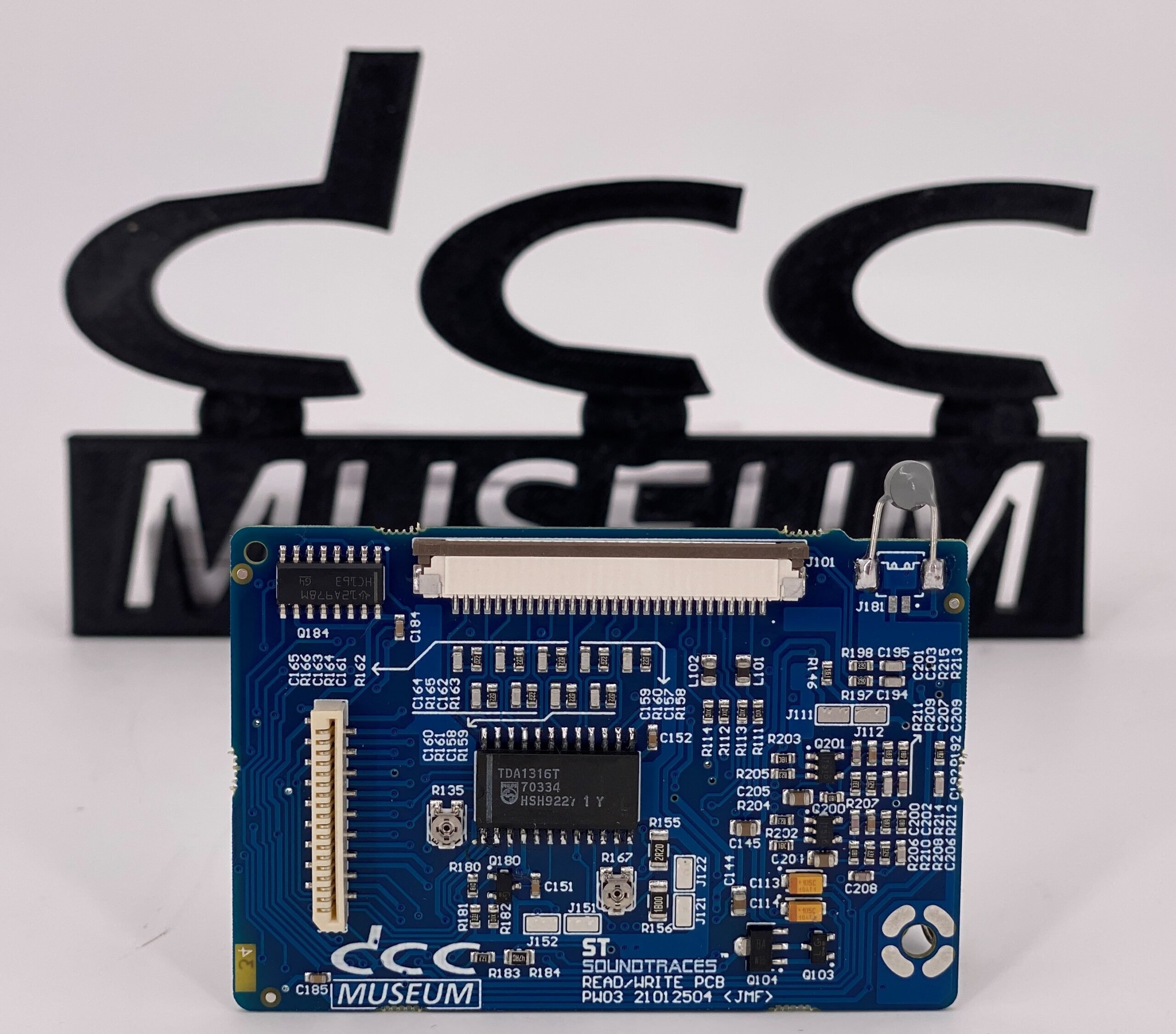

I know you guys are making new read write boards?
I had mine done in January 2022 before these were available, will this fix my issue?
Most likely yes, a replacement read/write board will probably fix the issue. The custom chips need to be removed from the old board and installed on the new board.
Contact @drdcc to get the repair done.
It could be the PZ03, but also the PW03 board.
If you can send the mechanism and both boards, we are happy to check what is wrong and go from there.
