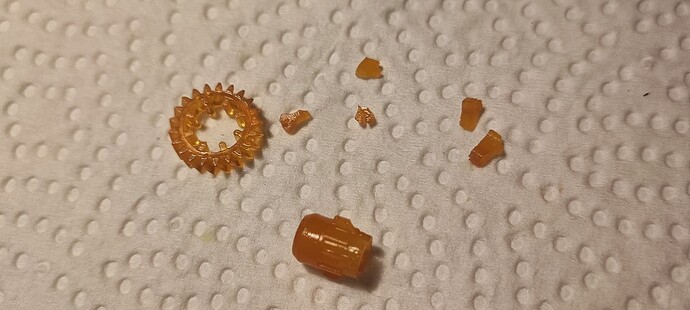

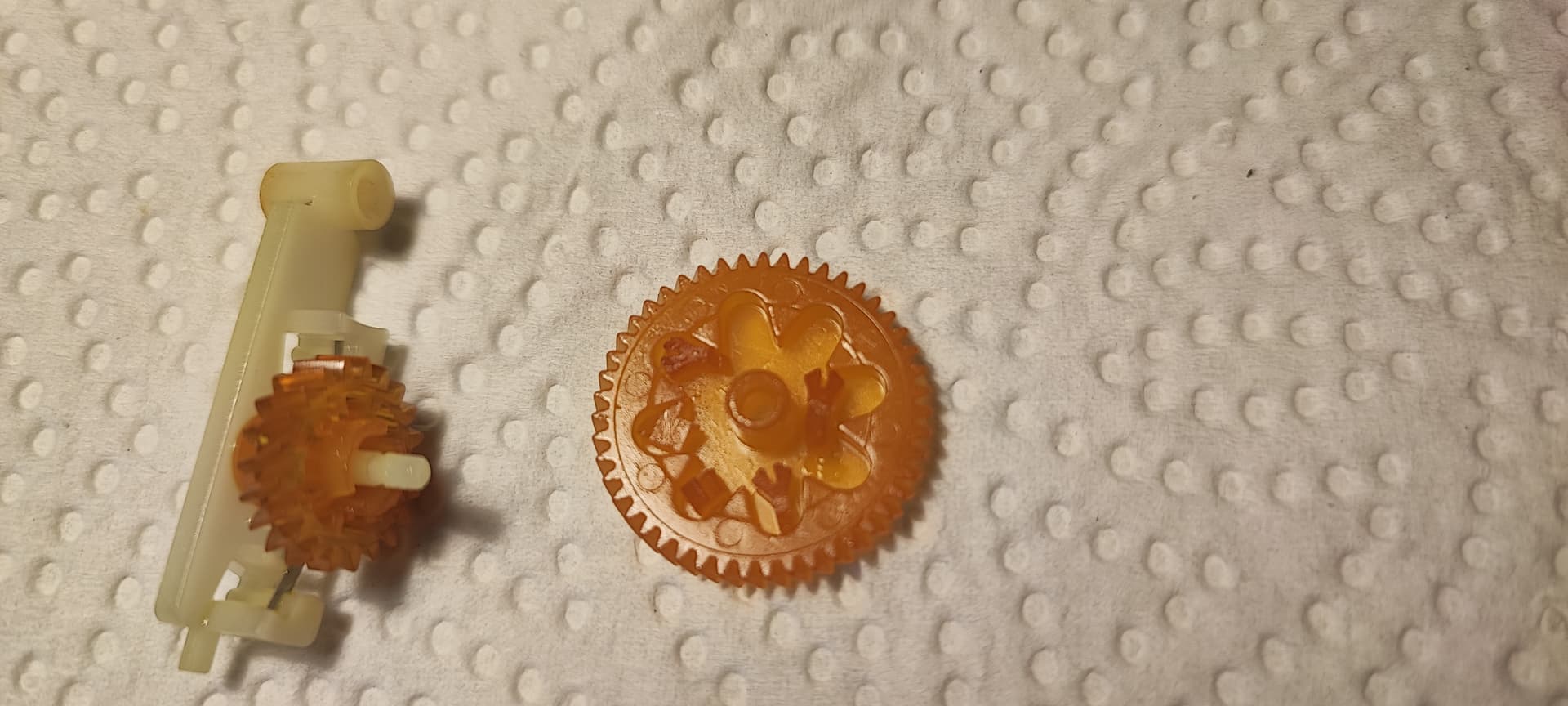

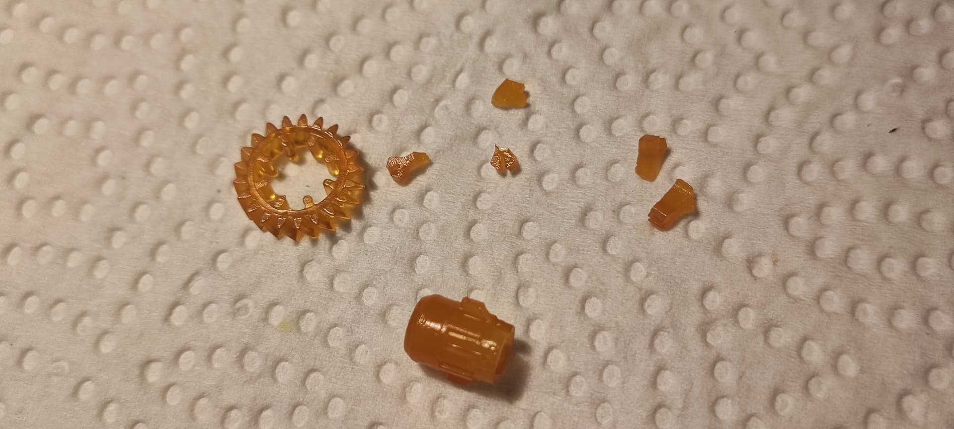

Most likely the gear.
I missed this video. I have checked everything but not the gear. :grimacing: Unfortunately i have to wait until the end of august to be shipped, because the DCC museum is closed. Maybe i can find it somewhere else in the meantime. Thanks Ralf.
Doesn’t seem to be broken to me. :relieved_face:
Always listen to @drdcc
Does somebody know where to buy the correct gear that can be delivered to the Netherlands before mid august? Unfortunately the DCC museum is closed.
