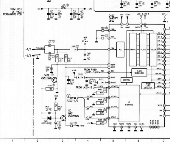

The other possible issue is that a trace or via has failed in the area of the two transistors on the Digital board above the two 10uf elco’s as seen from the connector.
Schematic for the mentioned part of the board !
Andre
